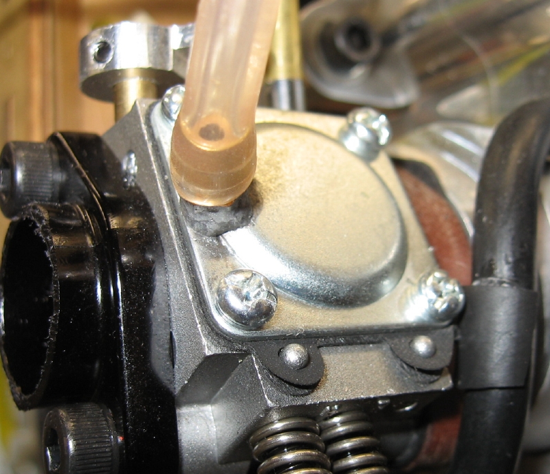

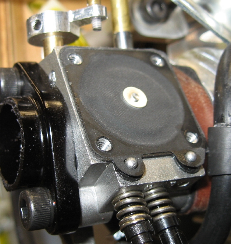

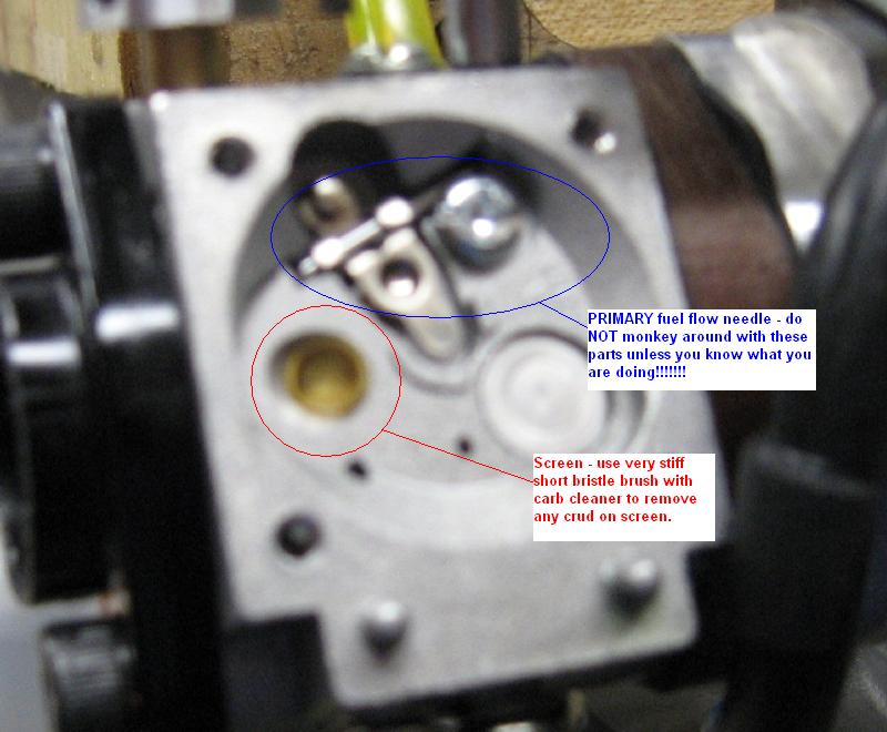

ORIGINAL: Cambo
How exactly do i get to that part Bob
In the drawing, I've drawn a redline to the screen. Remove the four screws on the diaphragm cover, GENTLY remove the diaphragm, and you will see the screen. It's very obvious once you get in there.
The pics are of my non-DL engine, but nearly exactly the same carb, just mounted differently. Hope these help!

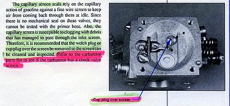

P.S. - the pic is a generic Walbro, and contains other troubleshooting hints - might be worth keeping. The pump cover, screws, diaphragm pump, etc. are the same for our carbs.

Okay, i got the cowl off and was able to get at the carb. When i took the plate of i found that the gold "screen" that bob is pointing out in the pics is about 75% black. The left side off it is so dark i can't see the gold color but the right side of it is clear enough that i can see the gold. It looks like some oily crud got on it. I can't however figure out how to clean it. If there is a screen there it must have the finest little wholes as it really doesn't look like a sreen to me. It feels hard and smooth, almost as if there was a drop of epoxy in there.
Any help would be apreciated.

Look with a magnifier and very bright light. That screen *is* very fine, and is probably causing the bad needle settings, and is effectively stopping fuel flow to the main metering needle adjacent to it. If you have acetone, try a cotton swab... repeated applications.... whatever is in there probably was stopped by the screen (good thing) and now needs to be removed (not so good thing).
If you absolutely cannot remove the crud, go to your local saw shop, get a carb rebuild kit of nearly any flavor. It will have the screen in it. Remove the old with a very sharp, pointed scribe being VERY careful to not push further down, and not damage any surfaces. Press in the new screen with a short piece of 3/16" wood dowel, clean, you're probably good to go.
If you do all that, and it still will not needle properly, new carb time. Trust me on that.
You are using at least "dual-filtering" (gas jug) and tank klunk, right?

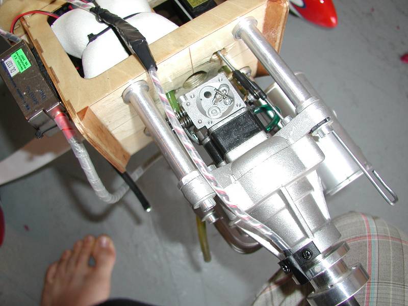

Yes, i do use 2 filters on my pump. I also noticed that when i opened this part of the carb up it was full of fuel. Is this normal. I will see what i can do.

Nice shot of carb and big toe!!! Where is the rest of the parts? There could be a little piece of crud on the tip of the metering valve. Do not loose that little spring and be carefull not to bend the arm that works the inlet valve. Good Luck Capt,n ADDED PHOTO This may or may not help.

Default RE: DL-50 engine
captainjohn - He has not disassembled the metering needle. The pic is of the "in" side of the screen. The metering parts are untouched.
Cambo - the screen is intended to capture stuff to stop it from penetrating into the carb passages.
If you can get 'er clean, you're golden.
DO NOT remove those parts I circled in red in the photos....unless you have been there, done that.

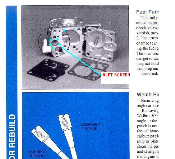

Bob the screen that you are refering to is it not on the pump side of the carb it looks like he has taken off the diaphram side. The inlet screen is on the other side right?
Normally what i do to clean the screen is to take a Q-tip and put vaslene on it and then i will swab the screen and that usually does the trick, if not its fairly easy to remove the screen and clean.

craigteffe - there are two screens (at least) that I know of. The "inlet" screen *is* on the OTHER side of the carb, and you are most certainly correct. That one would be the FIRST one to 'gunk up'.
The one that I pictured and described is the "metering" screen, and it's the "other" screen that can get crud.
cambo - after you have finished on the diaphragm side, I'd follow craigteffe's advice and do the same thing on the INLET screen.
My bad for not pointing you there first; perhaps I should have done that.
Thanks, craigteffe for pointing out the misdirection. Hope there's no harm, there.
[Edit - added pic of inlet screen from Walbro manual. This is on opposite side from diaphragm/metering screen, as craigteffe pointed out. On our carbs, a single screw through the center with a large slotted/phillips head holds the pump cover in place. The pic shows a carb with a 4 screw setup]
