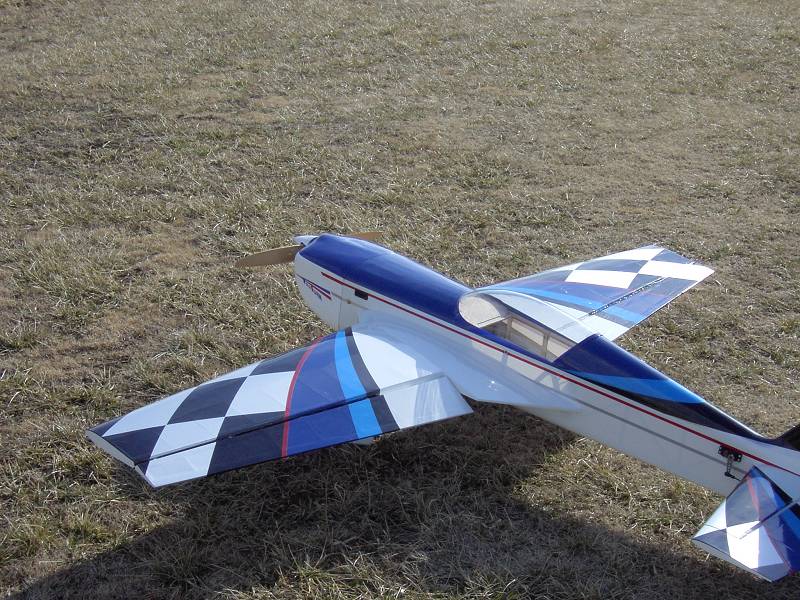

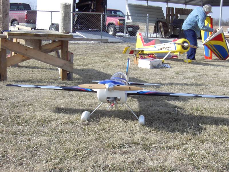

Well I finally got a chance to get my bird in the air for a maiden today, The motor was running rock solid once I got it started. It was about 56 degrees out, but I had to flip probably about 20 times before she would fire. No problems after that, fired within a couple of flips the rest of the day. Power was exceptional, takeoff was at just over 1/2 throttle and it was accelerating on the way up! Too windy to do anything but fly some laps around the field but man was I having some fun.

Hey gr8taz nitro, what is that plane? I have a Lanier 80 in. Cap 232 I am considering putting my DL in. Is your plane about the same size?

It's a 3d Hobbyshop 87" katana. It weighs in on the light side of 15lbs and power is not lacking in anyway. I wouldn't see any problems with you putting one in a 80"lanier.
Your DL should really yank that 3DHS Kat around the sky
Earle
It's a beast on power, takeoff was at 1/2 throttle and it was accelerating up into a 25mph headwind.

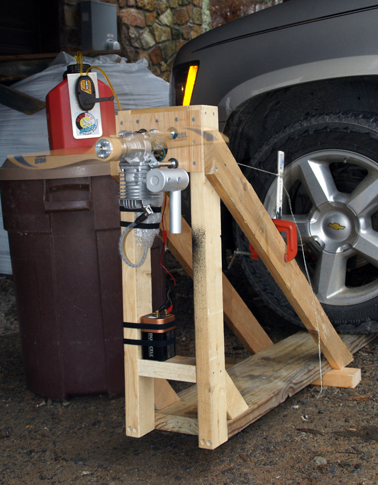

Well....not yet having my plane to put my DL in I decided to build a simple test stand and run it a bit. Powered the ignition with a 6V lantern battery and fed fuel directly from my can (2 filters BTW). About 8 flips with choke and she popped...choke off, throttle cracked and 2 flips later it purred to life. After about 20 minutes at a smooth RPM just above what I would call a shakey idle, it settled down into a nice rather smooth idle (not siure what RPM....no tach) and would cleanly accelerate to full when I popped the throttle wide open. Prop is a Vess 22B
You can see my rather crude, but effective setup in the pic. String on the throttle tied to a paint stirrer clamped to the mount. I place a 2x4 under the base and pulled my Suburban onto the end, which elevated it slightly, but more importantly let the whole affair shake a bit as it would in the plane. Worked great. After double checking bolts I ran about 1/2 gal through it this evening before sunset. Nice engine...can't wait to see/hear her fly. BTW - the stock muffler is a bit on the noisy side[:'(]. I plan to run a MTW can on this in the plane.

Very strange how the prop turned out in the picture. It is not blurred yet transparent to some extent. Looks cool.

Yea...that was interesting, DL was at an idle setting. Camera settings were F/5.6, 1/60 sec, fill flash.
