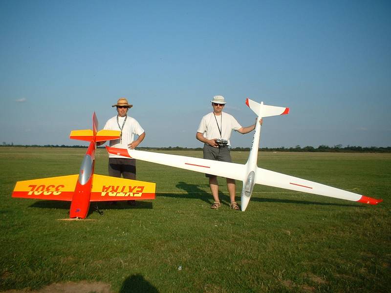

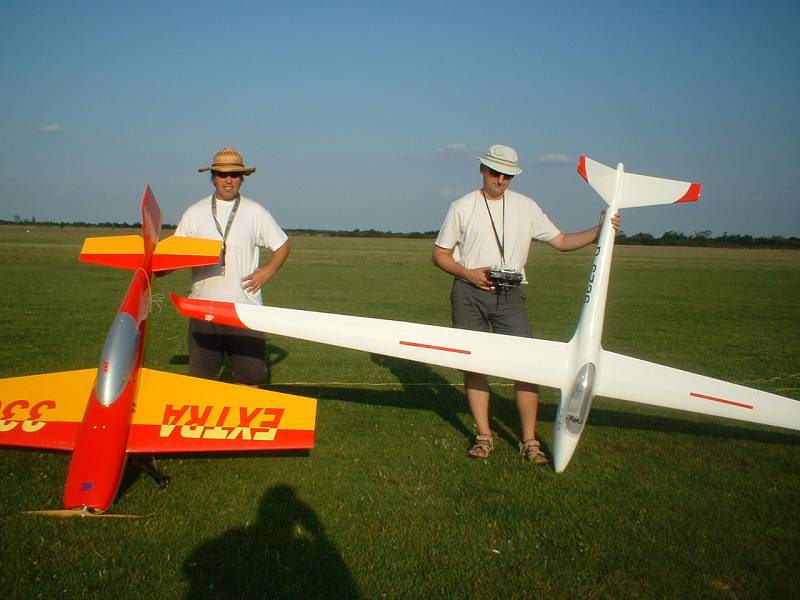

This afternoon I decided to finish the break-in process,so we went to the field for towing my buddy"s huge Salto
glider,spanning 4,5m.Well,my CARF Extra 330L armed with the Dl50 engine turned to be a real stallion.It was able to tow the big glider in a 45 degree path.
So far so good.I"m really satisfied with this engine,and hope it will be in good health for long time.

I have never been around gliders and was wondering how the tow cable works. How does it release and how is it attached? It looks like it may be part of it tied onto your extra.

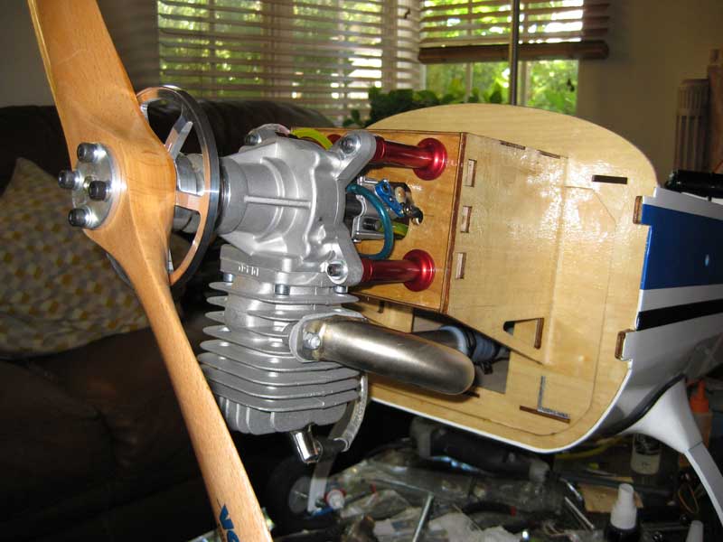

After one gallon, 7750 on a Vess 22A, 7150 Vess 23B on an MTW RE2 pipe, 89 octane 1:32 Lawnboy gas. Almost through the 3 gallons break-in fuel so I'll bolt the 23B on, tune and post some results here. Gonna use Amsoil Saber 1:80, maybe 1:100 after a couple of gallons.
