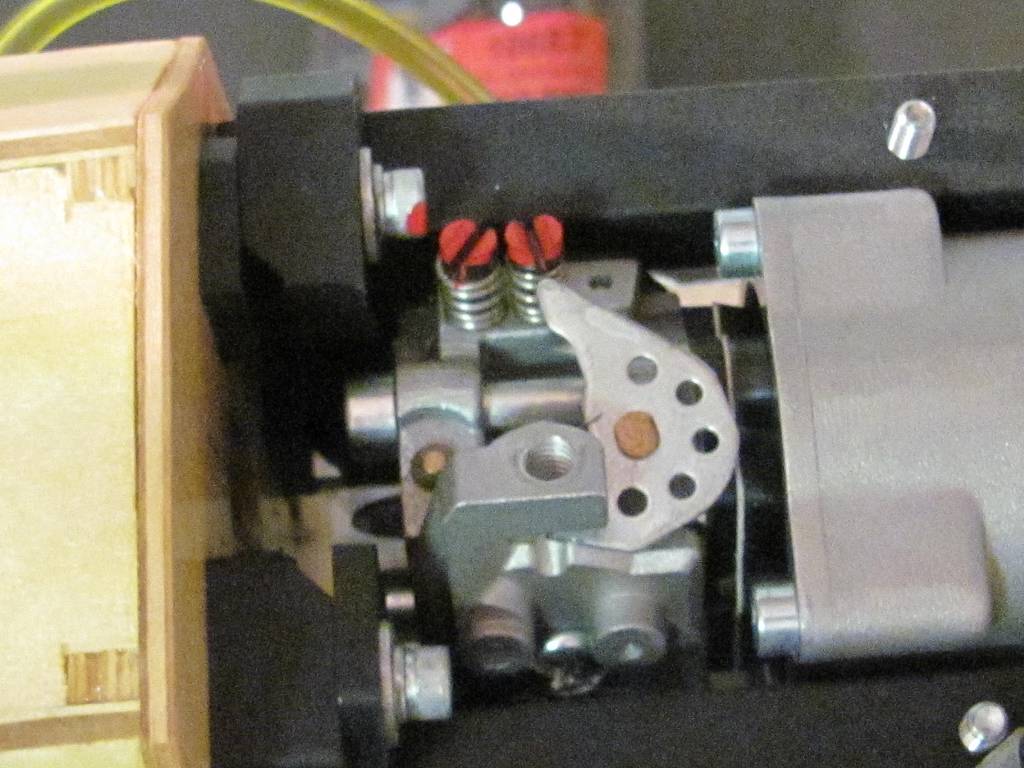

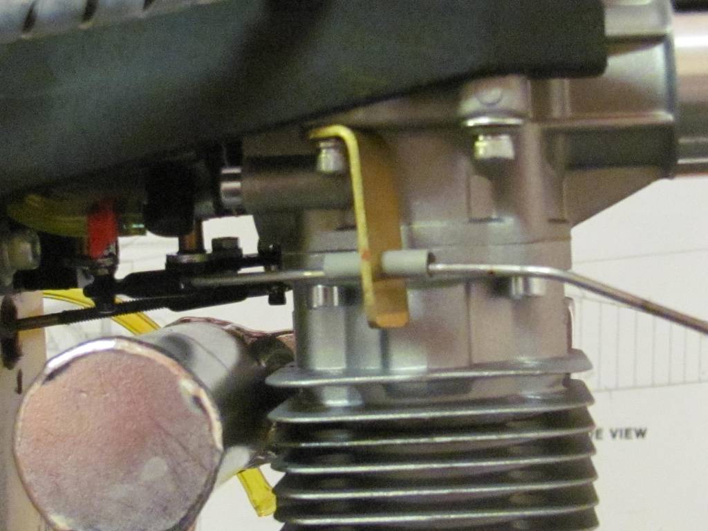

O. K here are some pictures of my DLE install on my GP Ryan. Mesaflyer you really gave me a scare what you said about forgetting to put the oil in[X(] I emptied out my can and as I got ready to measure the oil out I used a 1oz epoxy cup to measure with and I stopped an thought did I only put in 2oz in last time instead of 4? I emptied the old gas into a clear soda bottle to see what it looked like and compared it to what I just made up and they looked about the same color. Whew So I will try flying both planes tomorrow if it does not rain again and see if the gas is the problem. I've played plenty with the needles and I still may benefit from putting in some baffling to direct the air on the engine and add some kind of device to create positive air flow out the bottom.
ID:	1650514   Click image for larger version
ID:	1650515   Click image for larger version

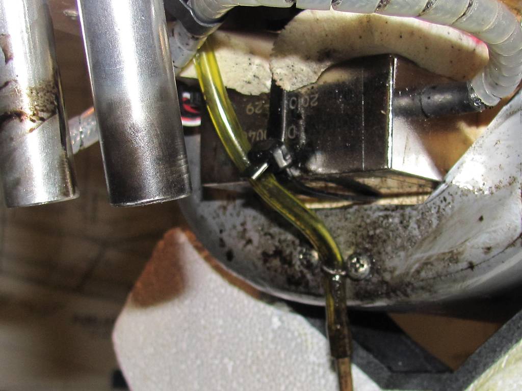

Here are some pics for Mr Wad. Let us know how it all turns out,Ive been thinking of redoing the other one I have also. Feel free to PM me if you need any more pics, this engine was made for this plane.
ID:	1650521   Click image for larger version
ID:	1650522   Click image for larger version
ID:	1650523   Click image for larger version
ID:	1650524   Click image for larger version
ID:	1650525   Click image for larger version
ID:	1650526   Click image for larger version
ID:	1650527   Click image for larger version
ID:	1650529   Click image for larger version
