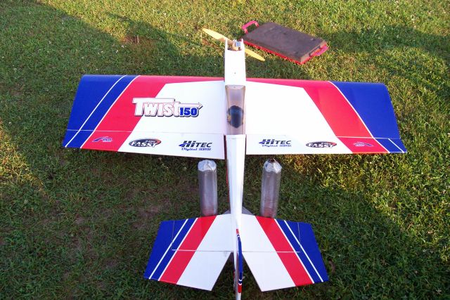

I did my H9 Twist 150/DLE20 last December.
Put my second DLE20 into an AW PROX260 Freestyle .90 size last October.
Both are waaaaay too much fun with this mighty DLE20!!!
