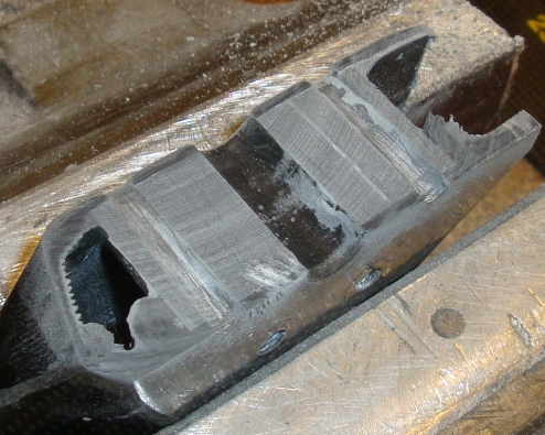

Many have read where I recommend using a torque wrench to set the torque value of propeller bolts. There are reasons for this.
Attached is a picture of a brand new propeller that ran for about 30 minutes. The hub had been drilled incorrectly, permitting a pre-load to be applid to the prop bolts when inserted becasue the holes were just fractionally tight. The bolts had been attached using an adjustable torque, battery powered, electric drill. Absolutely no accurate torque value was established prior to setting the limit stop on the drill motor. One of those "feels about right" situations. Same as what is often used by modelers and a hand held hex key. The end result is frightening, especially if you were the one on the business end of the propeller.
In this case, just about everything was done wrong. Something I fear may be much too common an occurance in the RC world. There will be a lot of comments from people about how this or worse could never happen to them because they have been doing RC for many years, have a calibrated wrist or elbow, or some other point of denial. This propeller was installed by an individual that is highly experienced and knew better, but in the interest of saving time and effort....

What actually caused the failure? Never mind I see they were over torqued.
I assumed the bolts did not clamp the prop fully leading to the torque load being transferred not through the hub, but through the bolts themselves. Fairly quickly this would destroy the laminate and result in the failure we see.
How exactly does over tightening cause the prop hub to fail like that?

Torque resistance of thepropis a requirement in an engine. If the soft center does not allow enough clamping force to achive the required torque resistance, that prop is not suited for the engine. Relaxing tightening torques is not the way to do it and will lead to desaster. Larger prop washers will increase clamping surface, and then 'maybe' will allow the required bolt tightening torque.
I would rather stay away from that brand prop.

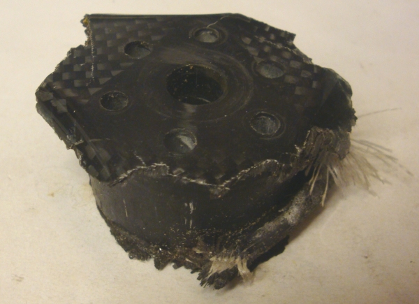

This is a picture of the prop heart off an engine that was buried a foot deep in hard loam soil. The sides of the drilled holes show no sign of even touching the bolt threads.

Pe, that photo tells the whole story. I was not familiar with how these props were manufactured. I've not seen a cross section of the hub of one of these props. There is very little material around the hub and, obvious now, it's not solid to the outside surface of the hub. Crushing the hub has serious consequences. The smaller carbon props that I'm familiar with are solid throughout.
While I'm not into engine in this size range I might one day try. Seeing the inside of the prop has made it very apparent that the clamping force is critical. I hope that if I try a carbon prop the manufacturer supplies appropriate torque specs and also takes into account different bolt sizes and how this translates to clamping force.

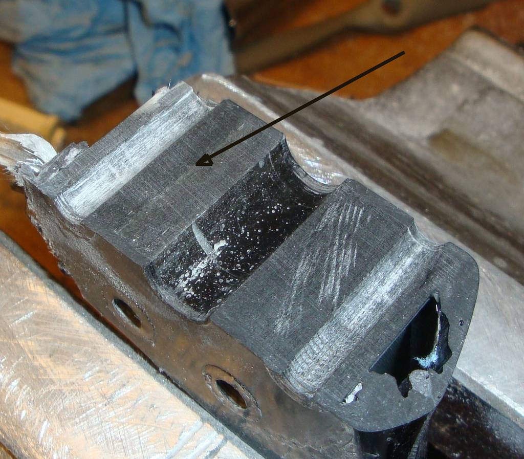

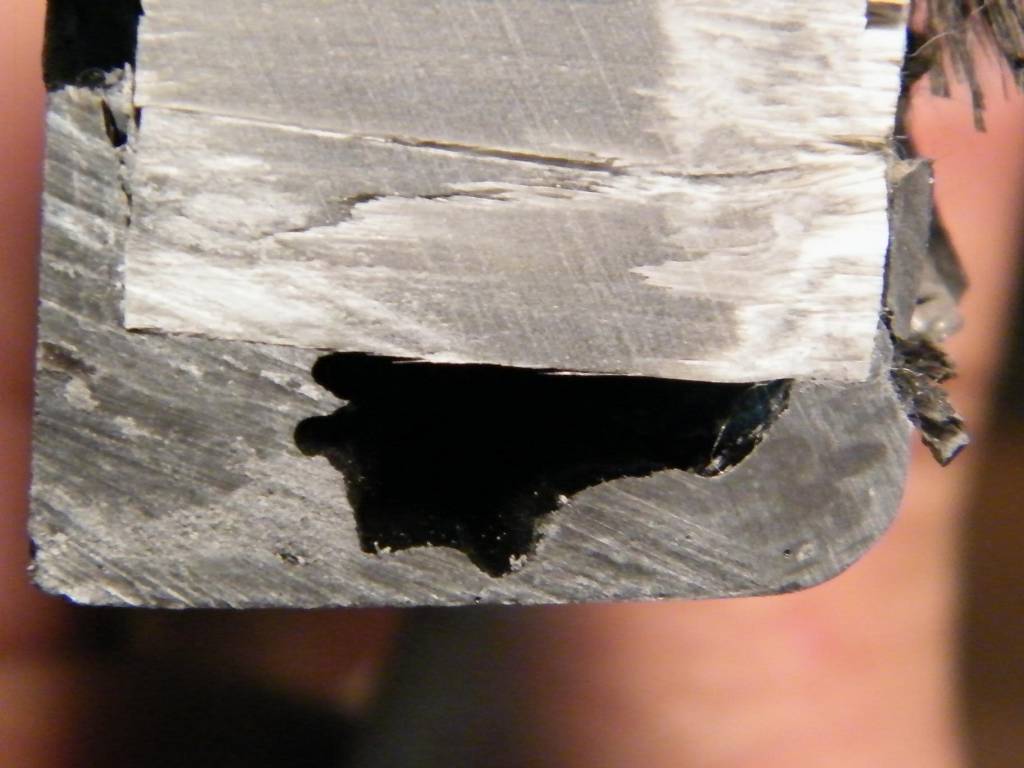

Since I was in a destructive mood today, and the fact another propeller was tossed with a different failure mode, I got to hacking up some propellers.
The prop you depicted is the same make as two that failed. The difference between yours and one of the ones that failed is ...nothing. Pics of a stock prop core are attached.
Over the counter production propeller with a fiberglass core. It just looks like carbon under casual inspection. The lay up has no "tow" to limit compression. The core strength is determined by the resin content. A 'dry' lay up (does happen) and core compression resistance is severely compromised. That was one of the failure factors in the prop in my first post. I'm starting to like the wood core composite props better. Just don't hunker down on the screws.

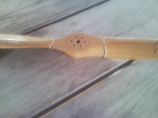

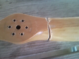

Here's a wood prop that came loose from a friend's plane this week. All 6 prop bolts sheared off; I think he failed to torque them down often enough. The spinner and center bolt remained intact and this allowed the spinner to chew into the prop. The spinner cut about 1/3 of the way through each blade before he got it shut down. This damage happened in about 30 seconds. The engine continued to run after the bolts sheared off.

The ones I have used so far all had sound hubs, with a hub core of polyester, filled with glass fibres and talcum powder. This gives the prop hub an excellent compression resistance, even when hot.
A dry lay-up that results in any form of delamination should be cause for warranty. This particular manufacturer has the hubs marked, so they can trace any error to the guy who made the prop.
I do not like wood cores so much. Wood compression strength is a variable that can hardly be controlled, unless it is resin impregnated under vacuum, or laminated using very thin hardwood plies. If inferior wood is used in the core of a carbon prop, failure can't be seen like in standard wood props, and a dry lay-up willcause delams as well.
I felt destructive too, so anoher two crash damage props was inspected. Clearly visible are the sound evenlayup, and the extra ring in the core, where the bolt holes are positioned. This particular 3-blade prop had the drilling done very tight (3D milling 4.9mm, M5 bolts). I normally drill 0.5mm oversize. In this case, all 6 bolts max torqued to M5 8.8 quality, at 10Nm. I normally use only 5 - 6 Nm on M5 prop bolts. With wood 3Nm, which already causes some crushing.
