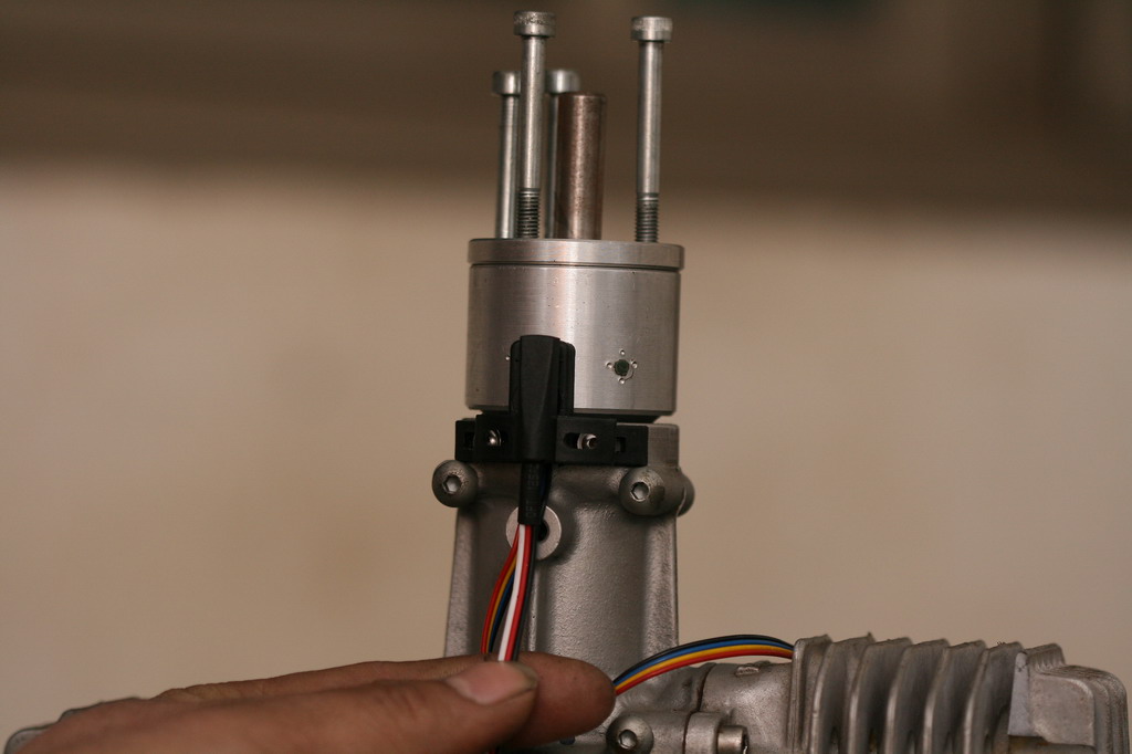

Did something today just for kicks
Got a little bored today so thought I would have some fun.
I have a lot of JC engines crank cases that I can not get cranks, piston and cylinders for but have a lot of parts for DLE.
So I took a crank piston and cylinder and installed it in one of the JC crank cases, All I had to do was shorten the crank bearing spacer about 1/2mm, move the sensor and drill out the cylinders for 5mm bolts and all went together good, Even the squash came out good and has good compression.
Kind of looks funny because the crank case is a little wider than the base of the cylinder.
Got to late for me to run it today but will give it a try in the next couple day&rsquo;s and see how it does.

From <u><font color="#00265e" size="2">BadAzzMaxx</font></u> The DLE style crank rods are 2mm longer than the JC rod but the length of the DLE style cylinder is 2mm longer from the base to the squash point of the cylinder so it all worked out good.
From outside to outside case bearings, The JC is 1mm shorter so I had to take 1mm off the bearing spacer that goes on the crank between the case bearings, I think I posted 1/2mm but it was 1mm
Got the squash down to 1mm, Would have liked for it to have been about a 1/2mm but will see what kind of power I get out of it.
Just trying to find something to do with these JC engine crank cases I can not get parts for. LOL

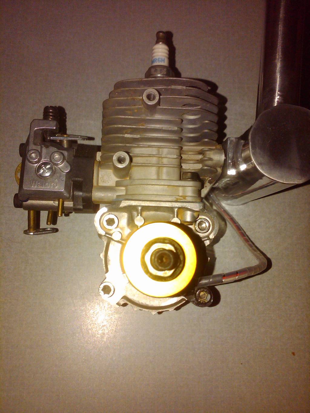

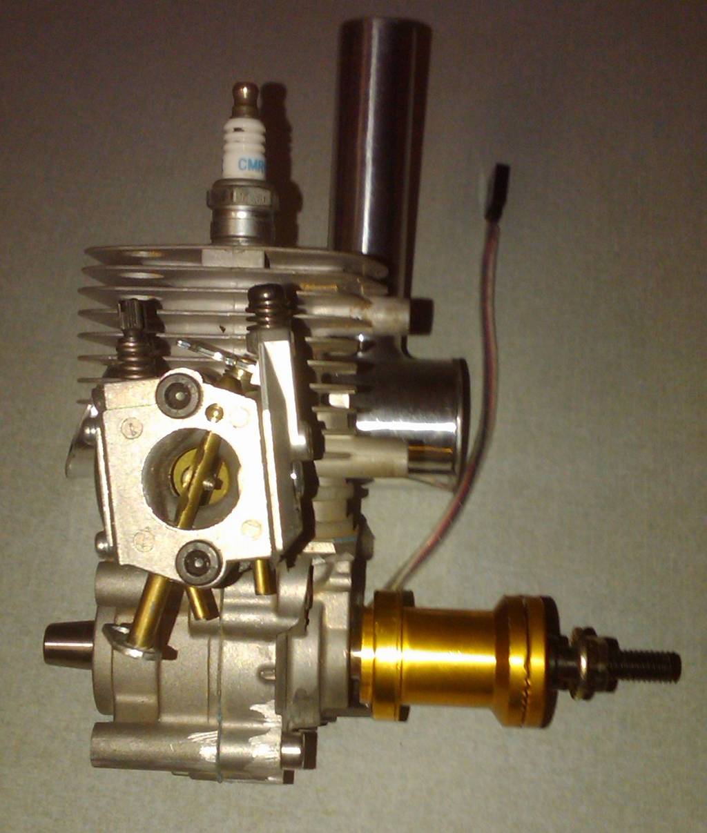

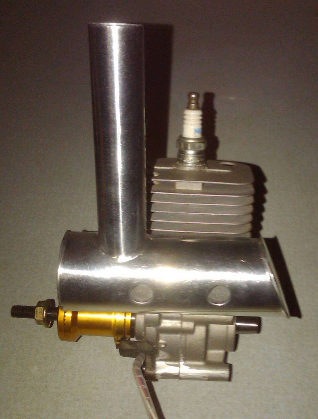

Anybody know what this engine was converted from, most parts to convert is was off shelve parts.
Only thing I had to make for it was the hall sensor bracket.
ID:	1499802   Click image for larger version
ID:	1499803   Click image for larger version
Old 09-13-2010 | 10:15 AM
Joined: Dec 2005
Posts: 1,369
From: Auburn, GA
Default RE: Gas engine parts interchange data
Answer
http://www.davesmotors.com/s.nl/c.88...t.A/id.4415/.f
At one time they would sell you the short block but do not know if they still will do it.
Prop hub, prop shaft nut and carb adapter from a CRRC works on it.
