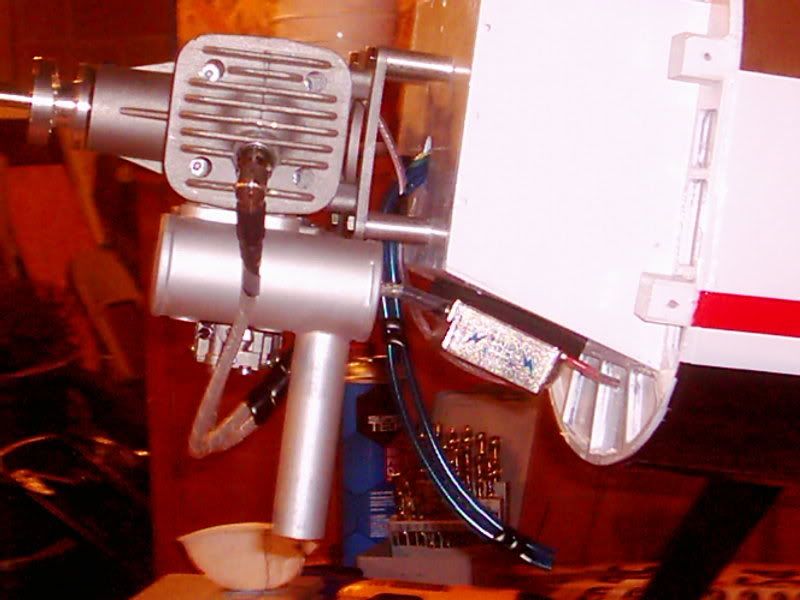

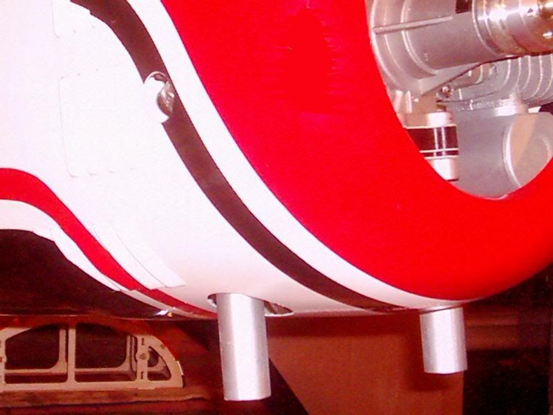

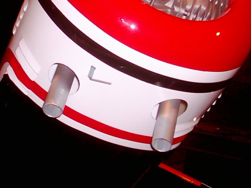

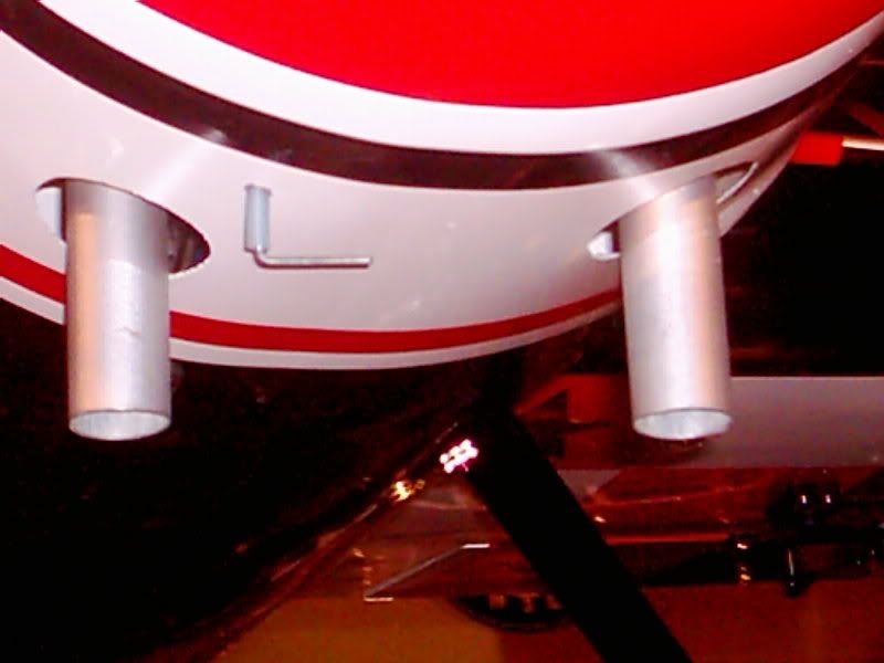

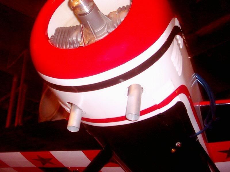

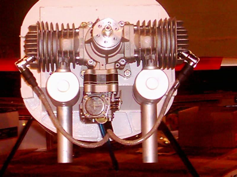

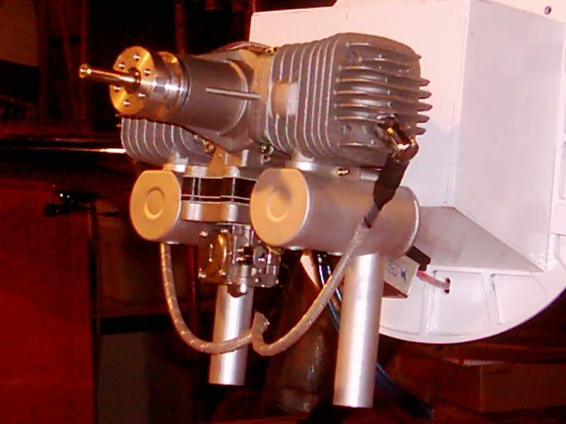

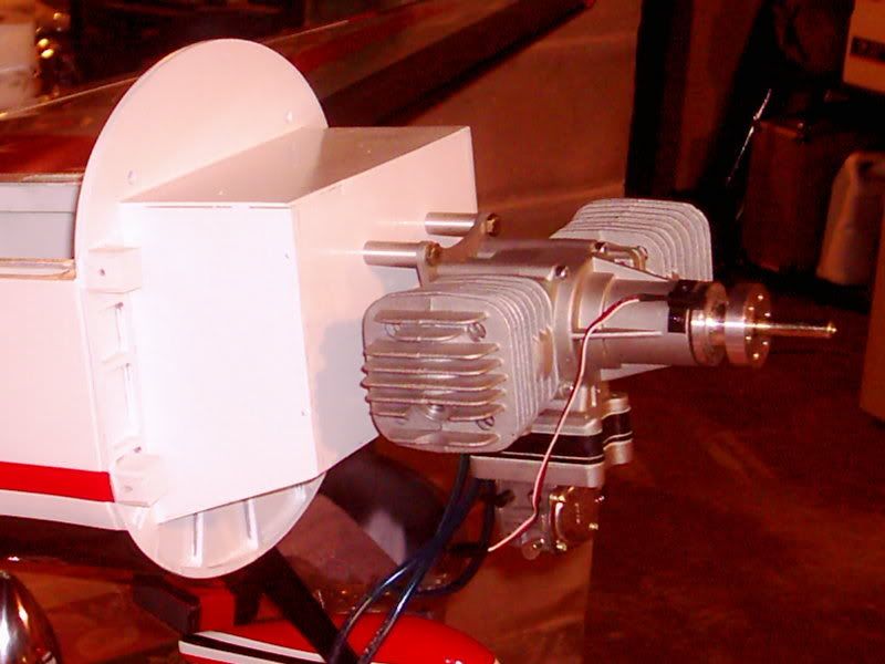

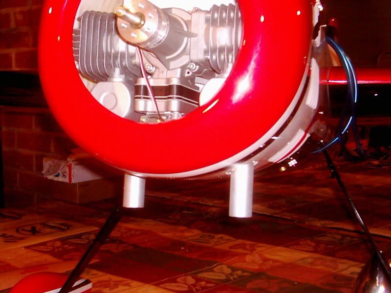

OK guys,
Here is the mounting of my engine.
I am working on it as I write this, but I wanted to give you guys a taste of what I am doing.
DL-100, rough cut holes for mufflers.
I mounted the prop washer 1" in front of the cowl for maximum prop efficiency.
I will post more a little later.

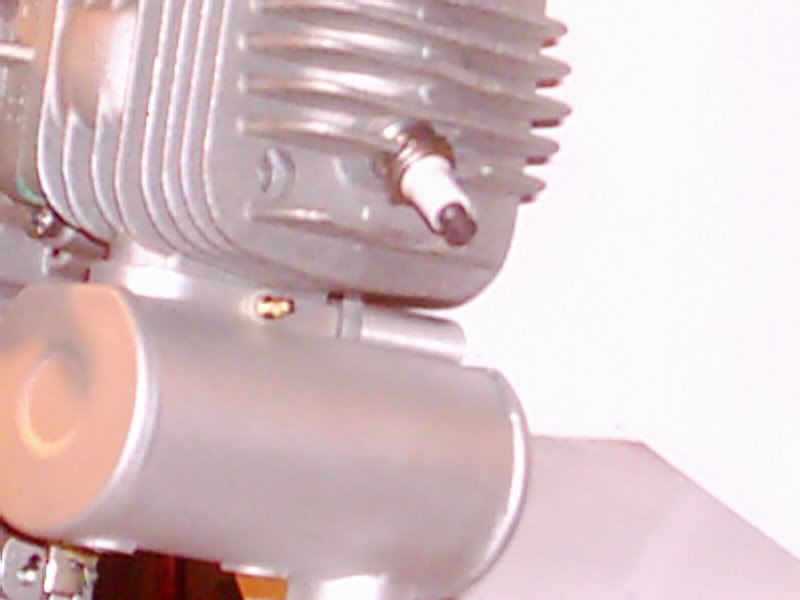

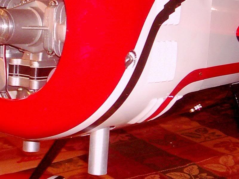

Default RE: Lanier 94" Yak help
Got all wiring and ignition mounted how I want it.
Finished cutting cowling for sparkplug rub, finished muffler holes.
I used a quarter for a pattern for sparkplug openings.
The plug caps just touched and if left they would wear holes in the cowling.
I also mounted the nipples in my mufflers for smoke.
Tomorrow night I guess i'll start on baffleing.

What did you use for the engine spacers/mounts and bolts? Why do you have it 1" for prop efficient. Not sure what that is? This is my first gas engine. Thanks Matt

ORIGINAL: matfree
I turned some standoffs ( 1 1/4" ) on the lathe from aluminum and have the engine mounted with 1/4" bolts. The prop washer distance that I am talking about is the distance between the back of the prop to the front of the engine cowl.
I usally make that distance as tight as possible, UNTIL I took the cowling of of a Laser 200 that I am flying and the performance almost doubled. I know that the cowl catches air, but it also robs thrust in the areas behind the prop.
My Laser 200 has 1/8" between the back of the prop and front of the cowl.
The Lanier Yak has a distance of 1" and should allow the prop to be almost to maximum efficient.
Anyway if you look at the picture of the full scale Yak that Mitsu1 poated there is plenty of distance between the prop and cowl on the real thing.
I just was always anal about keeping that distance as tight as possible.
This is my 1st time mounting an engine like this, but everything I have read it will work great.

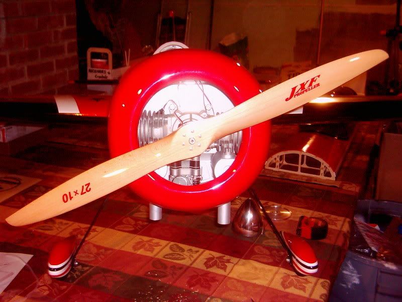

2robinhood, any special reason why you chose a JXF prop? Is it better than others you have tried? Also, have you decided what you're going to do with the choke? The arm on my DL is at an odd angle. What about yours?

ORIGINAL: Doppelganger
Steve
Out of wooden props I like the JFX and Vess.
Doesn't seem like anyone really uses Vess on larger engines.
This is my 1st large engine, I have sold glow engines and have gone 100% gasoline.
My list of engines are CRRC Pro GF26I, Brillelli 36GT, CRRC Pro GF50I, DL-50, DL-100.
I have tried Xoars, Zinger Pros, Vess, APC, etc.
So, wooden is 1st choice JFX, 2nd is Vess.
The best props I ever used are Mejzliks. They are my favorites.
I only went with the JFX on the DL-100 is due to price and I wanted a wooden prop for break in.
The JFX was $32.00, the Mejzlik is $80.00
I will be running a Mejzlik on it soon enough.

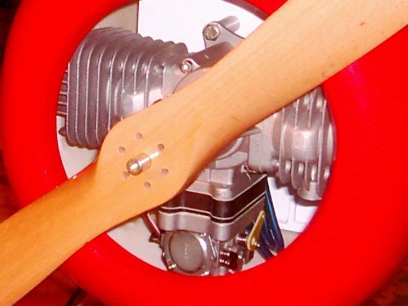

Steve
Yep, choke arm is at a funny angle.
I took a metal clevis and bent a 90degree " L " about 2" down from the clevis in a metal pushrod.
Drilled a hole right below the choke arm in the bottom of my cowl.
I then slipped a piece of glow fuel line over the entire length or the wire push rod.
I put the clevis pushrod assy up through the hole in the cowl under the choke arm.
The fuel tubing acts as a insulator against vibration and keeps the wire rod from ever touching the cowl.
Pull it straight down for choke on, push it back up for choke off.
Net, clean, and most of all simple.

Sorry I have been gone guys, but busy is not the word around here, swamped is.
For cooling purposes you are supposed to have at least 1.5 to 2 times the opening on the bottom as you do for the air inlet, I know it is a Yak and all opening. But we are not running a 480HP 5 cylinder radial so we do not need all of the opening. I have made the engine baffles out of everything from fiberglass to 4mil foam core, you close the opening and cut it out for your cylinders or cylinder and output shaft then make it duct back to the motor. It is rather simple to duct it this way and the Midwest foam core you can get at your LHS is very light and works just fine, then the hard part, you need to make the air hole on the bottom of the cowl that is 1.5 to 2 times the opening to let the air out. I will attach pictures of my big 260 where you can see one of the ways I do this, but on the Yak the cowl is round and if you make one opening it looks like carp. I have seen people spend hours opening all the louvers in the cowl and then still have to make more opening on the bottom that looked pretty good, but that solution is for someone with no life, LOL. On my Lanier Yak I ran a ZDZ 80 and only had a duct on the bottom of the cowl, I opened the bottom of the cowl just enough where the air would escape around the top and rear of the head and back to my Pitts style outlets which didn't look too bad, but for those running a twin you can make strips like I did here from mid way to the body of the plane on the bottom 1 on the outside of the exhaust outlets and a few in between to get the proper air flow.
ID:	969135   Click image for larger version
