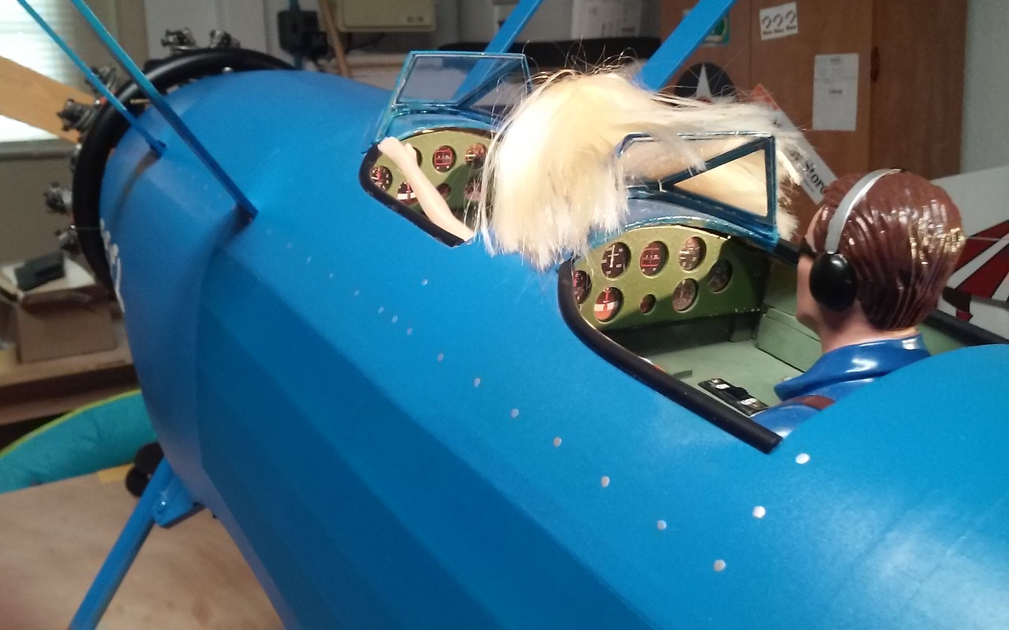

Default Photos of Ziroli Stearman 77" wingspan with evolution 7-77.
Figured out posting photos,

Oh and lovely plane!!!!!

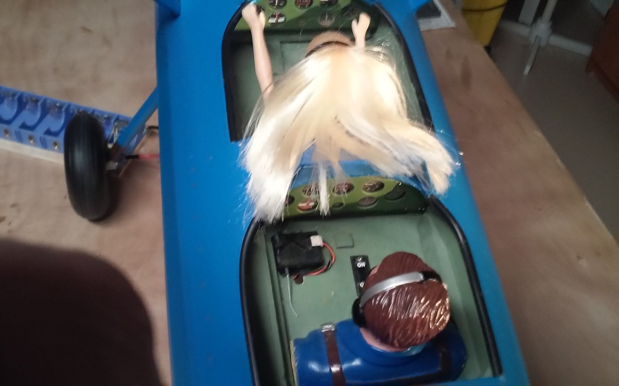

Originally Posted by Maxam
Is there any one with experience with the new gas radials from CH Ignitions. If so please post!!! Especially people with some hours on the engines. That 5 cylinder 75cc radial is appealing.-Tom
Happy Christmas All
Best wishes for the maiden.
Better get a hair scarf on the blonde. That mop is gonna end up in the pilots face upon run up!

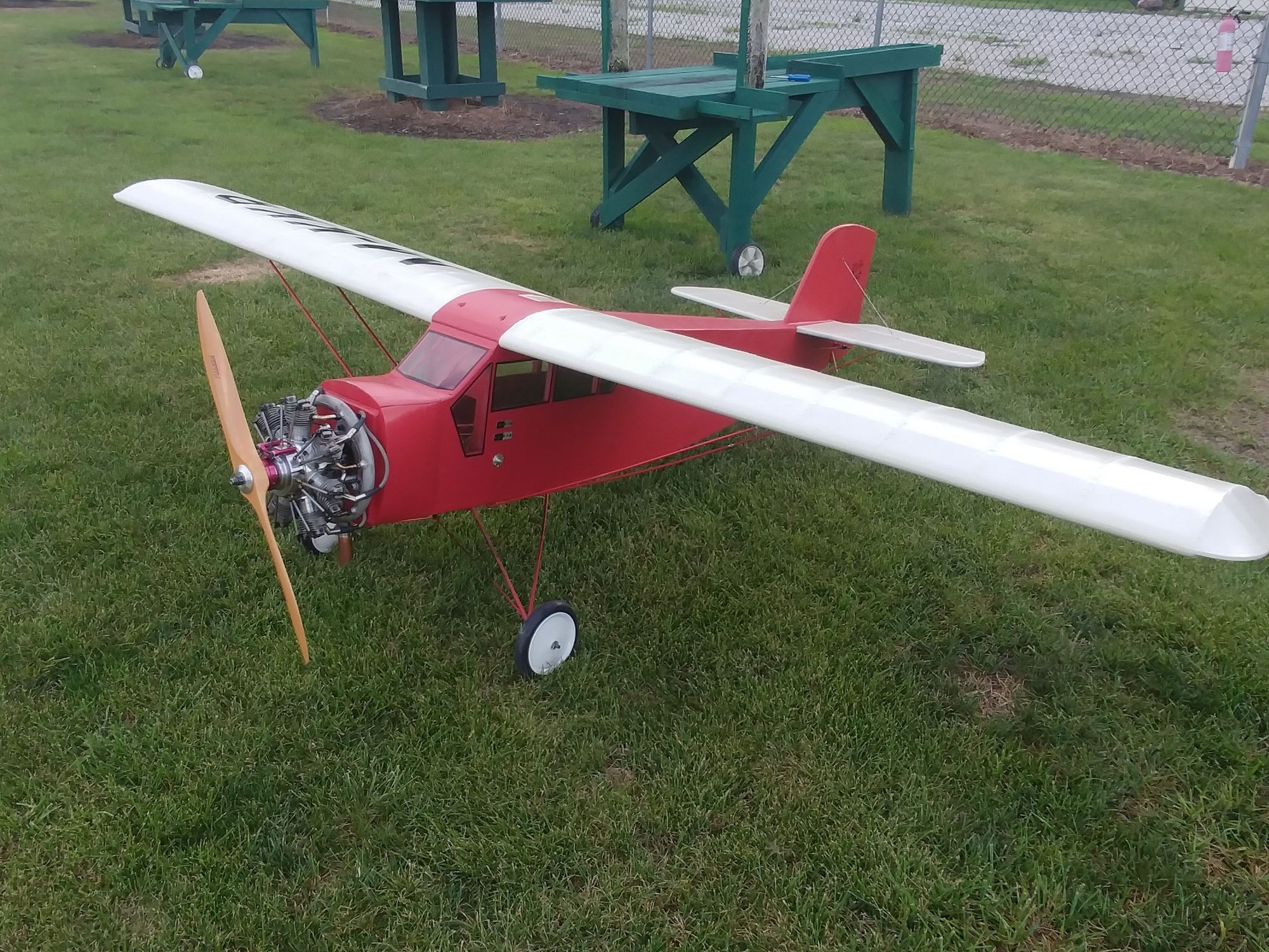

Hi I got one of these evolution 7-77. previous owner had it startet 3 times in bench only. Made a glow battery from a 7.2v 1800mAh nimh that I re solder so all the cells is in paralell. it should give me 1.2v 10800mAh and it works. had the first start today the engine will be mounted in a old At6 from vantex/hobby king vs 2135mm

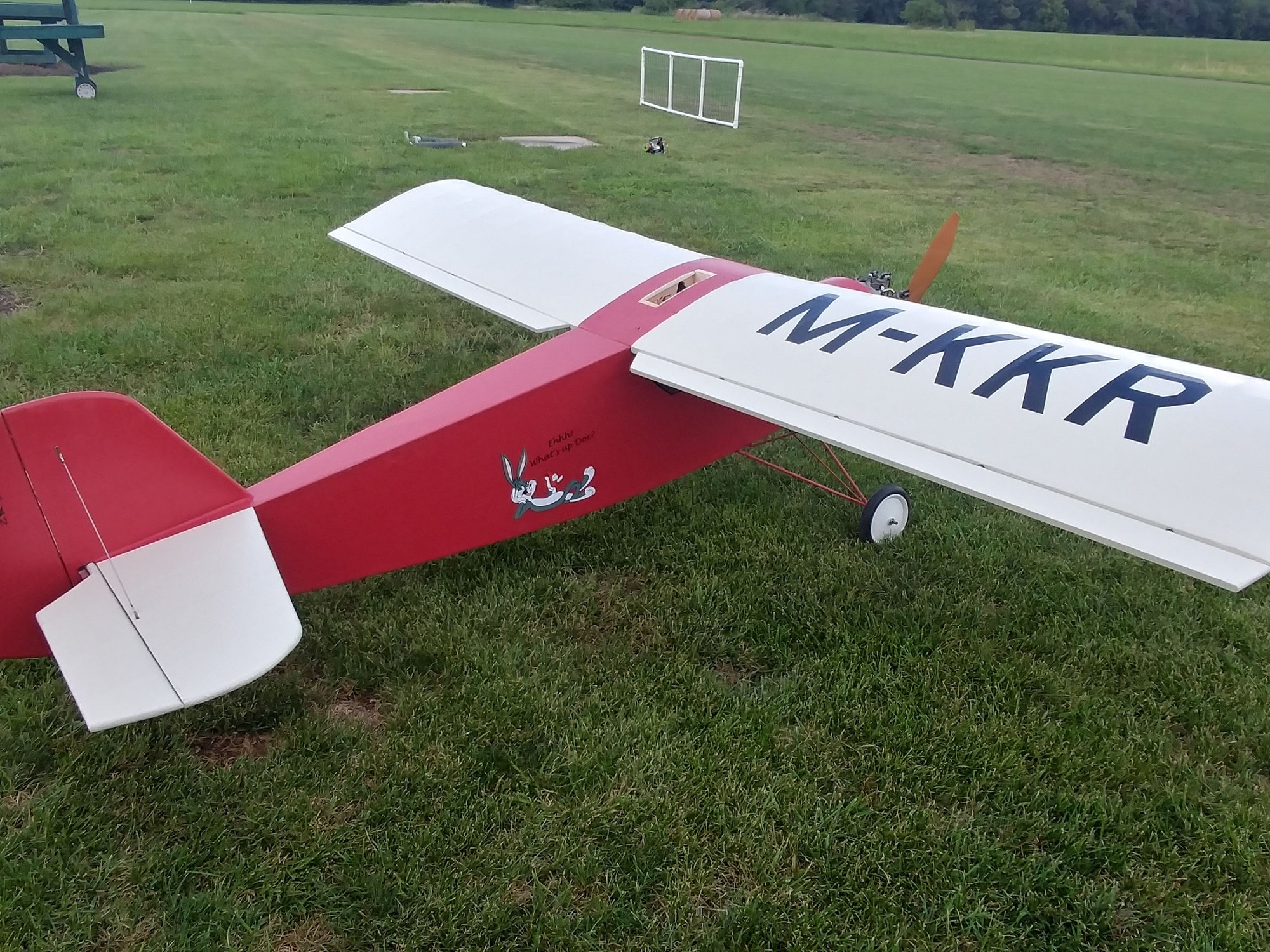

Hello, I dont always get the notification when people respond to this thread. Anyways, the gear is standard set up the original calls for an hook screw in the undercarriage with a rubber band to the cross member of the gear. I used three hooks with o-rings to make the cross member very tight to hold the gear pulled in. It works well on landing the gear does not flex much and creating a bounce. Hope that helps you out.

The 7-77 was converted to gas and Im using 23 X 12 prop, static RPM 4600 flies the plane very nicely. I modified the wing to a 3 piece, easier to transport.
