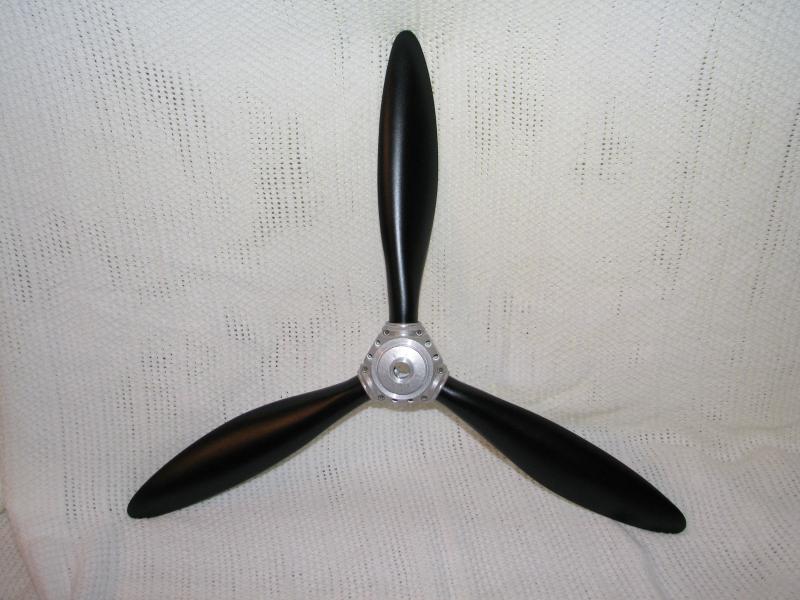

Default RE: UMS Evolution Radial Care and Operation
The feedback I recieved from Solo Prop was that my Evo 9 99 could handle a 25" 3 blade with not a lot of problem. That's what will be going on the front end of my Butcher Bird. A 26" prop is true scale forthe 1/4.5 scale FW 190,so the 25" should be just fine as a flying/static scale prop.

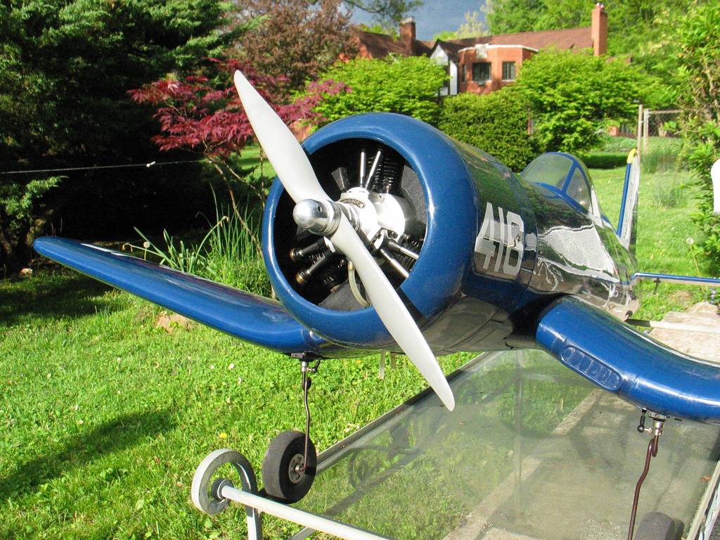

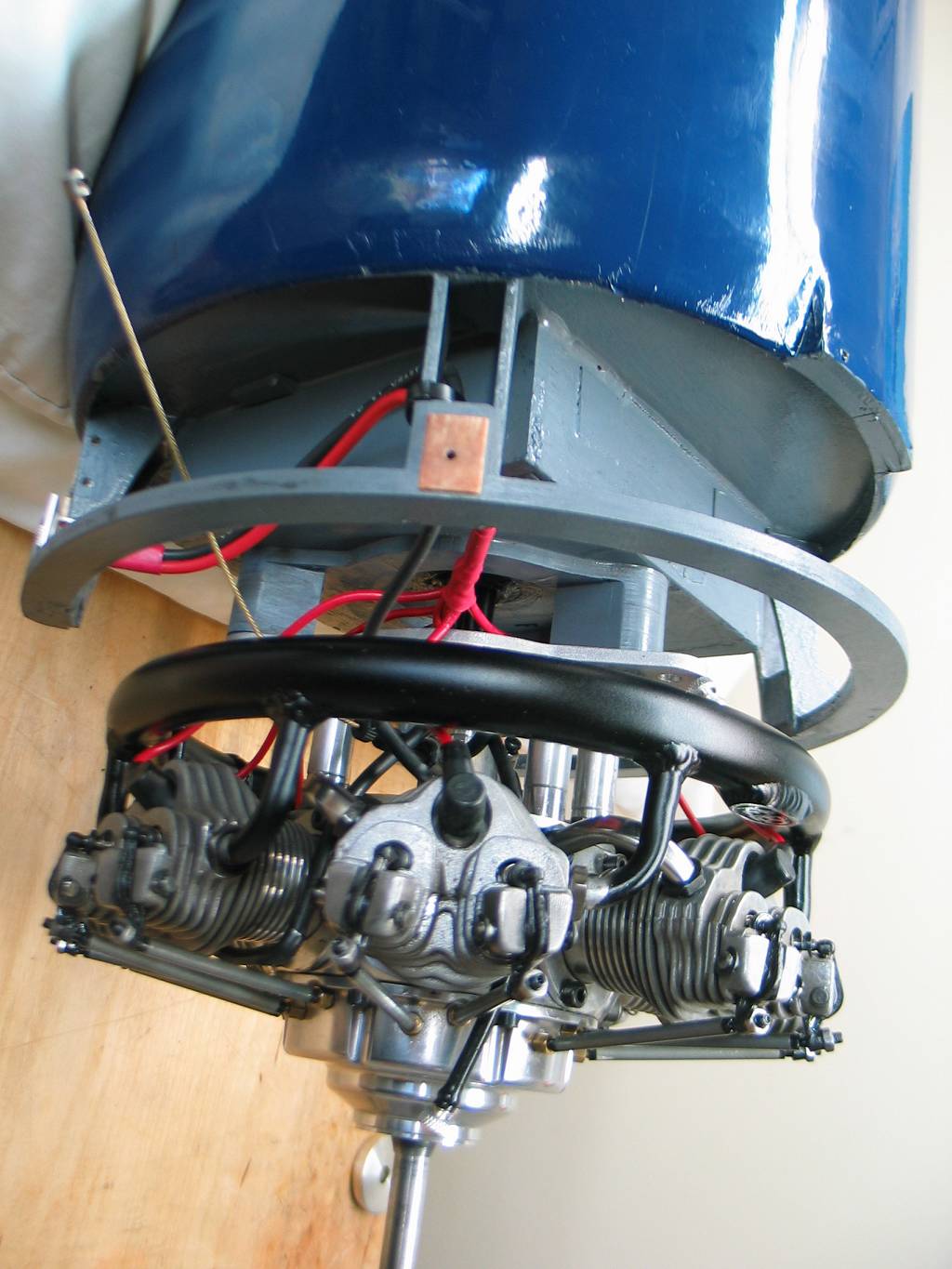

It all boils down to how much air can exit the cowl. The Black Horse corsair engineered in a curved fuse right behind the firewall along with the cowl flaps open fully so air flow is good. These engines are very cool running radials but you must have good airflow over those cylinders. My Hangar 9 corsair cowl did not have good flow over my Saito 90 r3 so I curved the front of the fuse and baffled the cylinders. The first picture is the BH corsair and the second is the H9 one. -Tom

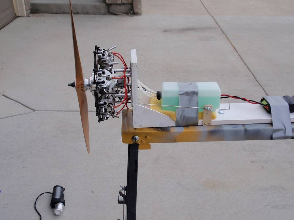

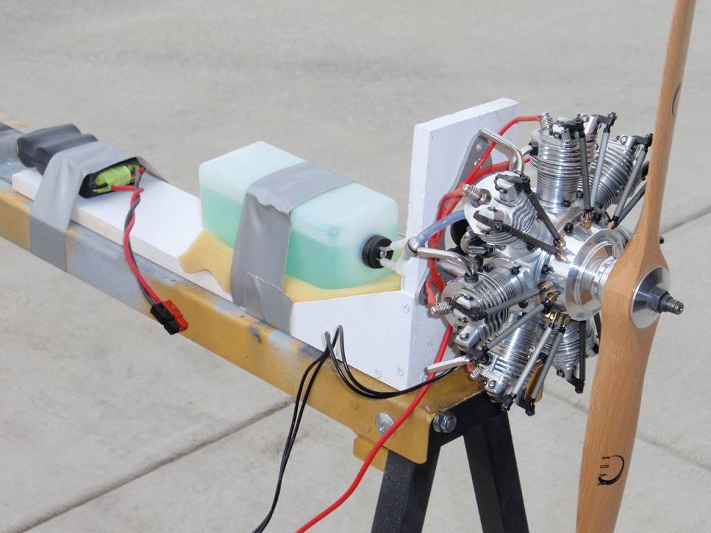

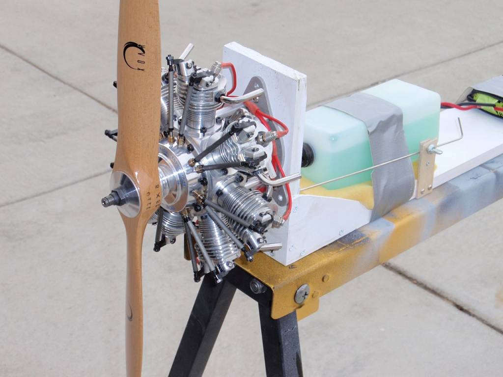

Hi,
I finally got to run my 7-35. Here are some pictures of my test stand setup. You can see a clip of it running at,
http://dabbles-n-doodads.com/RC/Staggerwing.html
Joel
