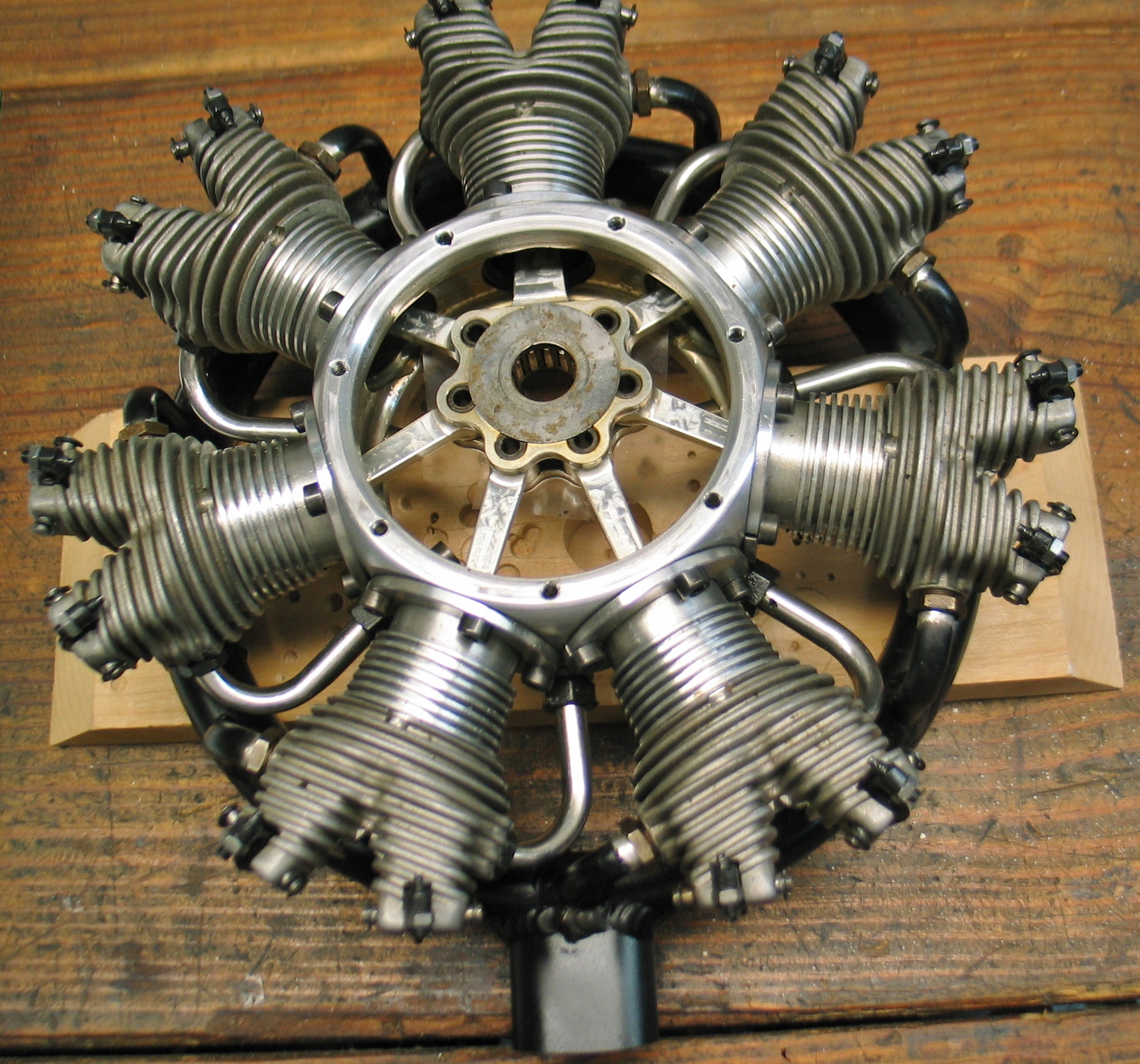

Yesterday I was doing a cleaning of my 7-70 in my Black Horse 91 inch corsair. The engine has over 200 flights on it. I like to keep my engines looking new so I was cleaning and doing a valve adjustment. All the plugs were removed so the crank was easy to turn making valve adjustment easier. The crank turned smoothly and the bearings have zero play. The lifters seemed noisier so I removed one of the brass follower guides. Unfortunately the cam track had galling right at the beginning of the rise of each cam lobe. Now I will see if UMS responds to my E-mail inquiring about sending me a new cam ring.....Cross your fingers! -Tom

they usually work well to buy parts from UMS.
They may take some time for bad luck, I usually contact Sripriya on [email protected].
can you image later on your comb plate, I have a new to 7-35
Lars

Lars, when replacing the cam ring, will the engine need to be completely taken apart or just removing the front cover leaving the crankshaft in place be enough? Thanks -Tom
Old 12-08-2016 | 09:23 AM
  #2063
Joined: Oct 2010
Posts: 227
From: Öland/ Kalmar/ sweden
Tom, do you have a loose rear cover and remove the circlip at the crankshaft.
Then it's just to remove the front cover, they are the easiest to make.
Lars

Lars, I cannot believe how easy everything came apart. My after run oil is good stuff! Corrosion was nearly nonexistent. The front section is on my bench and I cannot believe how enormous the crank bearing is. It seems i must tap the crank out and then somehow delicately extract the main bearing to remove the cam ring. Any idea's. Again thank you for your help! I know I sound like a mechanical neophyte. I just want to use good methods. -Tom

I tried heating the front housing to 275 F. The crank will not tap or press out....eeeek. A friend has a 20 ton press so that should work well. Hopefully a force around 250 pounds will press the crank out.....I hate to hammer on the crank shaft. hard on it and the bearing races.

Here is the main crankcase and the front housing. Excellent condition. I discovered one of the followers had not been domed like the others. The galling likely happened a while ago. These areas have been "smoothed over". When rotating the correct direction the followers DO rise smoothly even with pressure on them. The engine is in such good condition otherwise, I would like to properly repair with a new ring.
