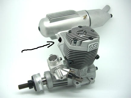

Okay. Here is my question with a picc attached, on the side of the muffler is a hole tapped for smoke, its just an open hole. there was jb weld over it but i had to take it off. now my question is, is this causing my issues, not supplying enough back pressure? if so it makes sense. let me know
That is a problem because anything that reduces muffler pressure , reduces the available pressure to push fuel from the tank . By all means , seal that hole back up by whatever method works best for ya .
Course , that may not be the ONLY problem , but it's always best to start with the obvious first , and we all know OS did not sell the engine with a hole drilled there !

Joined: Jun 2007
Posts: 20
From: Lawrenceville, GA
nah the hole was drilled for smoke like 10 years ago. and i fired it up it ran like a top. baby screamed. even held the plane up and shook it and it didnt die, but when i went back to idle it died sometimes.
I think this is my only issue honestly

From: Pine Grove, CA
sounds like the idle mix or midrange needle valve is too far open allowing fuel to run back into the tank. Or there could be an air leak in the idle mix system ( bad o rings) this carb has at least three orings on idle needle/ spray bar mechanism. The orings could be worn or cracked from drying out.
Jerry

From: Karlstad, SWEDEN
I still don't see any real problem, it just sounds like it is set too lean, have you even touched the needles?
If the needles were not needed, they would simply have omitted them from the beginning...

Flew it, really awesome plane, engine did ery well too thanks guys
