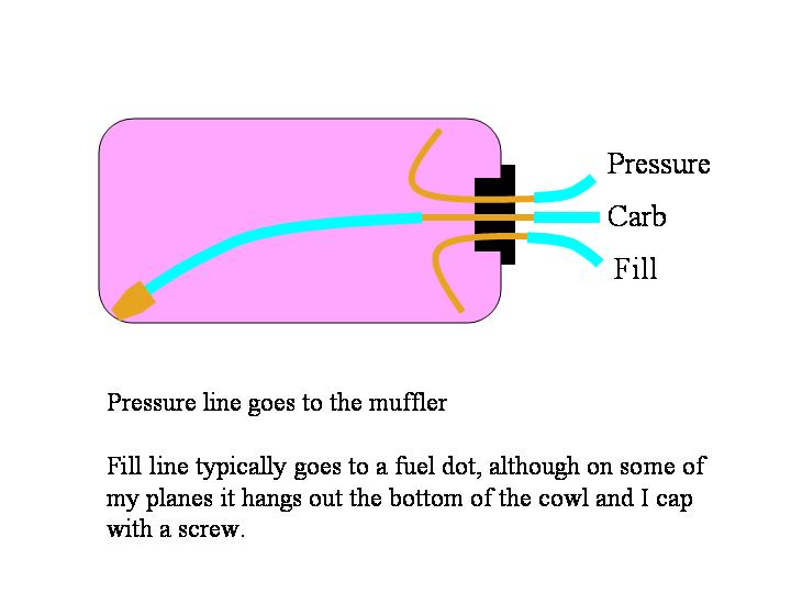

I want to install some fuel dots (I'm thru with E-Z fuel valves) and need to see some plumbing diagrams on how to hook them up. I'm curious how you by-pass the fuel line to the carb when fueling/defueling.

When you use a fuel dot, the tank should have 3 lines, one for fueling/defueling, one for pressure, and one to the carb.

Yes, use a three-line system on any engine other than a YS. With a YS, use two lines with two tee's and two fuel dots.

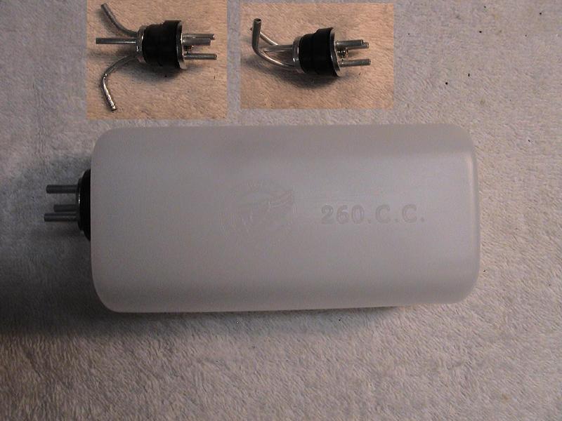

Here's a diagram showing my 3 line tank setup, and a picture of the most recent one I assembled. The left pic of the stopper shows how it will be aligned in the tank. The one on the right shows how it is aligned when I put it in the tank. Once it's in I just rotate the tub so it's in the bottom front corner. To completely empty the tank I just prop up the tail a bit and I can get it emptier than with any clunk setup.
