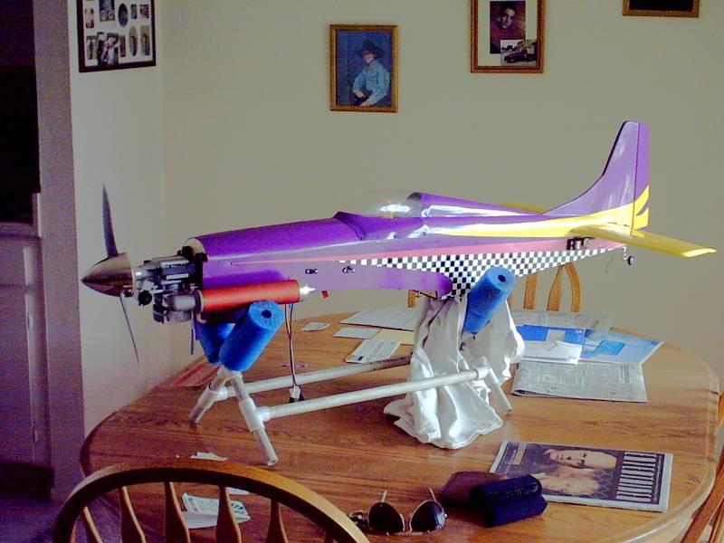

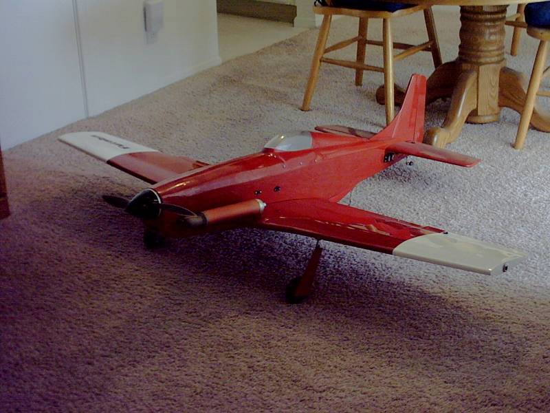

Old 02-15-2007 | 08:56 PM
  #480
Cyclic Hardover's Avatar
Joined: May 2002
Posts: 7,296
From: New Mexico,
Default RE: ST2300 Testing and Experimenting
I have a 14/12 APC on it. Also have the Jettstream Muffler on it. Not sure of the Rpms but it does well up here at 5000ft. Be real good on the coast. Here are a couple of lousy photos. The purple is before the recover which shows the engine setup.
I've seen a few with Saito 120's on them. Flew real good. You need to beef up the inside and outside of the firewall areas to help it hold up. Actually i do that to every plane I have whether it needs it or not.
