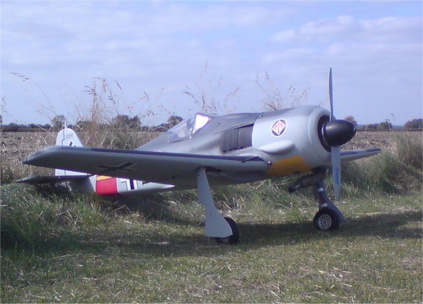

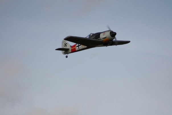

I have the OS200S version, pulls my EMP/YT fw-190 (15lbs) around the sky with ease, only scale flight of course, no prop hanging lol
but has plenty of power for fast fly bys, loops and so on
only had a few flights. so still a bit tight, but have tacho'd an 18x8 graupner G-sonic at 8,500 so far......would expect a few more rpm after its run in?
cost over here is the same as a saito 180, thats why I bought it, bigger engine, same price.....same power, more torque.
anyway, I am pleased with the way it flys.....so far

Well 8500 RPM with a 18x8 is pretty damsel good!
I looked in my references and that matches what a Supertiger 3250 puts out with a 18x8 and equates to 18.9 pounds thrust (per the reviewer at that time). What nitro are you using? Being in the UK I suppose your elevation is quite low which also helps. But over 18 pounds is great.
I like your FW190. Have you parked it hiding in a hedgerow in France circa 1944? That prop looks good on that big round cowl.

I am using Optifuel 20%MV FS mix, and yes we are almost at sea level here in south lincolnshire
Yes it parked in hedgerow, camo netting just taken off ready to fly
I did think about a 3 blade prop, but thought I would stick with the 2 blade for now, plenty of pull is nice
