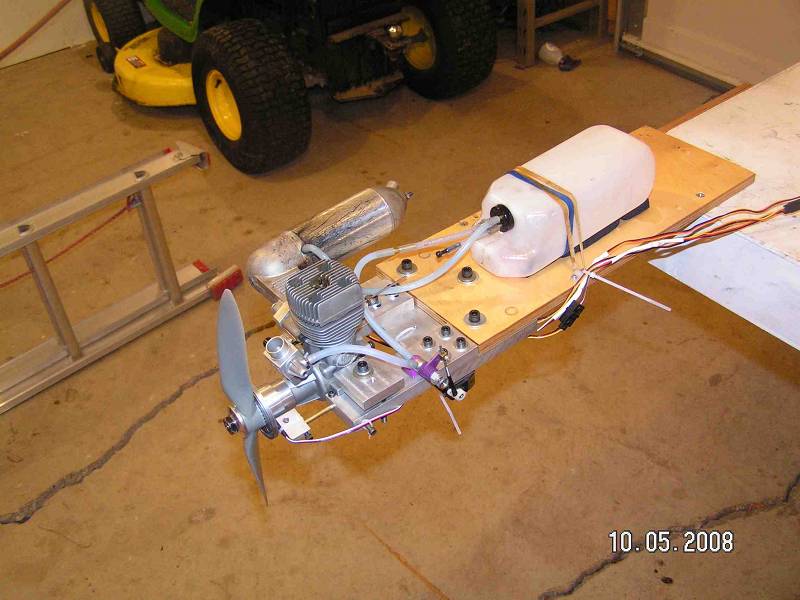

....yep, you can trim some off the front of the pipe if necessary. In this application I
was limited from shortening the header because of the pressure nipple. I had slid
the pipe as far forward as I could. The Zip-tie is to keep the pipe away from the
nipple.
If the pipe will slide over the header , or the header will slide over the pipe,you
can slide one over the other and shorten the overall length with out cutting it right away.
You can see how short my system is to get maximum RPM out of it, 18,100 on the ground.
The engine still has the original plug in it I got with the engine years ago.
I have heard it said that you should not slide one pipe over the other. It doesn't matter,
you can do it....no problem.
FBD.

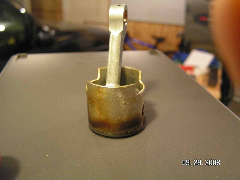

The piston modification were to the skirt to uncover the ports when the piston in at BDC. I'll try get pictures of what I have done posted

I presume you mean something like this? It's a worthwhile mod (if only for helping cool the small end of the rod and piston) and I don't know why it isn't done on more engines. Apart from the cost of extra machining anyway.

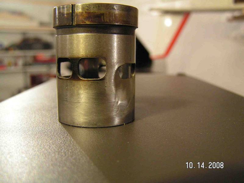

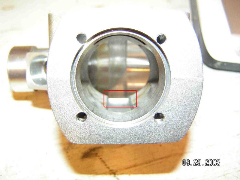

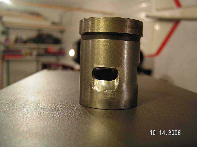

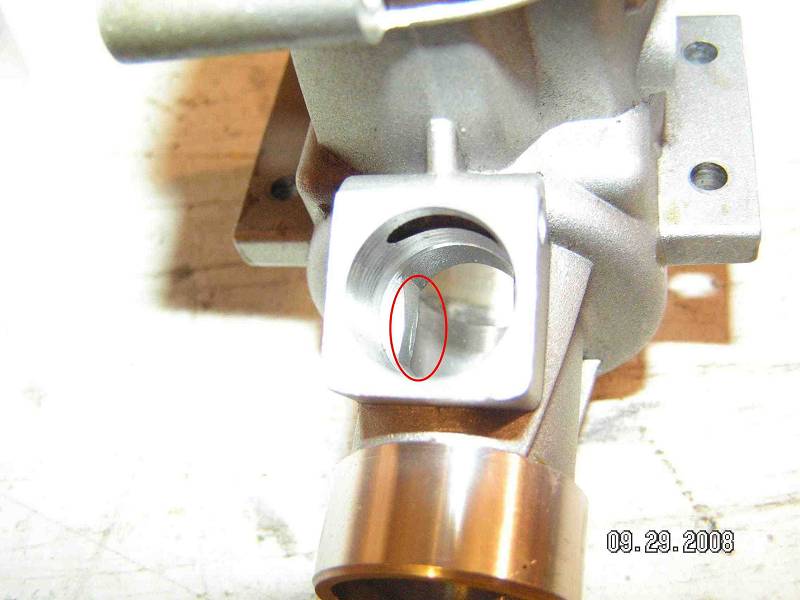

This is a first stage of my modifications
I raised the case exhaust port, this was to uncover the port in the sleeve. It appeared to be a casting problem
I deburred the inlet port at the crank, a burr was protruding into the port
On the case I lowered a raised spot directly below the boost port. the pictures do not the changes well.
I filled the crank with JB weld and smoothed in the inlet side edges, and moved the rear edge back so it was not protruding in the case opening.

I included a picture of my test stand, you can see the MDS muffler and adapter.
