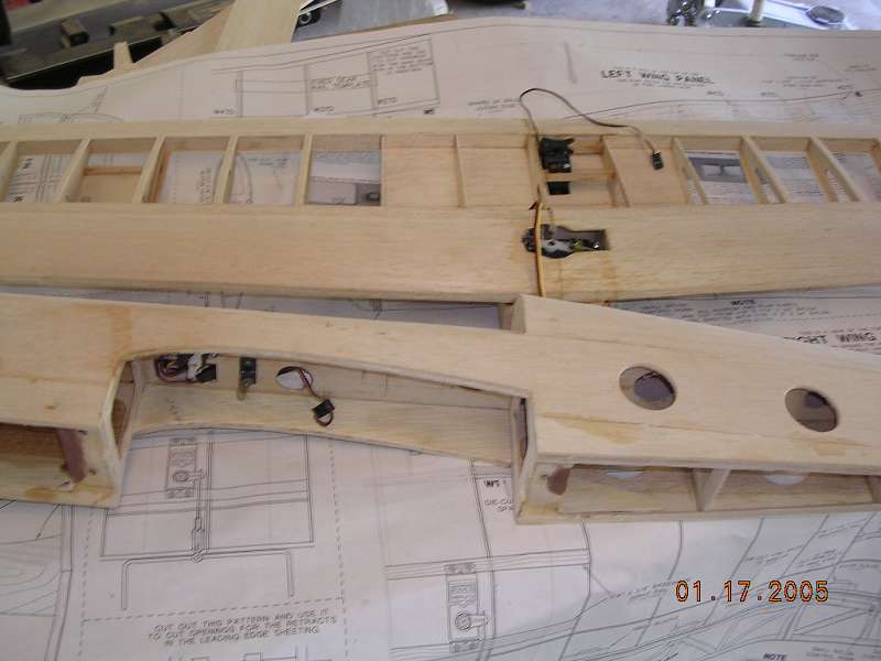

Getting close to test fly. The plane is complete and flight ready minus cowl. I glassed the cowl today, but temps of 50 made the glass slow to cure the epoxy. Photo attached and waiting for a good day to take it out.
The engine is broken in on another plane so I don't expect a problem with the engine.

Ok guys here is the
, the [>:], and the [:'(].
The plane is complete and ready. The cowl fit nice with the remote glow driver.
The La. .46 fit in the cowl and does not over heat.
The retracts and flaps work.
Range check is good.
The transmitter w/ new batteries now has 400% in operating time.
But..................
The engine just won't run reliable inverted cowled. The engine will turn 12,800 w/ 10x6 prop and 15 % cool power fuel. This combo worked well for upright in the very same engine. I tried 3 different heat range / type of plugs and 2 props. 10x6 and 11x6. To improve the idle and transition. This is an airbleed carb. At idle it is rich and at throttle up it dies instantly. If allowed to idle it will load up and die. I have tried with the airbleed to lean it out, but no success. I have experimented with 2 different types of fuel with no luck also. At full throttle and mid range operation it is ok, it just won't idle down and then accelerate w/out dying. (the fuel tank is positioned for c/l of tank to c/l of carb.
I have a bad back and my specialist told me,,,,,,,no bending so I can't have an engine that won't run reliable.
I am going back to my base engine that I now buy for new and replacement engines. I will buy the Saito .56 AAC and install it horizontal. This will mean a complete rework to the throttle servo and at least a 3 week delay in first flight. I know you will ask why not put the La horizontal. I don't have the patience to rework the fuse for the La and find out it still won't perform. I have had very high success w/Saito ,, they just work out of the box, and this is the type of reliability that I need.
What engines were used on the current flying planes, inverted,, and how are they on reliability. Jim

Ok,, first flightd results. [&o]
The bird has a tendency to stumble over it's toes during taxi,, wants to nose over. I used the new saito .56 which was excellent for reliability and power. It worked great. I also used a 12x6 apc prop which never made a first flight. The prop tips were mowing grass too much so I switched to a MAS 11x8. This prop turned 10,200 on the 200 rpm rich setting. So I guess still too small but I did make the 3 flights on it. The CG was a bit nose heavy at 3" from the leading edge. This was due to building for the La .46 and switching to the Saito .56. I think this made it more sensitive to nose over. However First flight was full up elevator for takeoff roll and the bird lifted nicely. The flight was smooth but I was suprised to both the elevator and aileron sensitivity. The elevator was not sensitive at all on the reco. settings. But the ailerons were very nice around neutral but at extremes rolled the bird very fast. So the ailerons are great, but more elevator at least for my flying.
The retracts worked great. One small problem,, I didn't tighten the screw on the flat well enough so one of them turned in. Tightened screw all was well for the rest of the day.
Flaps were another story. Reco setting is 1/2" max. Of course I used 1 1/2"..
I found something interesting here. The first 1" of flaps caused the plane to balloon up. But the last 1/2" caused it to fall like a stone. I think excessive flaps just become a speed brake and lose lift resulting in the rapid desent. I have limited the flaps to 3/4" and mixed down elevator for the next flights.
I have also moved the battery pack from under the tank to the location shown on the plans to make the c/g 4" from leading edge. This adds a lot of weight to the tail and should help with nose over.
So,, more flights possibly today given weather. Don't know if this bird is one I can recommend yet. I have had to do a lot to make it fly the way I think it should. Perhaps just too old a design. I will find out on the next trip out.
But the good news.
It does fly well with the gear up.
The flaps do work.
The retracts worked flawless.
The saito was excellent.
Now to see If It will do as I would like it. Probably will have to buy a new cowl after chopping this one for the 2 stroke and then using a 4 stroke.
Flying weight is 5# 12 oz. About 4 oz over the target weight, but the saito add on added 4 oz over the La. .46. But worth it. Jim

Latest update. I set the CG at 4" from leading edge. Wow what a different plane. Flies great. Landings 3 point. Inverted almost no trim change.
The saito reliability and the aft CG made the plane a nice flier. Landings with 1/2" of flaps and flap to elev mixing worked great.
I can fly high overhead at full throttle go to idle, drop the gear and extend the flaps with no change in pitch. If done correctly a nice 3 point landing. Tip over on the prop is reduced with 11 " prop and 4 " CG setting. It flies so nice I installed the cowl. The remote glo driver is great for starting. Looks like this might be a nice flying bird.
There is some adverse yaw when doing maneuvers due to the short couple rudder to wing ratio and this is noticable so you won't win a pattern event with this bird. But looks like a great 30's flier with gear up on fly by's. Many positive comments today. Total of 6 flights. If anyone needs pics or info just let me know.. Jim

For those of you still following. I finally have the nobler flying well. Lets discuss the issues.
Problem: Short retract landing gear makes nose over in grass a problem.
Solution. Fly with C/G at 4" from leading edge of the wing. I know on the plans this is the most aft point, but the plane handles well and after 6 flights today only one tip over.
Problem: Retracts are weak due to cutting out for retract coil on wire.
Solution: I added a 1/4x1/4" spruce overlay on the rib that was cut out and currently the gear is strong enough for touch and go's
Problem: Engine reliability inverted
Solution: I bought a new saito .56 which is almost perfect for weight / balance with battery behind the trailing edge of the wing.
Problem: Linkage binds inside the fuse due to the 5 servos.
Solution: Build it as a big bird. Put 2 servos in the tail as a big bird and this cleans up the linkage
Problem: Weight
Solution: I put weight reducing holes in both sides of the fuse and the fuse top that the formers are glued on.
This took out enough weight to compensate for the 2 servos in the tail.
Problem: What to do with the engine offset in the fuse.
Solution: I put the engine straight and use rudder on take off.
Problem: Flaps cause plane to need excessive up elevator.
Solution: Mix flaps to elevator for up elevator.
The plane came in at 5 1/2# and flies well. There is yaw due to short coupled rudder and small size. This is not a major problem.
Landing with 3/4" of flaps and retracts down can be very slow and a 3 point nice landing.
Summary. I would not recommend for a beginner or pattern. For normal weekend flying it is cool to take off and pull up the retracts.
I take off pull up the gear, aileron roll and turn away from the field. It is finally flying nicely and landing well but the yaw is a nusiance.
If you are a proficient flier and builder this is a low cost way for retracts and flap fun. But I highly reco. the saito .56 for the power to weight and balance issues.
Happy flying.. Jim
Problem: Weight
Happy flying.. Jim

One more update to the Nobler. I noticed it flying in a left yaw. (remember I built the firewall with no offset). I have added a 1/8" shim for right thrust to see if this corrects the yaw. Weather had not been favorable for test flight. I would expect it only to fly better. The saito .56 inverted has been flawless in operation. The La. 46 that would not idle/transition inverted has been installed on a Ugly Stick in the vertical position and runs well. There must be something [:'(] in the crankcase, piston, sleeve that directs fuel improperly when inverted. I won't be using any of the La. engines in any position but vertical or horizontal,, never inverted.
Jim
