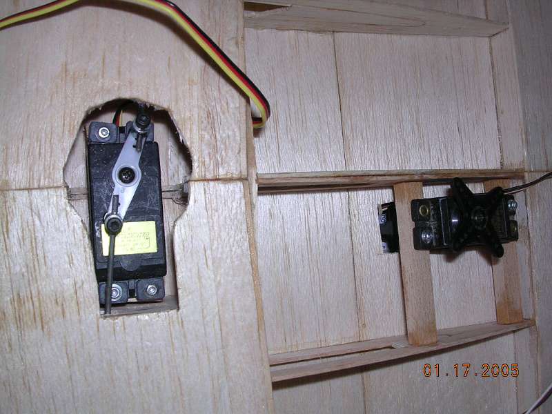

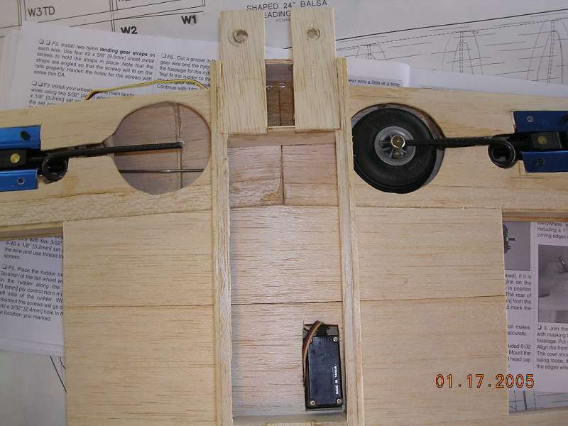

Ok Pics will be included. I have the retract servo installed and they work. I had to move the throttle servo to the rear to clear the retract servo bolts. You will see in the pic. The top sheeting on the wing was left off for the photo. I have done a quick cg check and will have to have the battery as shown on the plans. Keep in mind I put 2 servos in the tail as / per big bird. This took out the wood beam mounts, push rods and supports. My plan was the removal of excess plus lightning holes would lighten the tail to compensate for the servos in the tail. Preliminary looks like it is working out. Got to run,, wifey calling.

One additional item I now have the retracts functioning properly. They weren't very difficult to set up. But I did add a hardwood support beam across the rib where the material was removed for the spring to retract. Don't know if this will keep the retracts in the wing when landing on grass, but at least it is now stronger. Thanks for the info on them breaking out.. Jim

Plane is ready to cover. The retracts fit and work nicely.. however I am still concerned if they will stay in the wing while landing on grass. I did add a hardwood 1/4x1/4" support under the spring coil on the rib with the cutout. Don't know if this is strong enough,, still looks weak.
I built the servos in the tail "like the big birds" due to the push rod clearances. I was planning to use 30 oz servo on the elev, until I notice the manual stated if you use 30 oz,, use 2 servos. UGH>> So I went with a standard servo,, Really didn't like the weight in the tail. Still have a 30 oz on the rud. Manual states use bigger for rudder to work at high speed. "might have to slow down".. but we will see how it works out.
