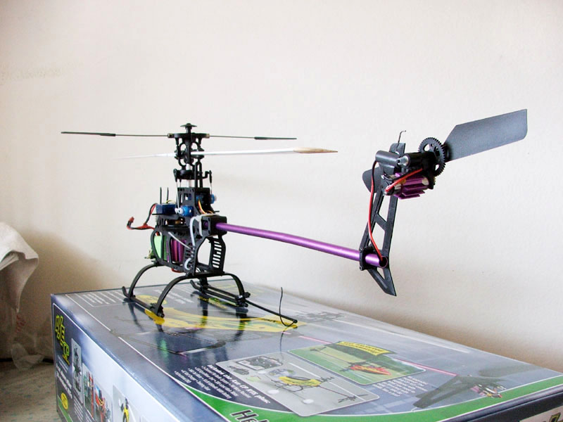

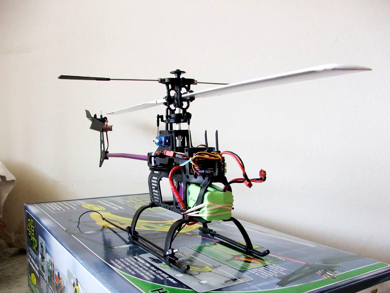

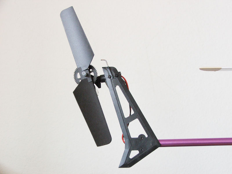

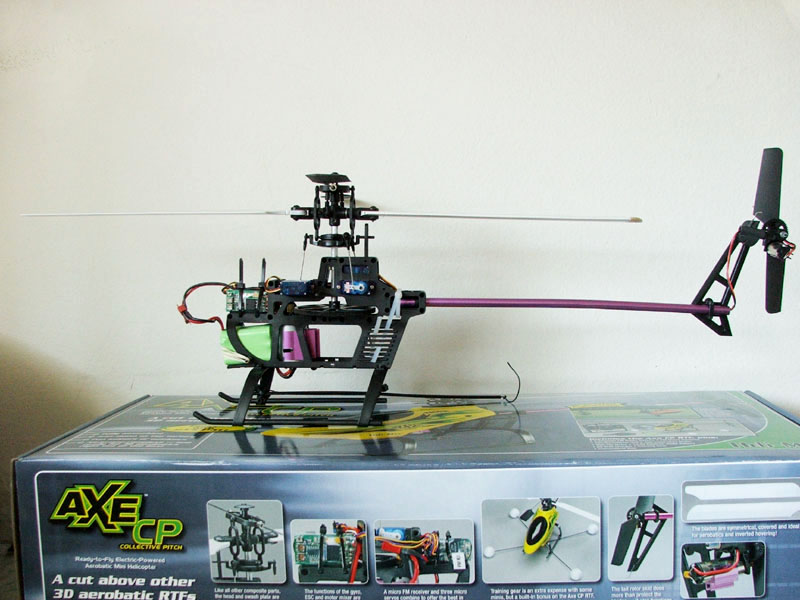

Well, here is my tail mod. I did it to address the lean my Axe was having while in a stable over. As Heliko suggested, it doesn't remove the lean, it only lessens it. Beyond trying to "fix it", it was just a fun little project.
Problems I still have to overcome/address:
• It's not adjustable. Figuring out the height was pure trial and error but the period between setup and results was a long one since it required soldering, cutting, glueing (epoxy), and screwing it back up. I initially had the center of the tail rotor above the plane of the main rotors and that resulted in a lot of drift to the left and instability. It's currently a tad lower than the main rotors and is much more stable
• It's not rigid. The only things holding up the system are a small piece of shaped balsa wood, a 3/4" section of a BIC pen, epoxy, and screws (HMXE7342). This minimized added weight, but there's an obvious vibration of the inverted vertical tail fin and thus the entire tail rotor.
• It's turning about the tail boom. Many people have mentioned how weak the four screws that hold the tail boom in place are and it's evident here. I know, I know...this is not the intended application and I've accepted that. So, what I've done is added a thin coat of epoxy and zip-tied that section the best I could. But still, as the vibration and the torque adds up, it still gradually turns and angles off-center.
Again, just a fun little project. If it happens to get some gears turning in others here then that's just an added bonus.

SM that came out pretty cool. I'd like to see a hovering vid if possible. The vertical fin from mircoheli.com might work better. It's stiffer than the plastic Axe fin.
You could also get a longer piece of tubing and bend it up with a small tubing bender or carefully by hand to get the height you need.
About the frame screws your right they don't hold very well. I've replaced the screws with [link=http://www2.towerhobbies.com/cgi-bin/wti0001p?&I=LXD973&P=SM]these[/link] and they work much better. The heads even work with a 2mm allen wrench.
#1386
Joined: Jun 2007
Posts: 67
From: Johnson City,
TN
SM, what about 2 rods going from the frame to the end of the tail or adding a horizontal fin and the rods go to that to keep the boom from twisting? Perhaps some flat carbon to use as rods and if you can find it wide enough make a carbon support post for the upwards fin/mount for the tail motor? [sm=idea.gif]
like you said - just some thoughts.
You know, that setup would save on tail fin strikes some wouldn't it.

I noticed after looking at those pics that you seem to hae the beginning of a blackhawk or other scale style heli. Are you going to put a body on this now?
ORIGINAL: s_mcflurry
