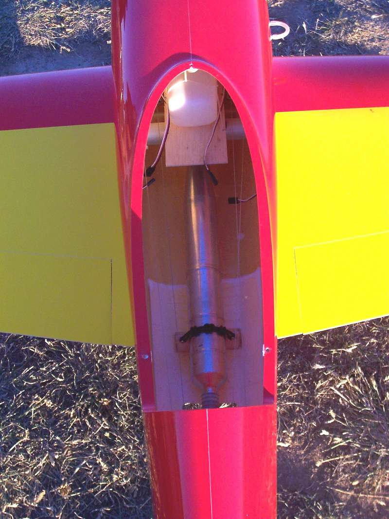

Hi All
My 2x2 has flown. I built it with an OS140RX to keep it light so I could use it as a backup Pattern and backup IMAC model.
I put ALL the servos up front and used a bell crank pull pull for the elevator. The model weighs 5.4kg with a lipol and 300g of nose weight.
I took out the lipol and nose weight and replaced it with a 340g 6V 2400mah nicad.
How does it fly?...............beautifully!!!
It will fly F3A and IMAC. After flying it around to see how it rolls, loops, snaps and knife edge looped, I pulled vertical did a 2 of 4 and positive snap in opposite ..............easy!
It balanced well behind the recommended cg range. It will fly inverted hands off. I would prefer it to be a little nose heavier, but at this light wing loading it doesn't have a nasty bone, so I'll leave it.

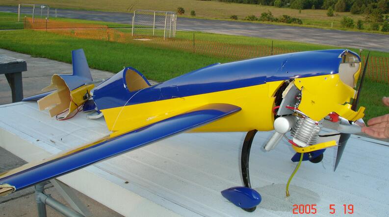

Here's what's left of my brothers 2x2 after a mid-air with a U-Can-Do 60. Both lost their planes. It was 13.5 lbs with a 50 and Pitts muffler. I'll let my brother post the rest about the plane (if he feels like it). His new one is on the way...

Well, for the 3-3/4 flights I had on it, the plane was incredible. It was setup with the maximum throws we could get out of the surfaces and the roll rate put a shock flyer on high rate to shame!
I was finishing a knife edge loop when the UCan Do 3D came and cut through the rear of the fuse, of course, only the 2 of us in the air, and only 3 of us at the field that evening, all trying to get some flying in before dark.
The plane had 8611A's on all surfaces and Duralite 2800mah pack on the receiver, it all worked well. The DA50 was going great on a 23x8 Mejlik prop and it would hover at a few clicks of throttle.
Now I'm just waiting on the new kit to arrive and get going again!

Looks great Buzz!!
