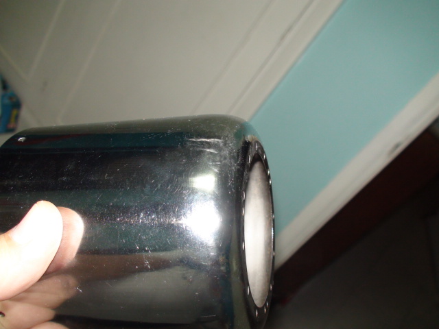

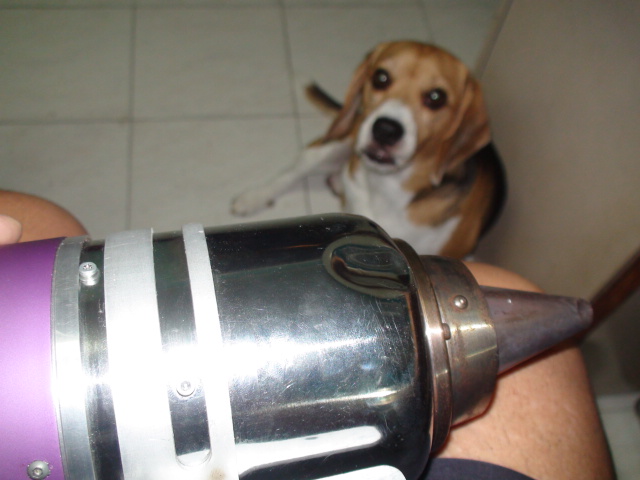

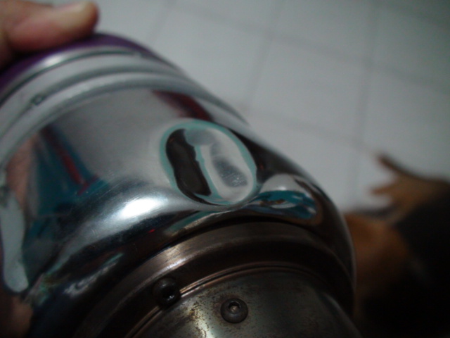

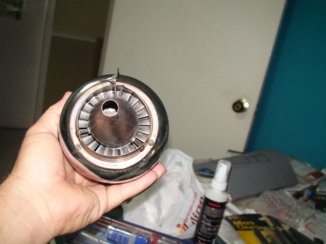

My P-80 was hitted by the landing gear during a hard landing causing a big dent in the outer shell.
Compressor and turbine wheel are turning free.
I lighted the turbine but just at minimum, and all seems to be OK
Can I run it in this condition or am I taking the risk of destroy it?
Or is preferable to take the shell out to a machine shop to try to fix it? Or replace this part?
If needed to be repaired or replaced, can you tell me the steps to remove this shell? Seems to me to be an easy job, but I need your advice.
See pictures

I just tore my turbine down this week and I would wait to hear from matt for an official resonse. What would worry me is the the AIRFLOW restriction due to the size of that dent. Did you notice the temps when you started your turbine? I would think it might run a lil hot. I don't think a replacement can would be that expensive. If not to your could easily remove the turbine from the outside shell and bang that back into a shape.
There is a pretty good size gap between the combustion chamber and the outer shell.. the air does flow through there though.
If you look in the forums for TURBINE TEARDOWN or TURBINE MAITENANCE there is a youtube video link of a ram750 or TJT 750 size turbine.. The teardown is very close to jetcats and your not gonna disamble the compressor or rear fan.. that is all one assembly and will slide out of the shell in 1 piece and allow you to work on the shell.

As Sean indicates, it is a question of the flow. I have seen dents this big, but not that close to the EGV. Also, at temperature, the stability of the EGV is very important to maintaing good rear bearing life. This is just a very hard call to make. I would have it fixed, but Bob Wilcox has seen 100 turbines for every one I have seen and he might have a different call on this one.

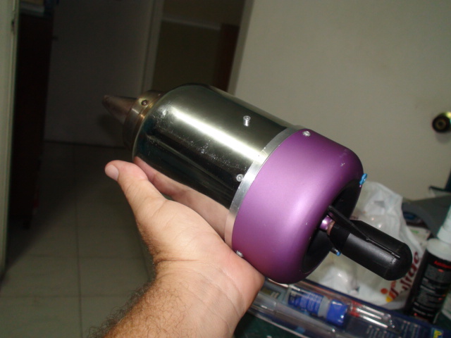

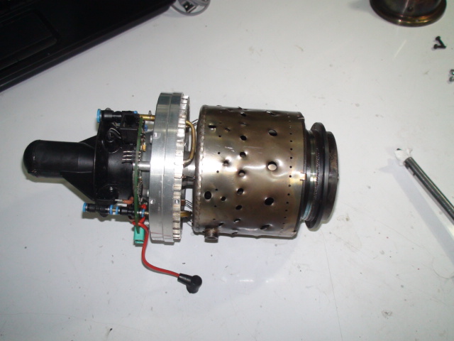

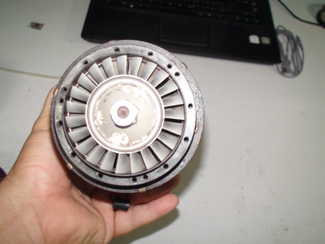

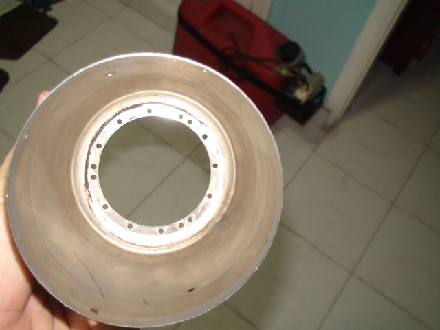

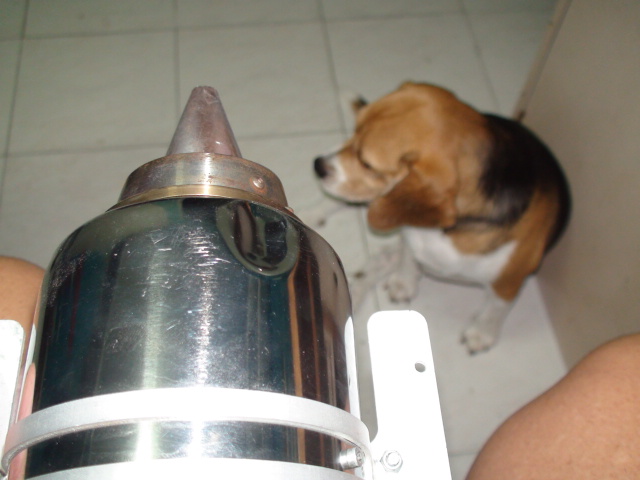

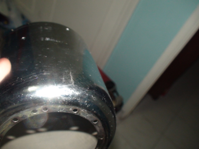

<div style="background-color: rgb(255, 255, 255); padding-top: 5px; padding-right: 5px; padding-bottom: 5px; padding-left: 5px; margin-top: 0px; margin-right: 0px; margin-bottom: 0px; margin-left: 0px; font-family: Arial, Verdana, sans-serif; font-size: 12px; ">Well, Jet Cat said that this was a pretty bad dent and they were concern about EGV alignment.
They suggested to send the turbine to them.
But finnaly I decided to take the can out and bang the dent out.
Then I reassembled the can again and now all is OK. Even there is no rubbing between turbine wheel and EGV.
Just need to do some tests and if all is OK, fine. If not, I will send it to Jet Cat.
