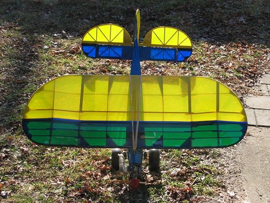

Chevy,
See the picture (taken before final assembly). The balanced portion of the elevator is forward of the hinge line (in blue) for aerodynamic balance. Look close at the left tip in the extended section and just behind the leading edge is a small chunck of 1/8 lead solder to static balance the elevator. The elevator will remain level with out any control rods attached. With only 5 or 6 flights, I have not noticed any difference except that I have a little less elevator throw (about 3/8-7/16" ) than the stock throw (1/2" ). Nothing extreme has been tried and except for a brief blip to full throttle on take off, most flying has been at about 1/3 throttle, just putting around.

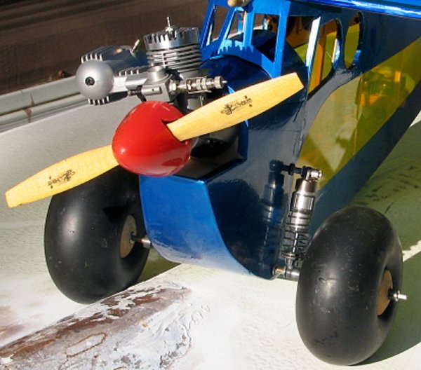

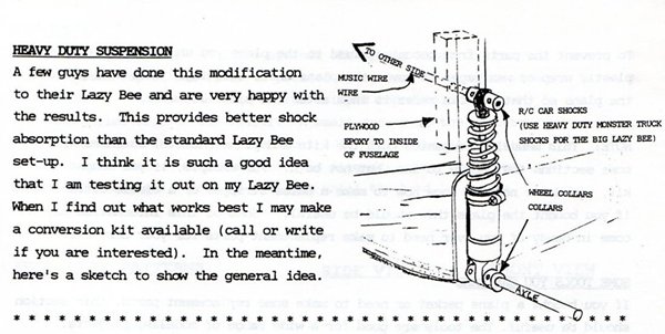

Default RE: Clancy Lazy Bee
Richard
The idea is in the Lazy Bee manual, page 8 (see picture 1). I used the A721 HPI Super Shock 50-66mm shocks from HPI Racing with out adding the oil, just air and left the bladder pressurized. I bought them at the local hobby shop. I made 1/8†Id brass tube and washer standoffs and 1/8†music wire for both the upper shock mount and axel, Trexler #11 wheels pumped up to just firm. Any more and they bounce pretty good. I have found that using the same wheels with the shocks landings are maybe a little smoother, not as much bounce (the LB bounces a little nearly every time). The stock gear with a little less air in the Trexlers work pretty well as “bush†tires. If you use a solid foam wheel, maybe they would be more effective, but I haven’t tried them.

Hello I am building a 40" lazy bee and I am really looking forward to flying it. Once I am done I will post pics but it is going to bee transparent yellow with black scallops. I am still debating wether to use the rc car shock mod or not. Any input?
Old 08-31-2008 | 02:31 PM
  #218
imsofaman's Avatar
Posts: 1,131
From: Hawthorne, NJ
I have always love the shock and gives it a very cool look. The rubber bands work well too. It is up to you. If it were me doing it all over again....I would go with shocks. The last time I did it....I used some Traxxas shocks and they were cheap too!
You make me wanting to build another one!!!!

I think I will go with the shock absorbers. I have an old set of trexler tires laying around too so I will use them as well. They are a size too big I think but it won't be too much extra weight and it will add to the plane's comical look! That would be cool to taxi the bee down to the water and with the oversized baloon tires and do a floating water take off. I wonder if that has ever been done?
