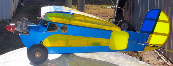

#159
Fellow Bee Fans,
I have just completed my Lazy Bee and am now waiting on some new batteries for the radio to fly it. Specs. are; Built from plans, 40" wing, Enya .15 or Thunder Tiger .25 (shown), shock absorbing landing gear, Trexler #11 wheels extended elevator tips, balanced flight control surfaces, JR Century 7 Tx, Hitec 555 Rx, 3 Cirrus CS-31 servos, 600 ma batt pack, Trans. Blue and Trans. Yellow on open areas, Met. Blue on solid surfaces. All up weight (dry) is 2 lbs. 8.5 oz. Of course, I had help holding down the plans. Merry Christmas everyone.

Skylarkmk1,
You may want to add some downthrust to your engine. It will want to nose up past 1/4 throttle, been there....done that.
I have top tell you.....that is one sweet looking Bee......all the things I love in a bee you have on yours! The "11 Trexlers and the car shocks just do it for me! The colors look great too....nice job bro. I would like to build another one day.....just not enough time....my gyros come first right now. I will fly vicariously thru everyone else's Bees here on RCU. Keep it up guys!!!!!

Dave,
I noticed the thrust line also after I took the picture, it has been fixed. The fire wall is at right angles to the top of the fuselage. With the top of the fuse level (zero degrees) the engine (and stab) also read zero (according to my Robarts Incidence meter). I have now added down thrust of about 3 degrees to start with, will need to fly to find out if it needs any more/less. Usually, any flat bottom wing will climb with the application of power above a certain trimmed out power setting, we will see. You have some neat looking "Bees" of your own. What did you make your "Sylvester" out of, looks like some kind of foam. I need to do a "Snoopy" for another project.

FBFs,
Should have posted this picture with the others on post 159, so here it is. During construction, wanting to be safe, I had my rudder and fuselage given a "CAT" scan from nose to tail by one of my helpers. Didn't sniff out any problems and everything was completed just fine
