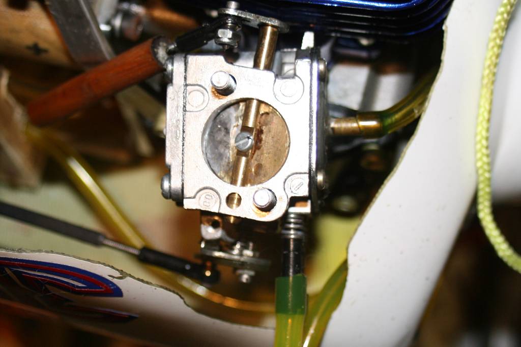

This is the way I tune my motors and you want to do this mod to your carb:
1.Start the engine, set the throttle so the engine is going 3500 rpm.
2.With the engine running I turn the "L" needle in, it is always the needle that is closest to the engine, when the engine speeds up to 4000 rpm I adjust the throttle to bring it back to 3500 rpm. You keep repeating this step until your engine doesn't speed up anymore when you turn the "L" needle in.
3.Turn the "L" needle out 3/16th of a turn.
4.Open the "H" needle 2 turns out, open the throttle all the way open. Now slowly turn the "H" needle in the engine will increase in rpms. Turn the needle about 1/16 at a time, when you get no more increase in rpm the "H" is set properly.
5.Set you idle speed with your throttle trims, it's best to take the idle stop screw completely out, you should have it so the idle is correct with the trim in the middle, and the low trim kills the engine.
6.With the engine running at the idle speed that you fly at you should now be able to snap the throttle open and the engine quickly speed up. If it just dies, turn the "L" needle out 1/16th of a turn, repeat this step until is quickly speeds up. If when you snap the throttle open it stumbles then speeds up turn the "L" needle in 1/16th of a turn until it cleanly and quickly speeds up.
7.Close the hole or notch up in the choke plate, I'll post a picture of what I mean, I do it with soldiering the hole close, some use glue or a bolt.
After you modify the choke plate the way to start the engine is:
a. Close choke completely.
b. Open throttle half way.
c. Flip engine with ignition on until the engine coughs.
d. Take choke fully off.
e. Set throttle just above idle, flip until it starts, usually 3 to 5 flips.

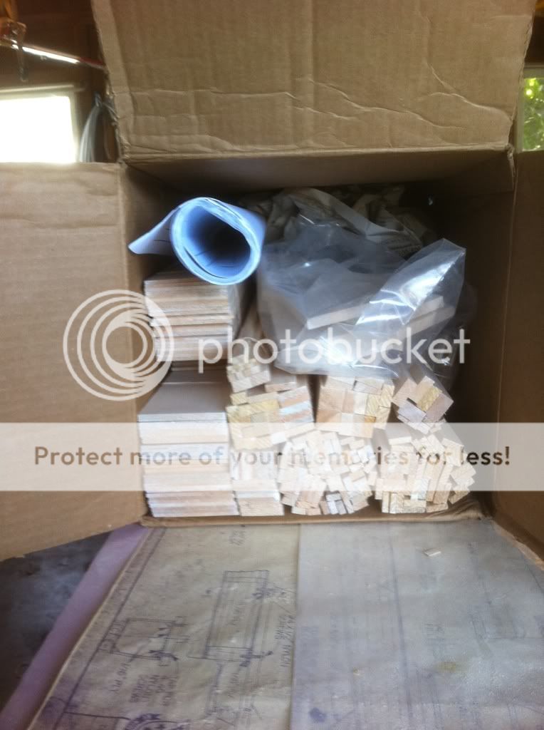

The kit finally arrived earlier today. Apparently they were having problems getting in big blocks.
There is a LOT of wood in that box. The wood seems to be super-nice, uniform density. Also more than just the ribs appear to be pre-cut, which will be nice. Getting to glance at the plans, it seems pretty straight forward.
I'm wondering, though, if I could/should add a joiner tube?

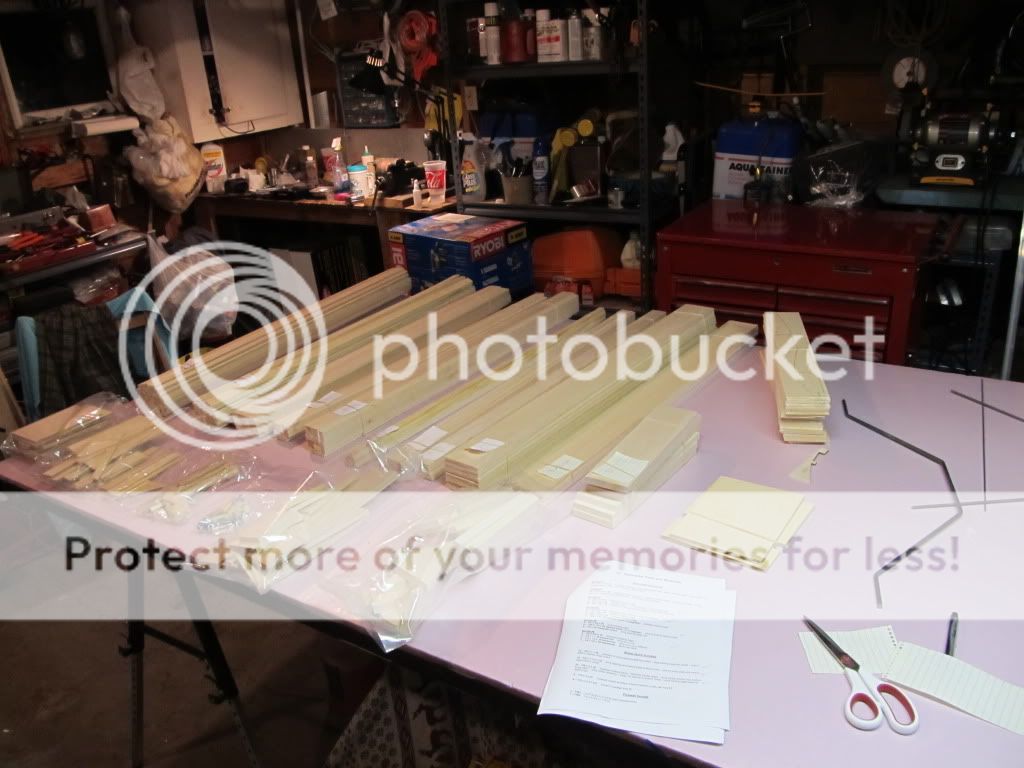

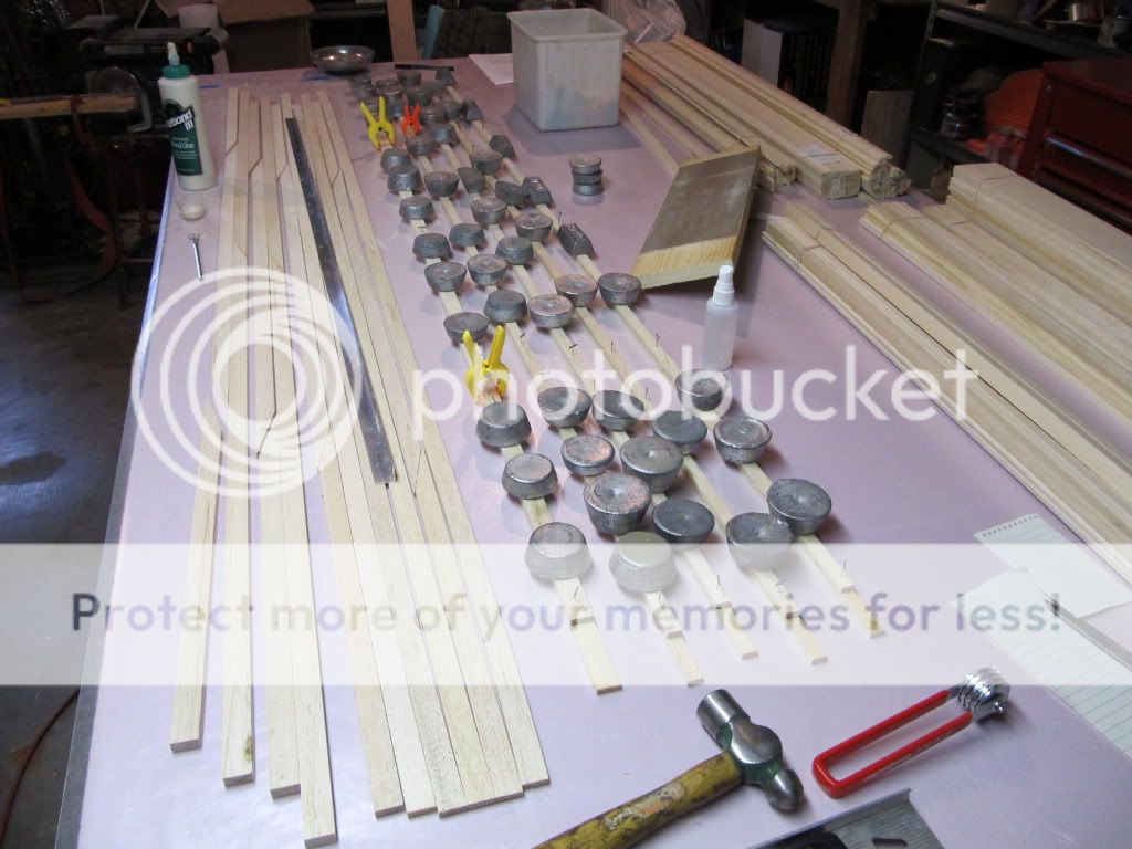

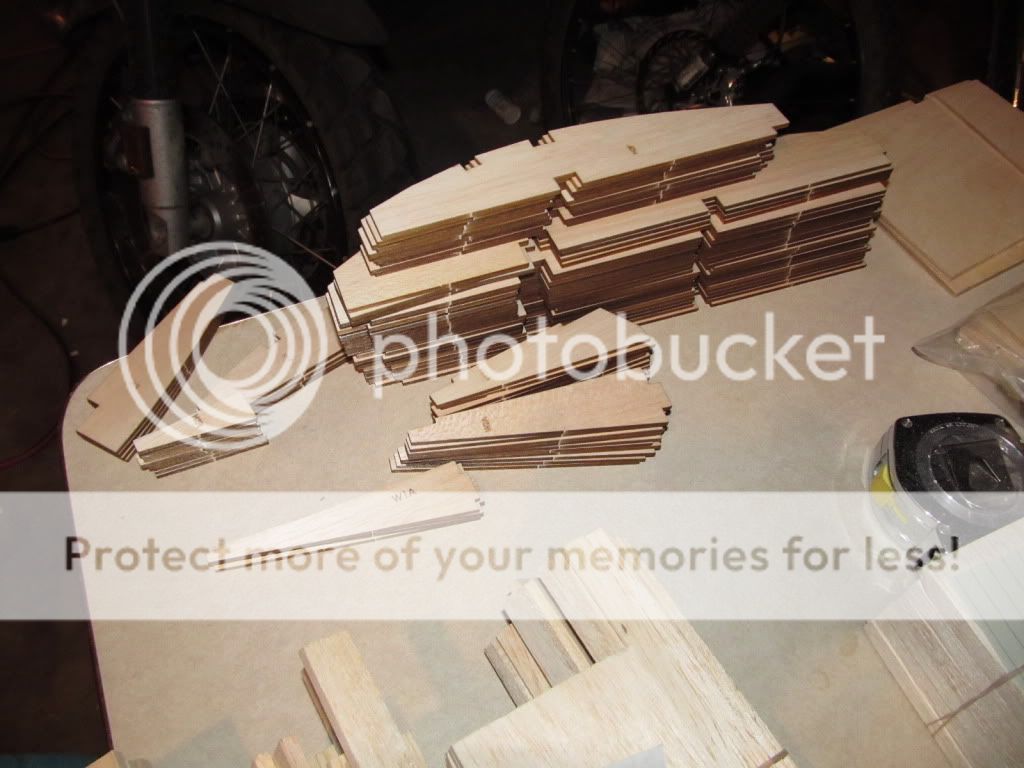

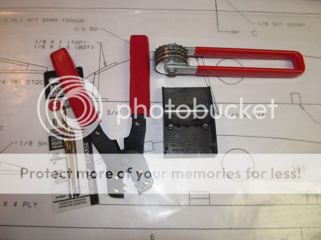

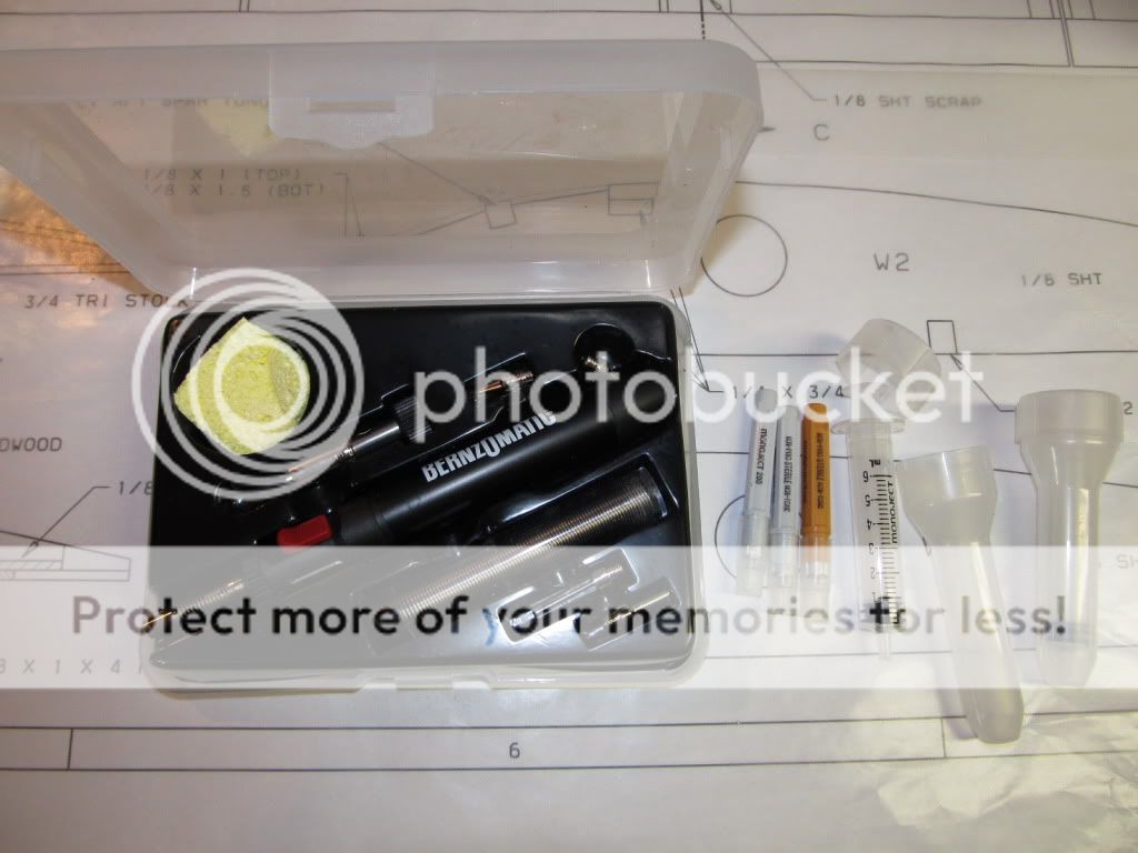

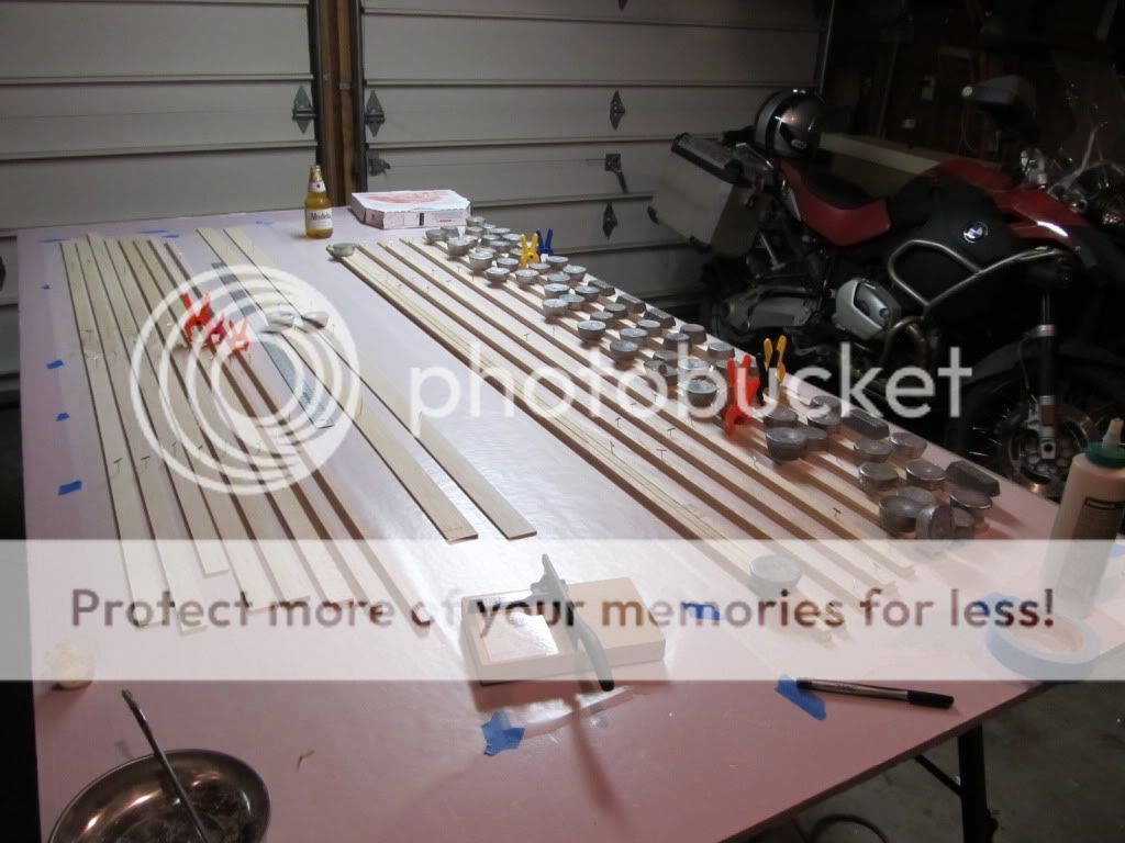

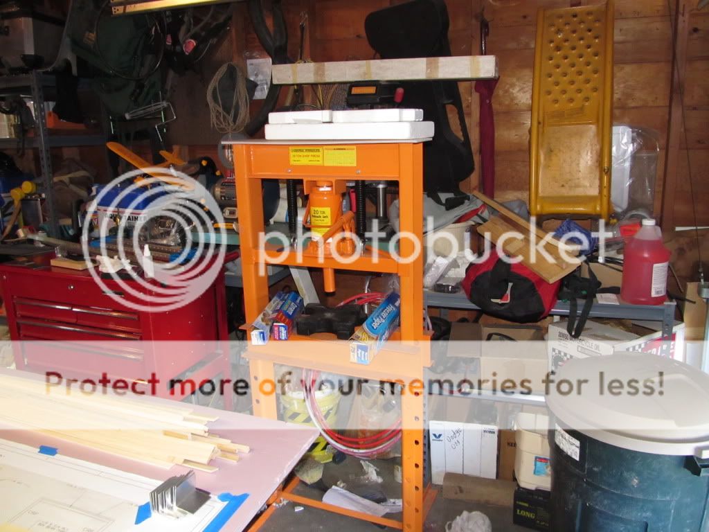

Well I had a day off, and after flying and errands I got to spend about half the day on this. Mostly getting all the wood sorted out and figuring out how it is built and what goes where. Shaped and plywood parts come bagged in groups, and sticks and sheets come bundled in groups.
Looks like adding flaps won't be too tricky.

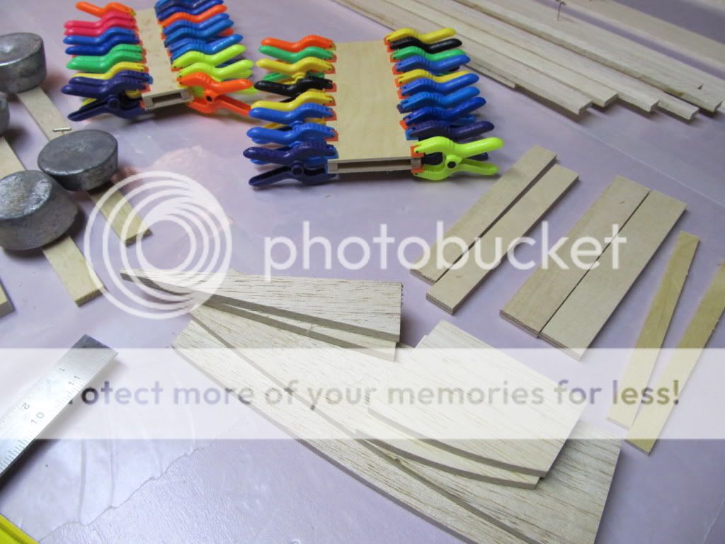

One bundle is (62) 36" 1/4x1/2 sticks...

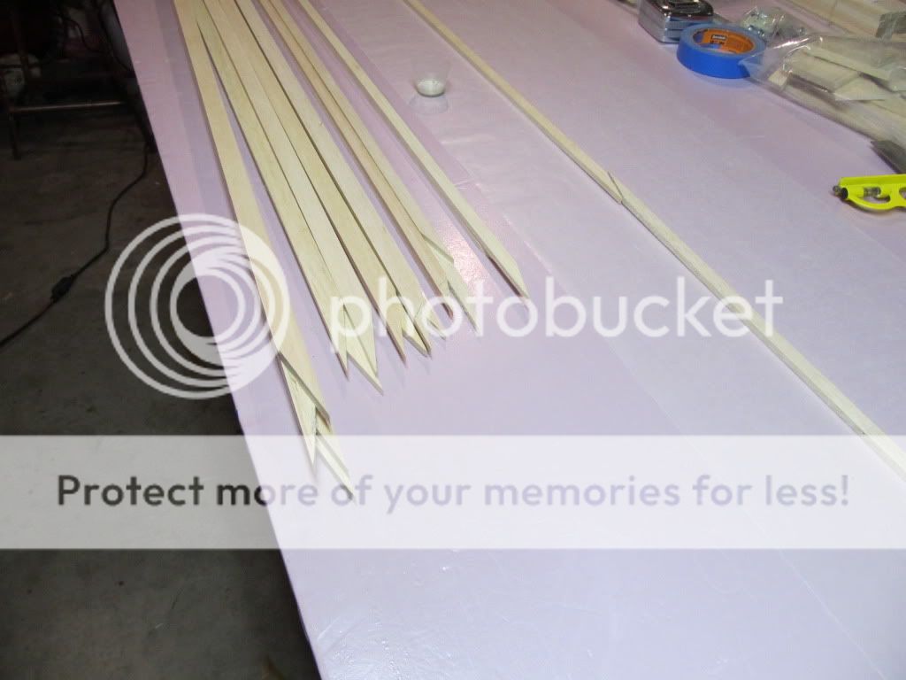

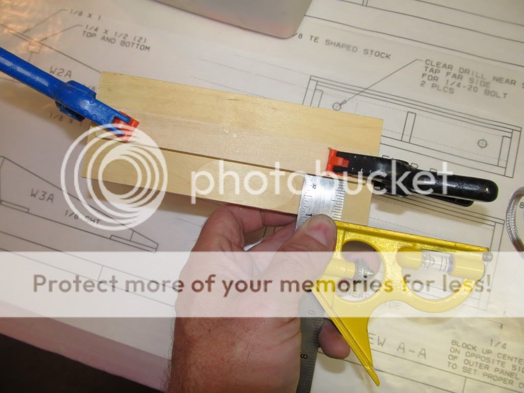

In other kits I've gotten used to cutting smaller parts out of supplied wood stock. In this kit, you combine big sticks to make really big sticks. You cut diagonals on the ends of two sticks to splice them together, then laminate another set of sticks to it with two spices, so the splices don't line up in the finished laminate.

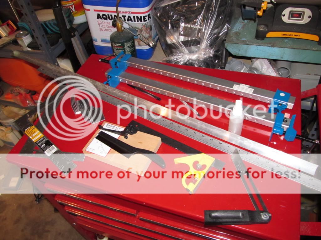

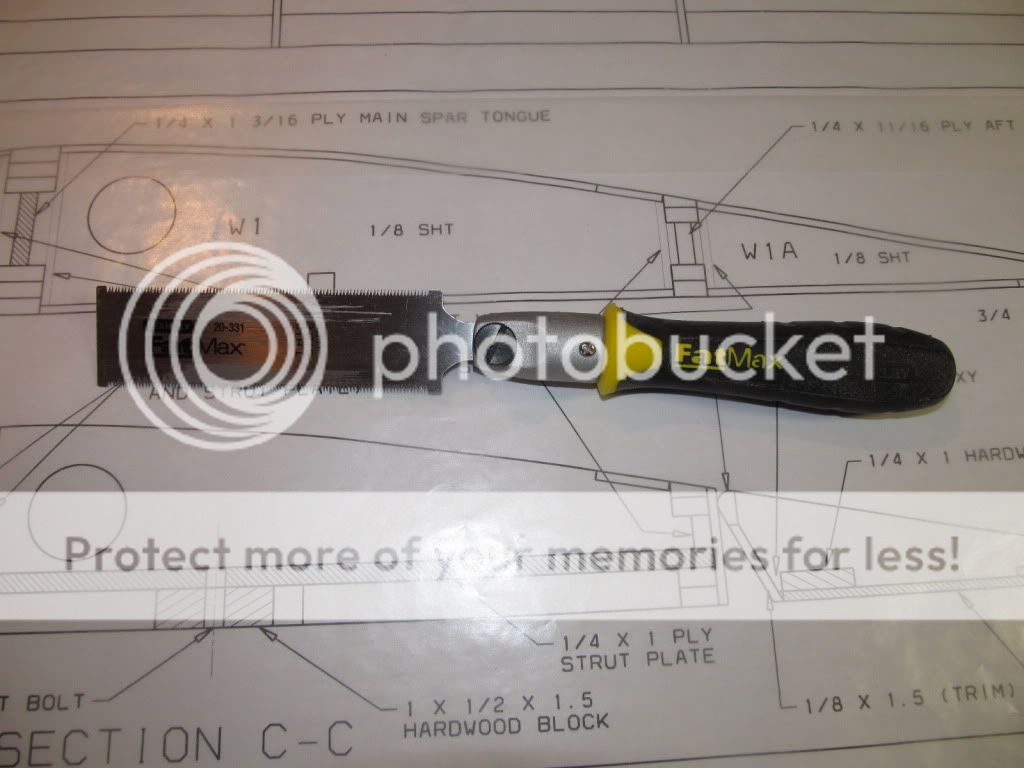

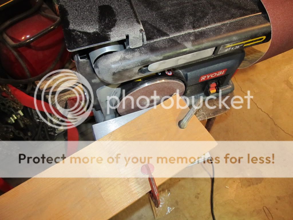

Using a miter razorback saw didn't give me the precision I wanted for a tight and strong splice (always a bit of saw wobble, magnified at that shallow of an angle). Clamping a fence on the disk sander worked much better...
Splice joints are drying now, and it is too late to run power tools in the neighborhood. Tomorrow I'll finish up building up the spars, and hopefully knock out the center section

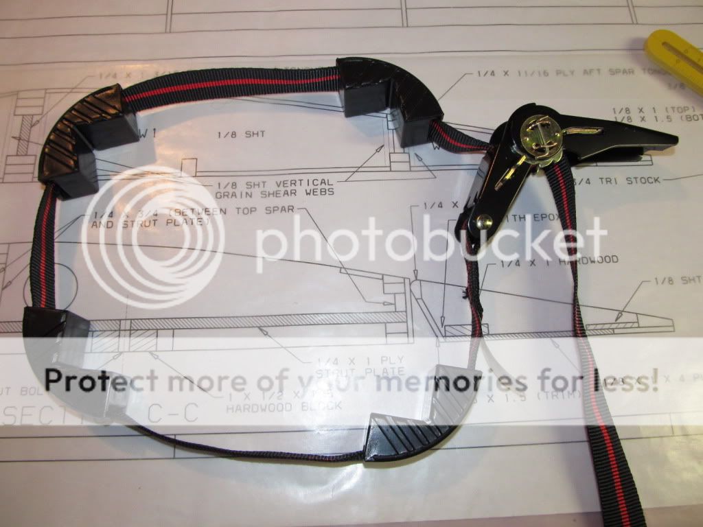

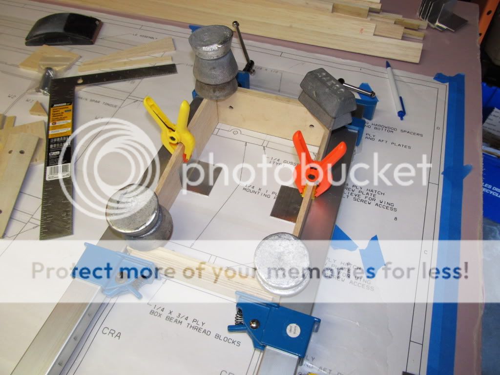

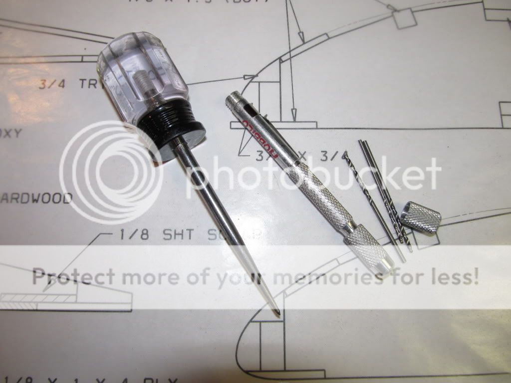

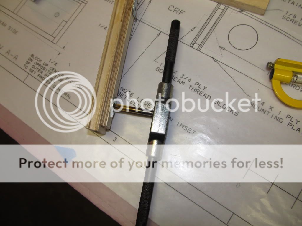

One thing that has changed from what I've seen in previous build threads is the bolts that hold the center section to the fuse, and the bolts that hold the spar joiners to the center section are now steel. I think I will also use blind nuts in addition to threading the wood.

The build board is just a couple of doors joined below with extruded angle aluminum, and topped off with 1/2 inch foam insulation (Corning, I think). The foam comes with a layer of thin plastic film lightly bonded to one side. 3M spray glue will eat the foam, so just put the side with the plastic film down. It would be nice if it were a bit stiffer, but it is cheap and easy to change.
Anyway, I didn't get as far as I had hoped today. I got up at the crack of noon (I work swing shift, and the older I get the harder it is to flip my sleep schedule on days off), and also gluing up all those laminates took me longer than I thought. Since they are critical (spars) I really took my time and paid attention to make sure they were free of voids and straight. I also used a woodpecker to perforate the surfaces a bit. Personal preference, but I think it lets the glue soak in and grip more of the wood. Having seen things break where it looked like the glue held but it pulled a "skin" of balsa off, I thought it couldn't hurt.
It also dawned on me that I should take a break to let the glue set on some of those before doing the rest, as too many lead weights might buckle or break my table. Pizza and a beer, and glued up the rest.
Clamping a board on the disk sander made really accurate splice angles. Trying to use the miter that came with it didn't work well because it had some slop, and also is a fair bit away from the disk at that angle. If the stick has a bit of curve, it would mess up the angle that way.
The only down side to that method: Balsa Boogers.
One thing had me confused. The directions list 3 six foot sticks you need to build for each wing panel, including (2) 3/4x3/4 from 3/8x3/4 sticks, but there aren't 8 pieces of 36" 3/8x3/4... Then it dawned on me, these are for the leading edge (a piece of angle stock gets glued to the front during wing construction). I went to public school, but even I figured out there is only 1 leading edge on each wing panel.
Another thing I ran into- when I set the angle for the splices I made sure it would leave the finished sticks at least as long as shown in the plan, but I didn't take into account the other side of the laminate would have two splices. Derp, musta skipped the spar splicing class in public school.
I think they are still long enough, but if not I can always add a little make-up piece to that side of the laminate, on the wingtip end where stress is low. Actually, I may change the wingtip anyway. This kit makes adding custom touches easy.

The other thing I figured I'd may as well get done is getting the ribs out and organized. They are really well cut, and are marked. Most pretty much fell out, but on a hand full the laser looked to be about 1/32" short of full penetration, so a little cutting was required.

Anyway, here are some tool shots.
I like this style for large clamps, as they will sit flat on the building board. A long straight edge is a must, and a piece of extruded aluminum angle makes a nice straight edge when you need something higher (like doing these laminate spars). Squares in several sizes are also a must-have.
The pump bottle is rubbing alcohol, which is super-handy for getting epoxy or wood glue off of things.
The sliding square is really handy to take a measurement off of a plan and transfer it to a part.
The bevel gauge is a common carpenter tool, and is handy to get an angle off of the plans and transfer a mark onto wood. I find it more accurate to take the angle off of what I'm trying to fit the part to, and use the tool to set my saw to that angle.
The razorback adjustable miter saw is super-handy.
The little pieces of aluminum are just 2" sections cut from extruded angle. They are handy for holding wing ribs and the like square (use a spring clamp) while gluing.
This is a strap clamp. I don't know if it will get used on this or not, but they are a handy thing to have around.
A butane pencil torch works well for soldering in the field. Large veterinary syringes are handy to get glue into tight spots.

The other tool is a crimper for servo connectors, though I think I'll get one of the really nice ones.
Flex saw is handy for cutting something flush with a surface. I rarely use it for planes.
An awl is handy for making dents to make sure a drill starts where you intend. The other tool is a pen drill.
20 Ton hydraulic press. Haven't found a use for it with RC planes, other than being in the way of the drill press, which is a must for making accurate and square holes.

Today I did some other things, but I did get the laminates cleaned up with a block sander and inspected. Only two needed a bit of touch-up.
The box beams get a block of ply epoxied down, for the wing bolts to thread into. This shows how I was talking about using a sliding square to get the block located at the height shown on the plan.
Once those are dry, I used the same method to locate the center of the holes for the bolts. Ply is easy to splinter on drill exit, so I like to drill a small pilot hole and drill part way from each side. I bored it to #7, then opened up the other side to 1/4, and then drilled the thread block to 5/16 setting the drill depth to the depth of a blind nut.
IMHO threading into wood tends to strip at some point, and the backs of these blocks will be sheeted in, so I thought I'd use blind nuts now.
I stuck some 1/4 ply into the box beam so I wouldn't crush it, and used a bench vice (to get them totally straight) lined with a rag to press the blind nuts in part way. Then glue behind the blind nuts, and press them home.
Then I tapped the remaining wood thickness through the blind nut, to get the threads in phase.
The bottom screw plates got drilled to 1/4.
Front and rear box beams then get glued to the center rib part with epoxy, and double checked for square.

JeffinTD , Nice selection of tools . I noticed the press also . I have an older 20ton press that comes in handy for straightening crankshafts and pressing bearings in/out among a lot of other uses.
