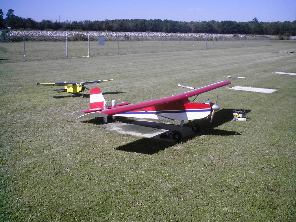

Hey Jeff,
I've been lurking around and watching your build of this fantastic flying plane. My Giant flys so smooth and slow she always draws a crowd. If I can figure out how I'm going to try to post a picture of her so you can see that ALL that work really pays off. My Avatar is a Senior Telemaster and if the picture loaded in the background is my beater. A 40 size Telemaster that has MANY hours and not so nice landings...LOL You are doing a GREAT job on your Giant and she'll provide you many years of enjoyment. Anyway I'm wondering if I loaded the picture right so let's see....
TTYL,
Bruce

Yep, the picture worked, and that is a really nice looking plane.
Life has gotten in the way of the build for a little bit, but I hope to get back to it soon.
What engine do you have in yours?

Hey Jeff,
I've got a 26cc gas in her and the power is perfect as she will take off at about 1/3 throttle and will fly for 30 or 40 minutes on an 22 oz tank. When you build your struts be sure you understand just how much load they will be carrying. If you want I'll send you some pictures in a pm of what happens when you build them as per the plans and what we did after we learned about it...lol I don't want to post them here and create issues that are not needed on your build thread.
TTYL,
Bruce

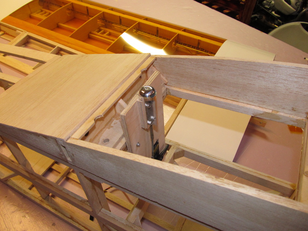

OK This thread has been dead for a while. Life got in the way a bit, and I haven't posted any updates.
Here's the 1/2" balsa windshield and flat hood area. Later in the process I decided to cut both off, and build a rounded 'Hood' and use plexiglass for a windshield.

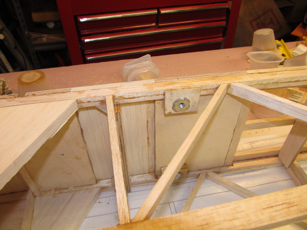

Old 08-11-2015 | 01:28 PM
  #133
Joined: Apr 2011
Posts: 510
From: The Dalles, OR
Another shot of the flat "hood" and cheeks, that were cut off...
Here's a shot of the strut attach points. I added a bit of ply to go over the top of the longeron, and used a blind nut to make sure things are strong.
Mount points on the wing got the same treatment. Counter bored the hole for a blind nut, then ran a tap through the T nut so the wood would also be threaded, and clocked to the steel threads of the T nut.
In the photo you can also see LED's mounted inside the wing, and clear plastic tubes for servo wire guides (the tubes oxy aceteline welding rod comes in).

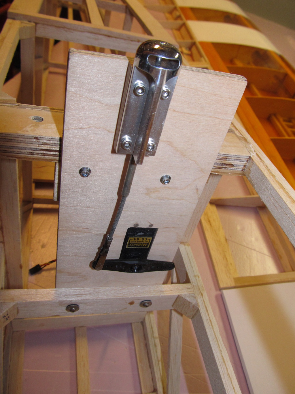

Here's the glider release. It is mounted to the fuse via screws on the top into the structure the wing mounts to, and on the bottom it has 4-40 allen screws into T nuts.
ID:	2113966   Click image for larger version

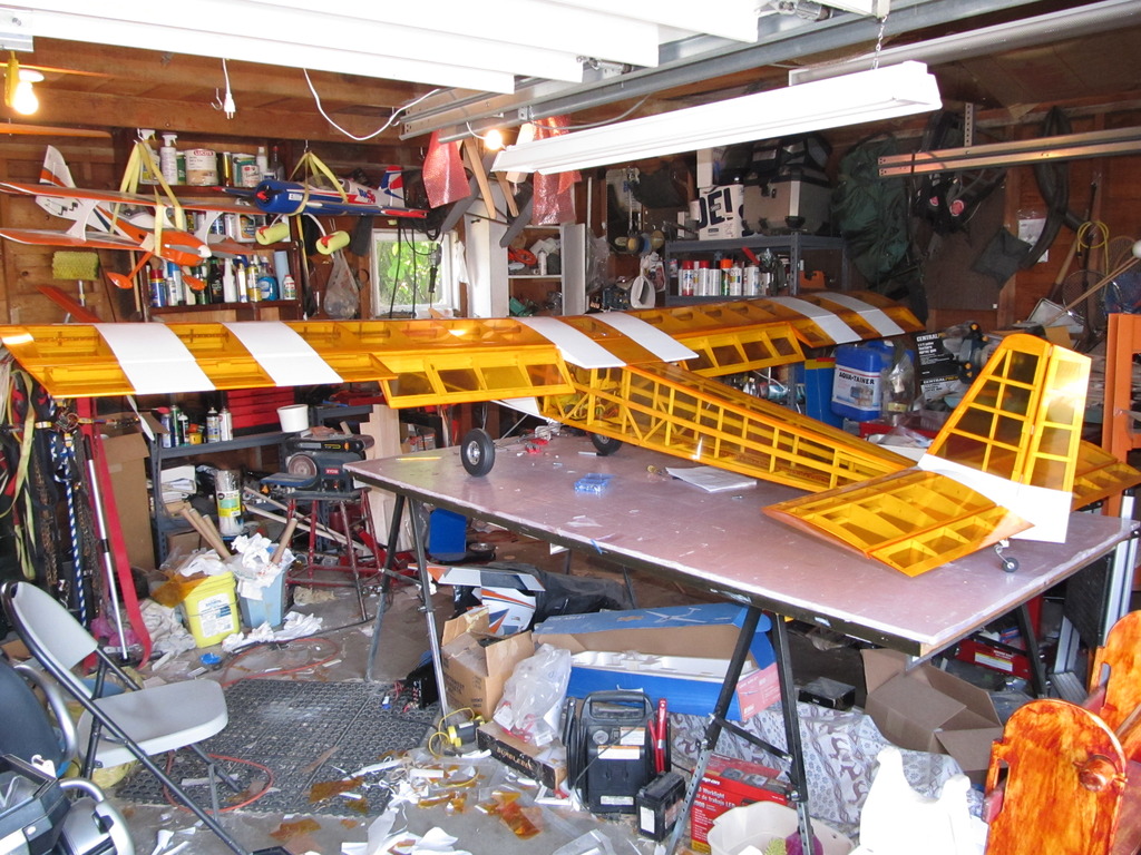

Another shot of the glider release. Braided steel cable soldered into a clevis on one end and soldered to a coupler to the rod.
I made a change in plan for the power plant, and with help from a friend (thanks Phil), I felt comfortable cutting off most of the cheeks and the hood.
Should provide lower vibration, and I have another plane the DLE55 with pitts will be perfect for.
Finally started covering. Transparent orange ultracoat with white trim. You can see the clear plastic tube for servo wires, and LEDs inside.
This shows the servo installation and 4-40 control rods with solder on clevis. I went with the control horns shown because they had enough reach to have the pivot point in line with the hinge line.

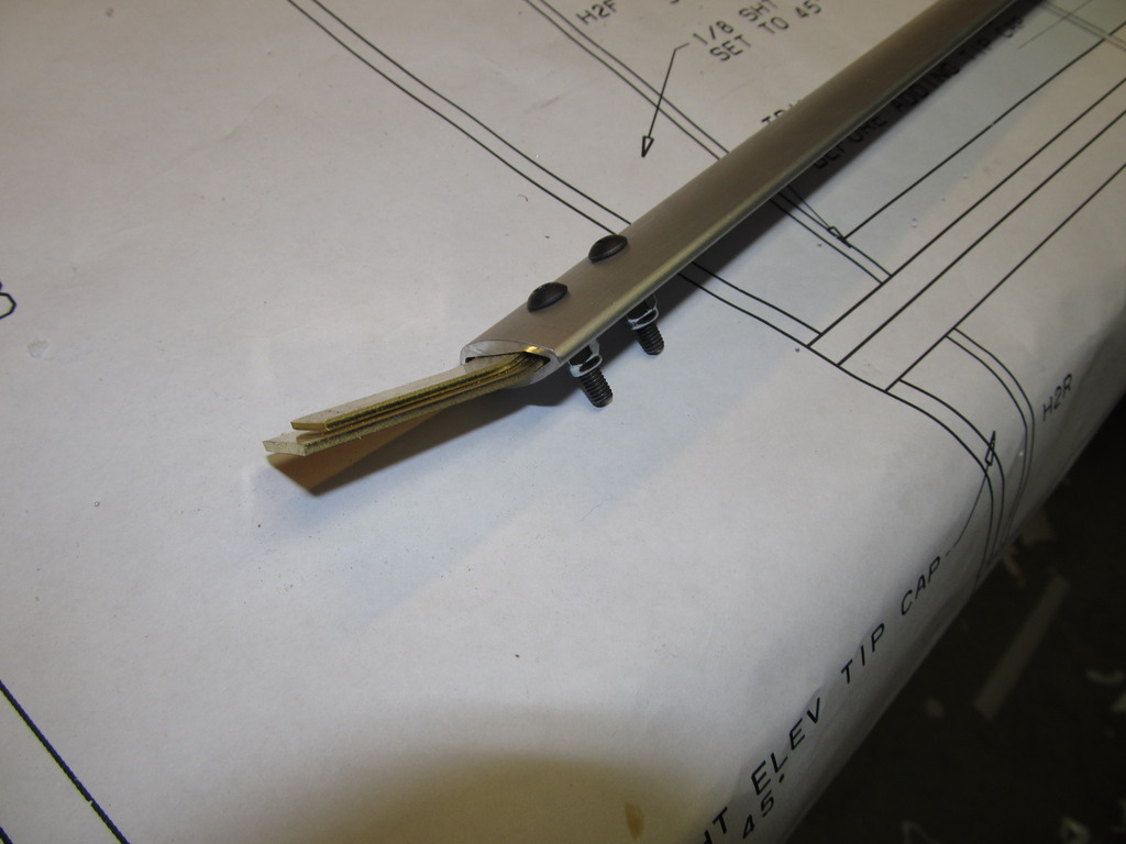

Here is a shot of what I did for struts. The aluminum is from the link someone provided a few pages back. They are intended for jury struts for man carrying airplanes (light sport). To take up the room in the middle, I doubled up the brass tab that came in the kit with a 2nd piece of wider brass purchased at the hardware store and bent to the same angle in the vice. Allen cap screws with nylock nuts. Will later cut off the excess bolt and touch them up on the bench grinder, along with rounding off the corners of the brass tabs- and painting them white. Super strong without adding much weight, and hopefully if one of the brass pieces ever fractures, the 2nd will be strong enough until the problem is noticed and repaired.

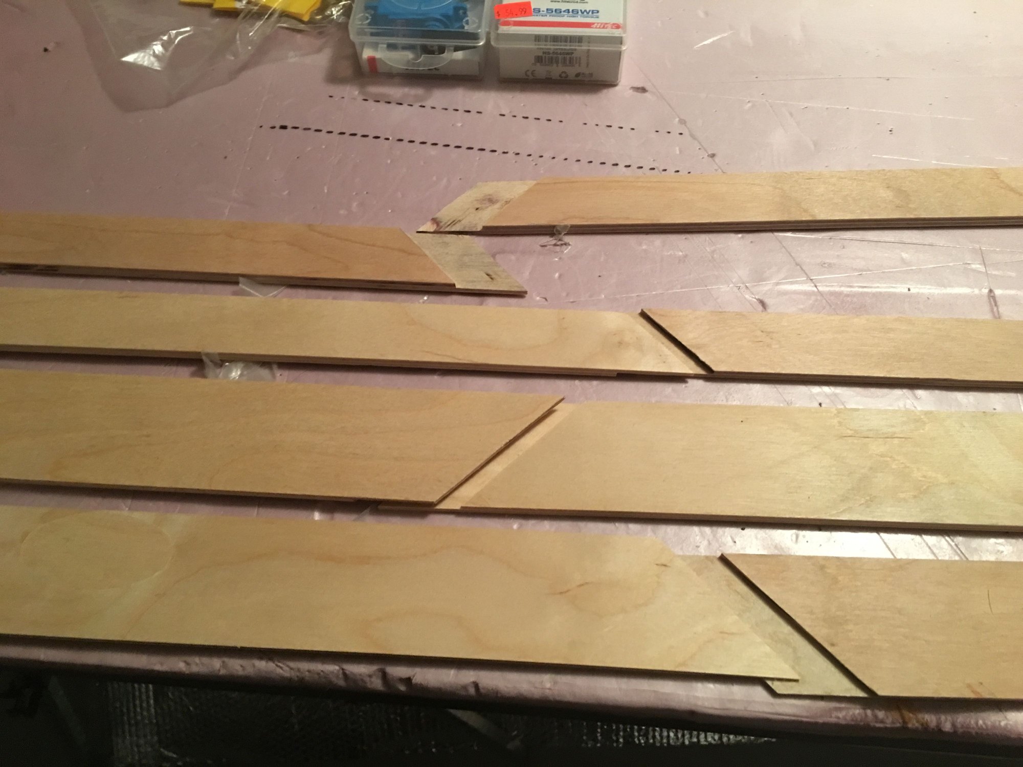

Splicing pieces for the plywood spines in foam core floats.
Here is how the joints turned out for the plywood pieces. Should be pretty strong.
