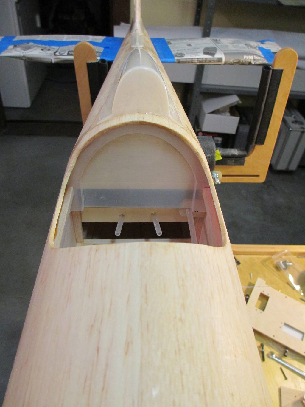

Very clever Jaybird, that should work out nicely. The Ryan has really cleaned up well and is looking a lot better now with some TLC. Good Job. I am now working on the same with mine. I am in the process of joining the two wheel pants together.
Here is a shot of the rear cockpit wall cover thatI fit earlier. It is not epoxied in placeas I will paint it before installing it permamently. I will be installing onlythe back of the seat to this wall later as I will need access to the on/off charge jackswitch that I located at the bottom of the cockpit floor.

I could install just the upper torso/bust of a pilot only as the pull-pull cables are in the way. I could get creative with I suppose a magnet that would allow me to remove the pilot to have access to the switch, we'll see...

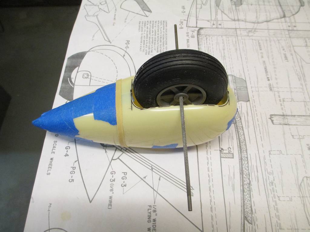

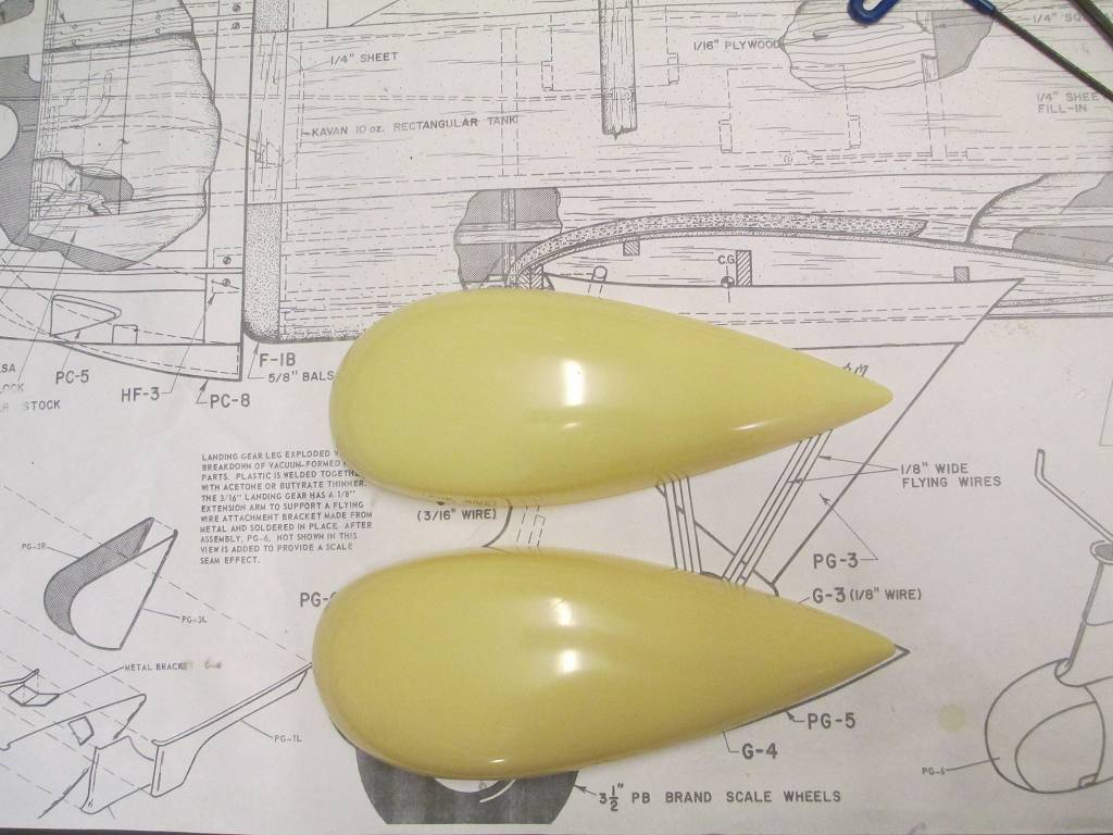

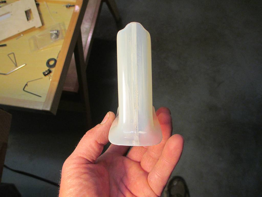

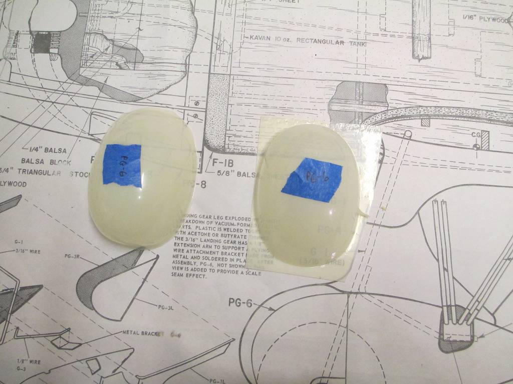

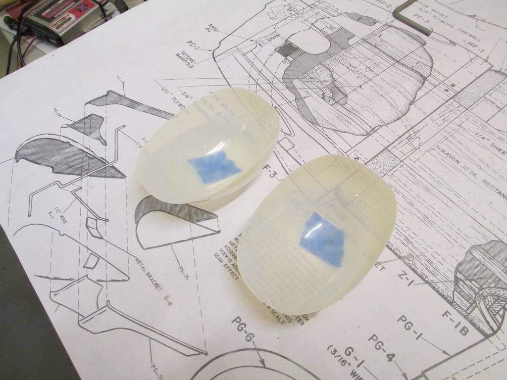

I normally do what most do when it comes time to installing plastic parts such as cowls and wheel pants that are supplied in the kit. Pitch them for a higher quality and quicker fiberglass substitute. I did exactly that on the cowl but on the wheel pants and spats I have decided to give the "original" supplied by kit a try. So here I go let's see how they'll turn out.
<u>
Part 1 Wheel Pant Fabrication
</u>The journey begins with the selection of wheels for the plane. You can see thatI have chosen 3-1/2" Sullivan SkyLites. Next I took the wheel pant halves and taped them together so I could transfer the dimension that I wanted to both halves. Using my Dremel tool, I made an opening in the pant halvesnext to but not on the line that I drew. The tape held the halves together well and you can see how they came out. The last photo shows the amount of clearance that I have surrounding the wheel.
Note: The wheel will sit considerably lower in the pant for the final assembly.

<u>Part 2 Wheel Pant Fabrication
</u>After having the bottoms of both wheel pants opened up to receive their respective wheels next was to remove parts PG-6 from the ABS vacuum formed sheets. These are the front wheel caps which are secured to the front of the wheel pant halves.Bonding the ABS plastic together is best accomplished using Acetone. Using a small brush or in my case I used a Q-tip you just flow a few drops of the Acetone under the edges. It will spread along the seams by capilary action. Sort of like sweating copper pipes together. Just hold the pieces for a minute or two and the pieces become bonded together making one. You do have to be careful not to flood the area or you will melt everything! So practicing on some scraps is in order to see just how the Acetone will react to the plastic is wise.
I only secured the front portion of the pants as Imay need to spread the back sections slightly to get the landing gear wire through.

<u>Part 3 Wheel Pant/Spat Fabrication
</u>What you see are before and after pictures of the wheel pant fairing, in left and right halves for one side. Instead ofbutting the seams together I overlaped the seams as this better duplicates the full scale version. From cutting the halves out of its vacuum formed sheet to what you see in my hand took me the better part of three hours. ( Maybe this is one of the reasons that most opt for the fiberglass completed version.)

<u>Part4 Wheel Pant/Spat Fabrication
</u>
Last nights work was bonded to the wheel pant once again using Acetone.After drying, measurements were taken to determine where the openings within the fairing needed to goto allowthe landing gear wire to pass through.Not bonding the entire perimiter of the wheel pant proved to be a wise move as I did have to spread thehalves apart to slip the landing gear wire through. I still have to solder a bracket to the rear ofthe wheel pant where you see a small side opening. This will be to attatch the support wiresfrom the wing and fuse to the wheel minimizing lateral movement. All in all its getting there...I have an idea thatimprovesmounting therear bracket to the landing gear wire,which I will fabricate and show you tomorrow evening.
