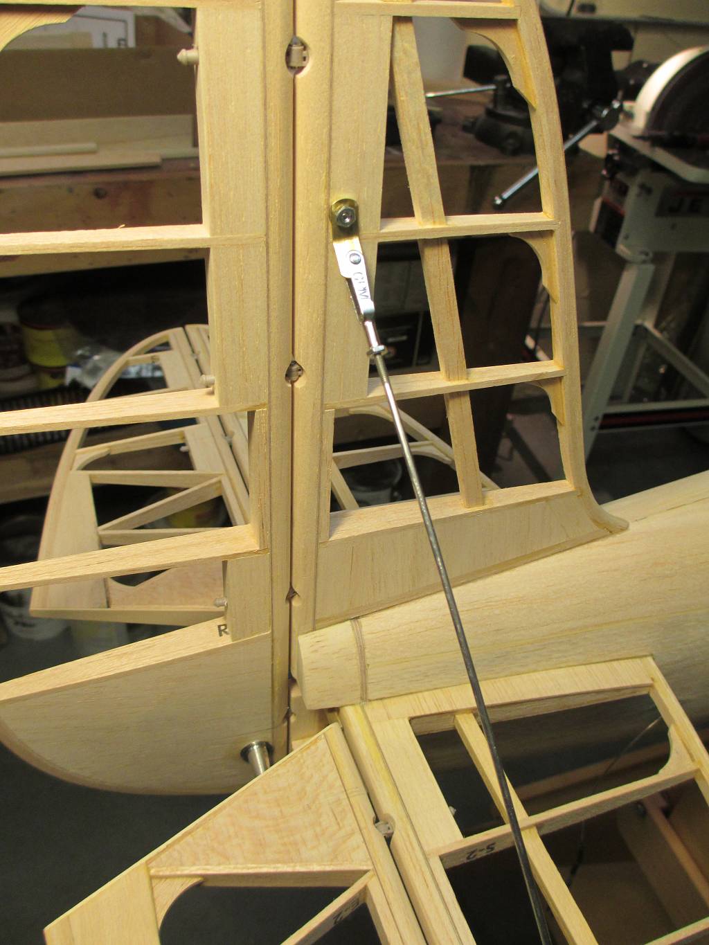

Couple of things that I'd like to show you, first it occured to methat I never showed youa photo of the completed tailwheel. Second you can peek into the bottom of my cowland see how Iran the fuel ventline.Isoldered up some tubing and some flat stock to have a more than adequate vent line.
All of the fuel lines have been completed, I'm waiting for tomorrow's mail because I has mis-measured on the links for the ailerons. Oh and by the way...I"MDONE ! The next time you see "Private Ryan" she will be as one....complete and ready for flight.

Thanks for the pics of the tail gear area. I am having trouble with understanding what goes on there. At the very back end of the fuse the plans call for a ABS fairing part PF-2 and PF-3 right and left. The plans aren't very clear how these two fairings are installed. Looking at your pics I also can't tell if you used them or not. Could you explain what you did in that area?
Hope that made sence.
Appreciate it,

Another question. Please forgive me. I hope you don't mind the questions.
In your post #230 you indicate your method for installing the Robart hinges. As you know the joint between the wing trailing edge and the aileron leading edge is not a conventional joint. The pivot point for the hinges has to be set into the aileron quite a bit for the joint to swivel properly. The hinges that are built from the plans have their pivot point right at the back side of the aileron leading edge wood. Looking at your pics of the depth you made your pockets looks like the Robart hinge pivot is well in front of the back side of the leading edge wood.
My question...Did the pivot point location work OK for proper movement of the aileron?

Tom this model has tons of plastic fairings as you know, and I used almost all of them with the exception of the two at the end of the fuse (PF2 and PF3). I chose not to use them and rather carve them from solid balsa to give memore gluing area to better hold the tail fin on. More photos can be found on page #19, Post #464. If you do choose to use the method I used then make sure to taper the ends a bit, it will allow for more left and right rudder deflection. I left mine flat and though I have ample rudder movement it would be a change that I would make if I were to build this model again. I left mine flat because initially I wasn't going to put the plastic covers on the left and right sides of the rudder. Without these pieces I had extreme rudder deflection, however, members of this thread (rightfully so) helped me realize it would look better with these covers intact.
The hinge pockets that I made for the ailerons were a bit tricky but gave me the movement that I was looking for. I didn't measure the angle as I went by eye, I will measure the angle later.

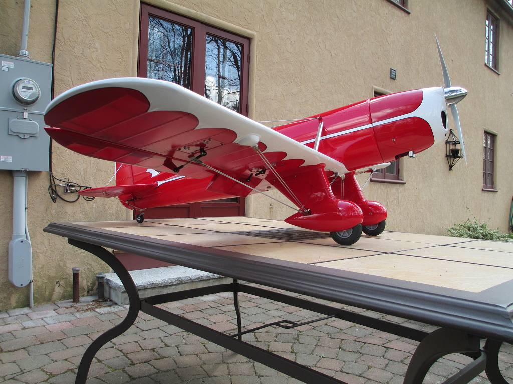

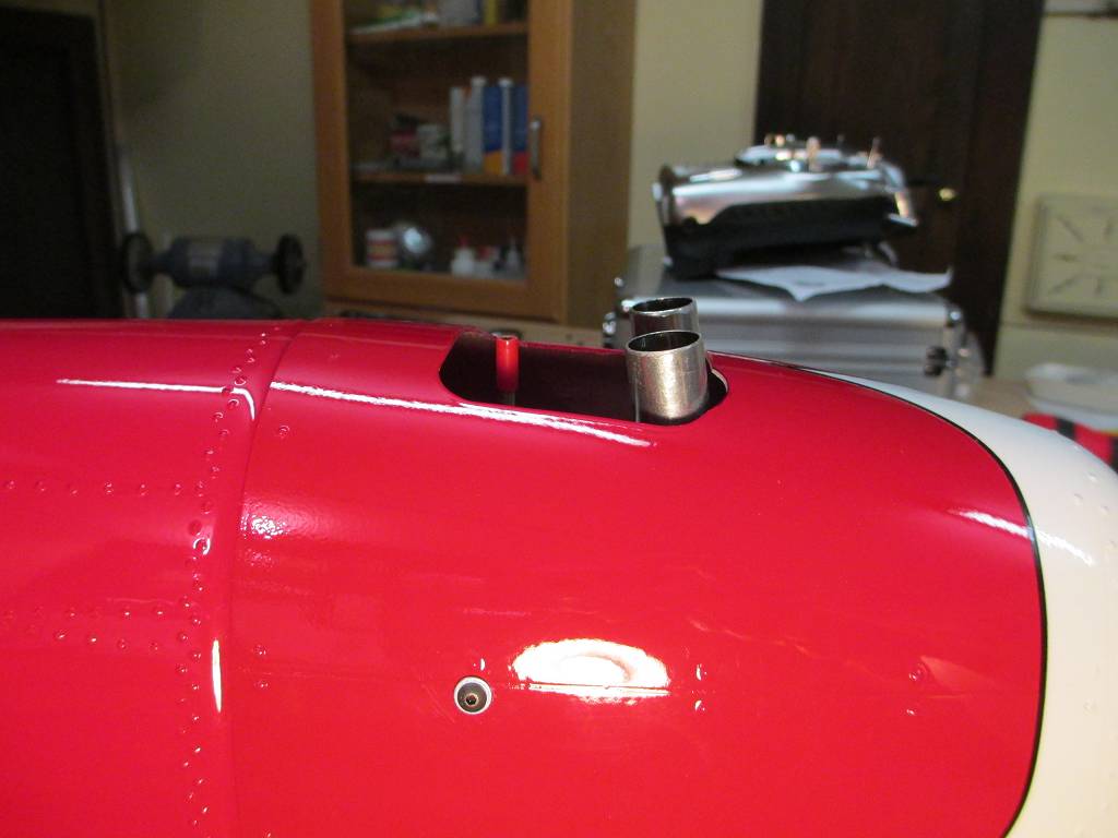

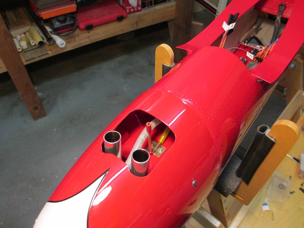

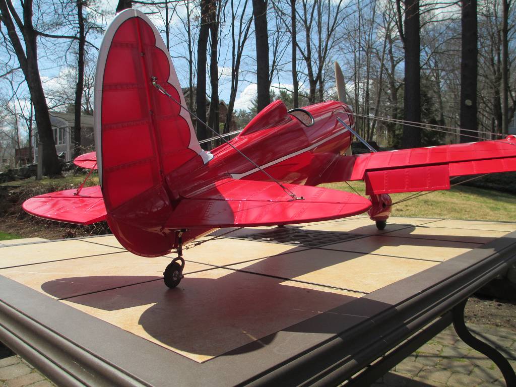

Thanks all for the praise, it's well appriciated. Tim a little too soon for the maiden, not rushing it but it will be soon...
And now without delay may I present to you <span style="font-size: larger">"Private Ryan"</span>...
