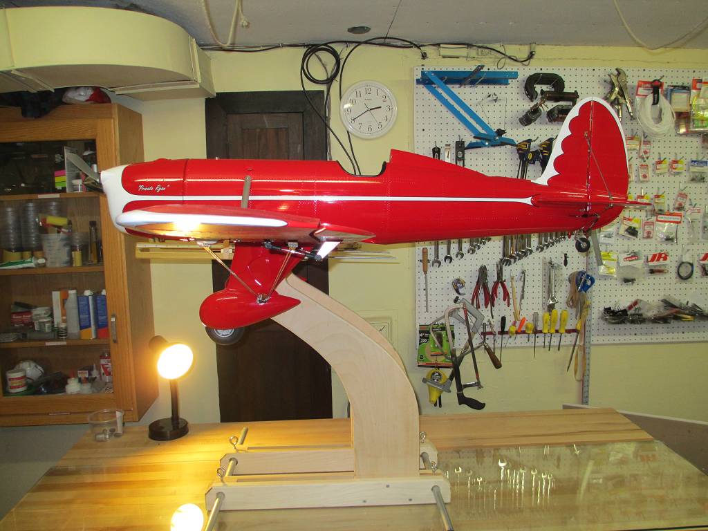

Ok - How often does this happen!Today I decidedto check the CG of "Private Ryan". As you can see PR was anxiously awaiting forher to be placed on the balancer, I checked the plans for the recommended CG which is 3-3/8" back from the leading edge. I set the balancer to exactly 3-3/8" and leveled the balance arms. Holding my breath, I gently placed her on her perch, are you kidding me "Dead Nuts" as you can see.

I love the CG machine, did you make that too? Isee you have one of the otherEZ balancershanging on the wall. I made one similer to yours, but yours is infinitly nicer of course. I made a vanessa rig and that works realy well and you don't have to worry about having your plane falling off.
Old 04-29-2013 | 06:35 AM
  #1706
VincentJ's Avatar
Joined: Mar 2011
Posts: 4,994
Received 186 Likes on 166 Posts
From: Hancock, NH
Default RE: Sig Ryan STA

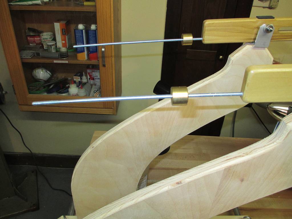

Yes Cliff, the balancer is a home built unit but I didn't do the building. A very talented member of our club made them, and started to sell them to our members for $99.00 a pop. It will take up to a 50 pound plane and it works super. I do like the EZ balancer for smaller models, however getting the plane set-up on the exact CG mark is a pain. With this home made unit it has a built in ruler with stop attatchment that allows you to place the wing's leading edge up to the stop , much easier! There are fully threaded rods on the ends of each arm with moveable weightsthat alows you to balance the arm once you made the CG adjustments on the ruler. I'll try to remember to take some close up shots of the adjustable arms.

Cliff not only does the Acetonework better, it's ton's cheaper than CA as well!
Dave, congratulations on your purchase. I hope you enjoy the build as much as I have, and yes it's definitely an old school build!
Here are some pictures of the balancer arms that I said I would photo. I will be in contact with my friend to see if he has any more balancers for sale...
