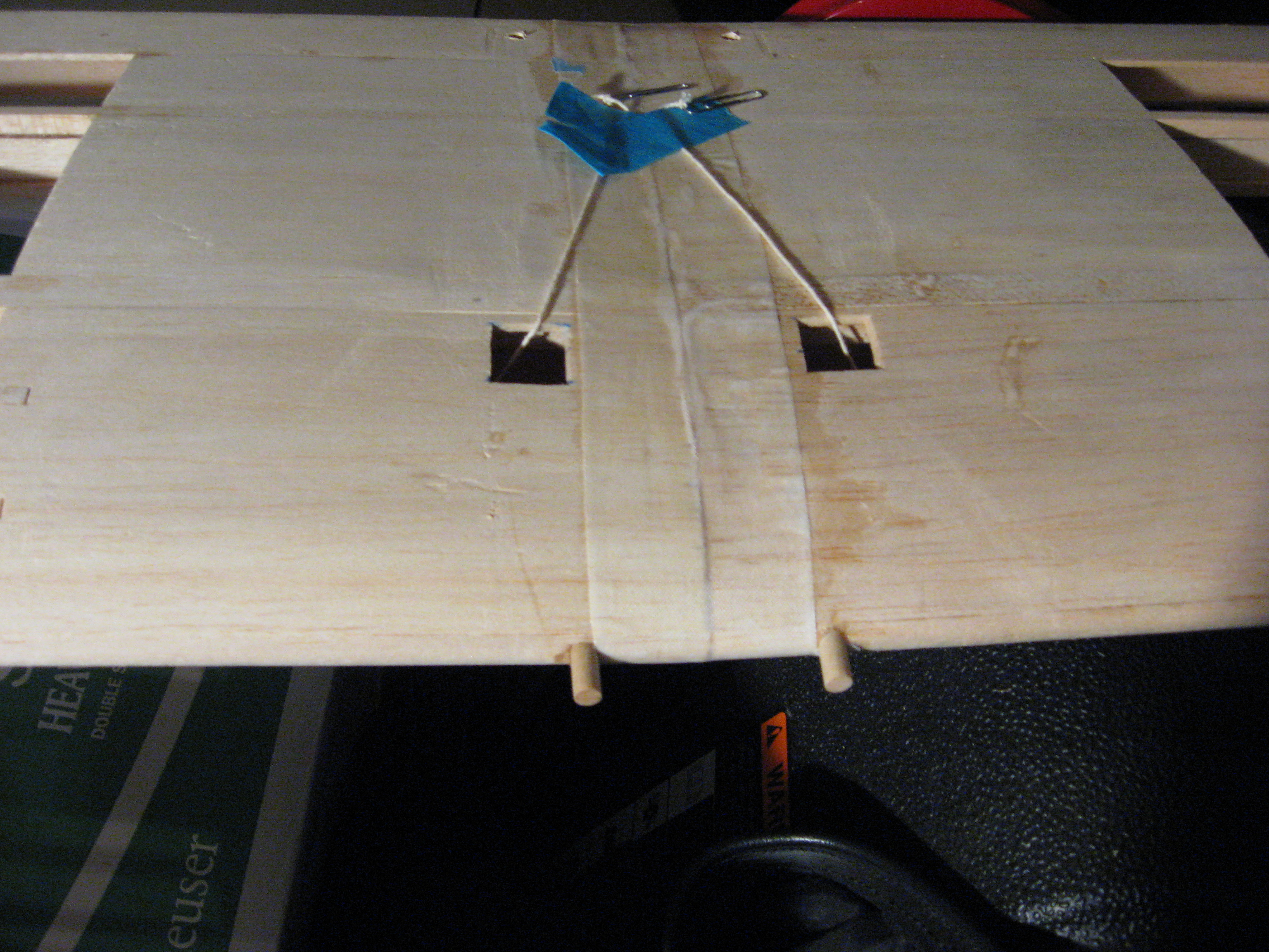

That is a picture of the leading edge of my Sig 4 Star 60. I can't wrap my mind around how to cover over the dowels on the leading edge of the wing, and still keep the piece of covering symmetrical when it wraps around the leading and under to the bottom of the wing.
I'm sure there must be a simplistic work around, but I am not that creative.
Top of wing will be yellow and wrap under the leading edge about 2" and then underside will be blue.
Planning on using ultracote.

Don't know if this will help but, my normal method of getting covering around dowels, etc is to do a 1-2" square of covering with a hole in the middle. Once the dowel is surrounded by that square the rest is usually easy to work with. Being that your covering will be the same color top & bottom, at least for a little bit, this should work decently.

yup, I agree for nitro powered airplanes, I fuel proof that entire area with epoxy or epoxy paint first (since it's not seen with the airplane assembled)
add a couple of small pieces of covering as described, then cover the rest.
(I usually do tips/aileron cutouts/etc that same way as well.)

Cut a 3/8" hole in the covering at the appropriate location and slip over the dowel. You are going to have a seam at the wing center so you only have to worry about one dowel at a time. Speaking of the wing center, I couldn't help but noticing the void in the glass at the wing center. Unfortunately that void eliminates any strength that the glass is supposed to provide. I also like to extend the glass out past the fuse sides so that the wing sheeting will not get dented by the fuse sides. Under vibration the wing sheeting tends to get eaten up.

The simplistic work around is simply to do like the control surfaces hinges; do not glue them in until the covering is done. Same with the installation of horns on control surfaces . . . install them then remove them for covering and reinstall them (usually screws in this case).
You already had ideas from others. Another way is to cut them at the leading edge, redrill the holes, do the covering and install new dowels.

+1 on that Zor, I always wait to install the wing dowels until after the covering is completed.

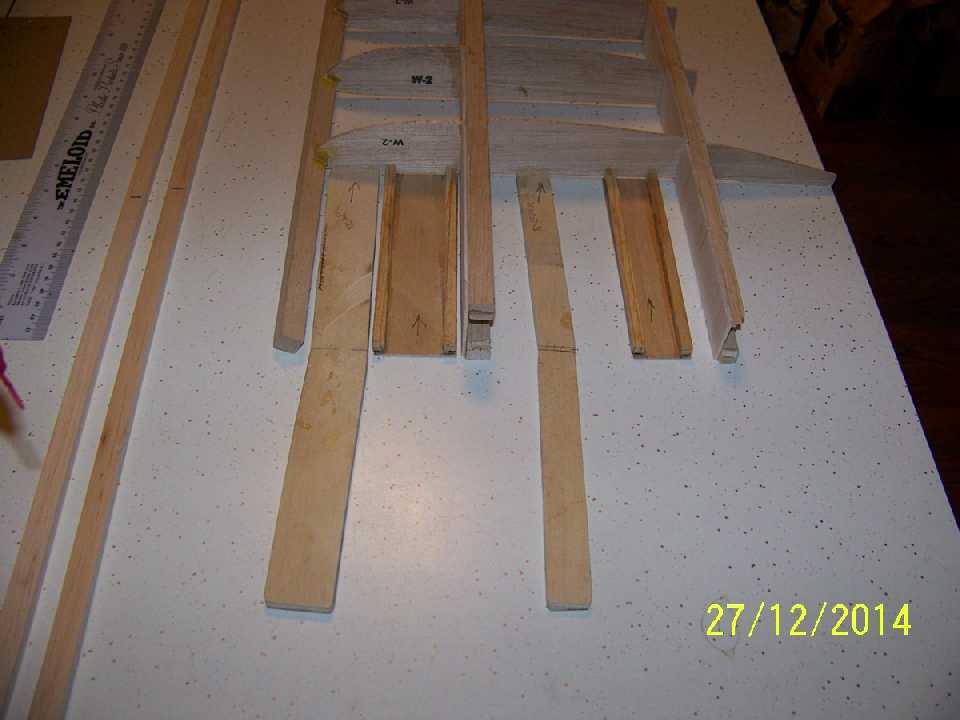

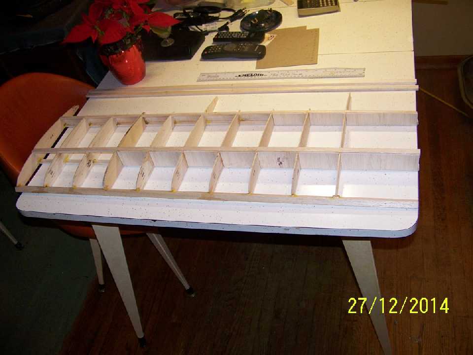

Here are a few modifications I am making _ _ _
1- Making the wings joined at their root with laminated joiners ... (drawing posted and pictures of the components).
2- Adding to the wing roots so in a bad landing they resist changing dimensions at the leading edge and trailing edge. IOW (In Other Words) crushing the fuselage sides inward or pulling them outward ...
3- Providing for the wing roots to be tied to the landing gear which goes across the fuselage bottom. This to resist the wing roots to be pulled upward out of their attachment to the fuselage.
4- Provision for quick switch over from trigear to tail dragger and vice versa ... (drawing and pictures posted).
5- Installation of flaps and ailerons without any gaps of importance while being activated to 40 degrees of rotation ... (drawing posted).
6- Exteniosn of the rudder top to increase effectiveness (authority as some say) due to the increase mass in the wings with the flaps, ailerons and servos. (drawing posted) ...
7- Tail assembly bolted instead of being cemented. This to provide adjustment of the decalage angle to optimize flying characteristics ...
8- Engine (OS MAX 55 AX) to be installed inverted for nicer looking fuselage front ...
9- Removable and re-installable tail wheel 1 1/2 inch diameter when converting trigear to tail dragger ...
10- Will be covered and finished with Ceconite light and genuine aircraft dope like full size airplanes.
11- Possible other modifications as I go along _ _ _
Some of the design modifications drawings and some pictures of preliminary construction were posted in the thread mentioned above. I am now not posting any of that stuff in that thread anymore. Apparently I misjudged the intentions of that thread. I thought it was for posting kit buildinng and in particular for Kadet kit building.
