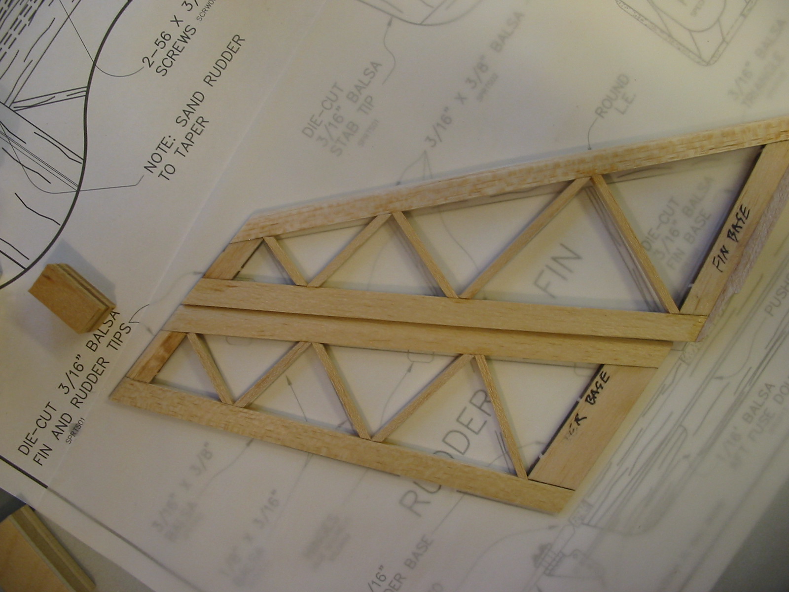

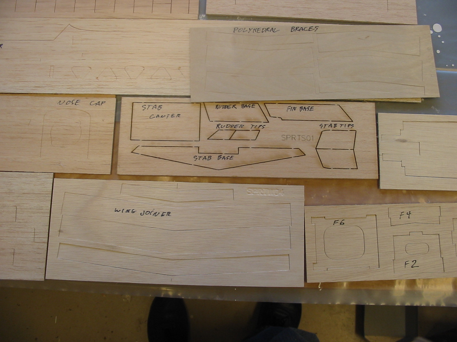

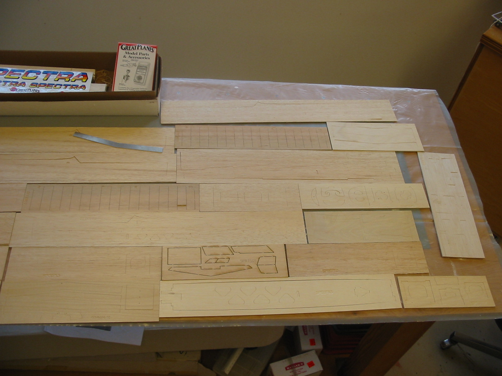

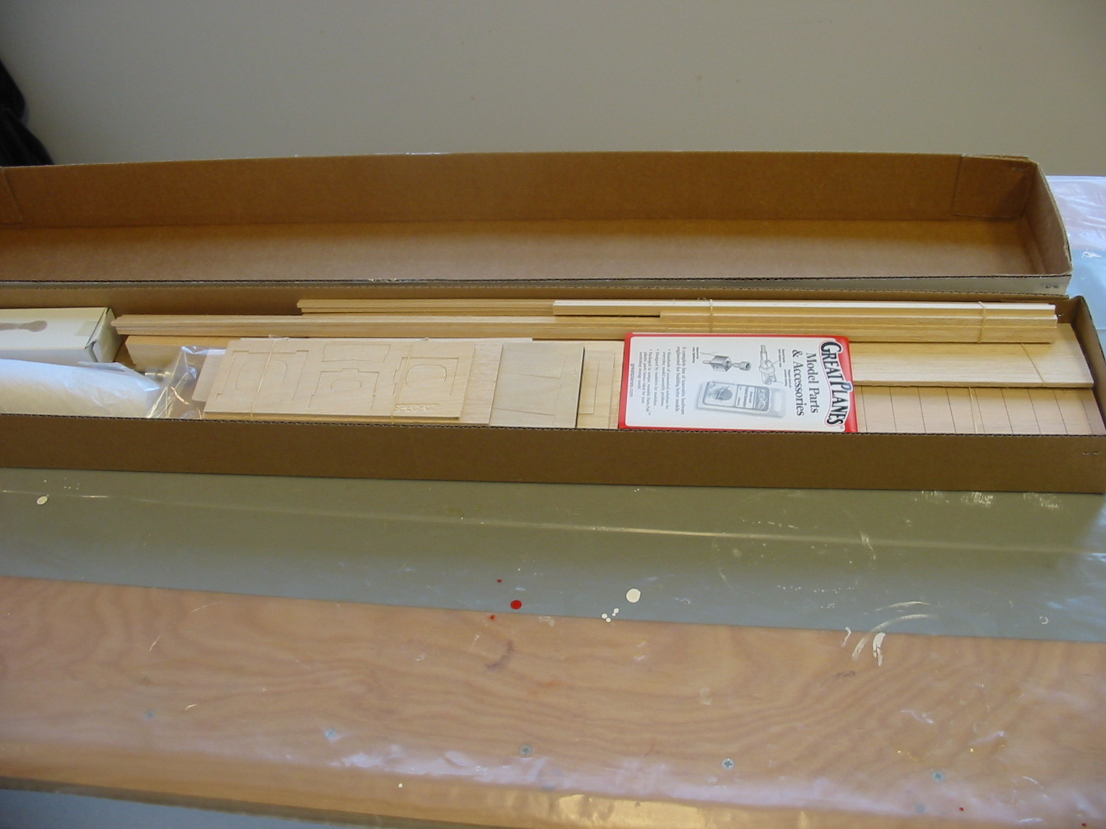

This time I plan to follow the instructions to the letter. This is my first sail plane. So far the instructions are clear and easy to follow.
The balsa looks good. Very clean die-cut. One sheet was laser cut. Here are the sheets spread out on the work table. The first step is to label the parts.

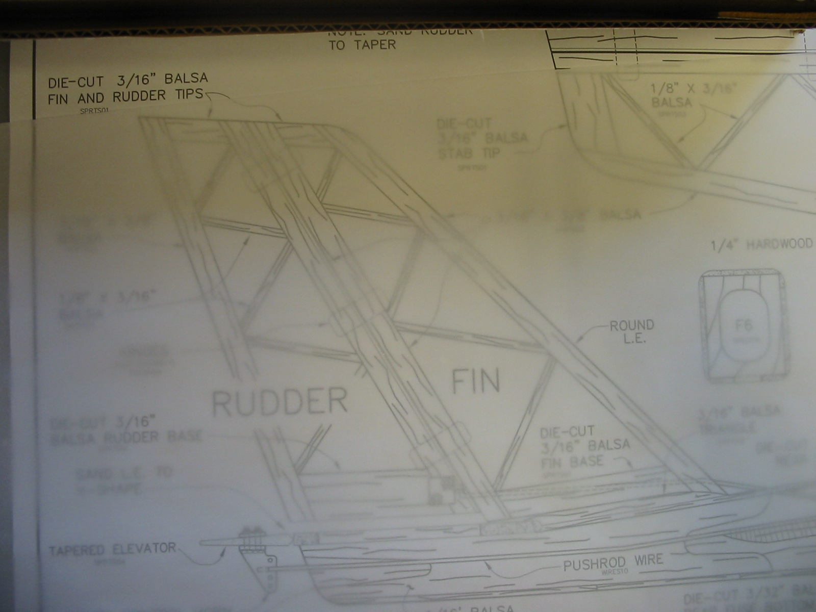

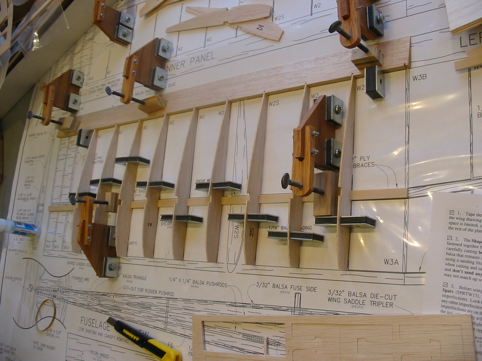

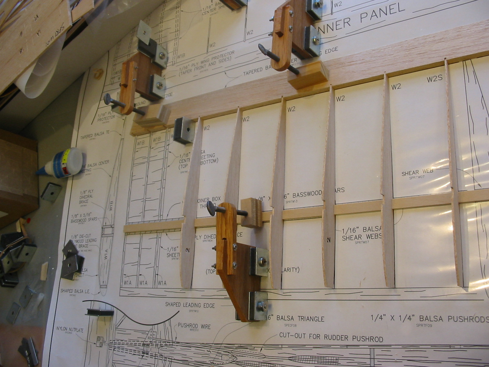

At this point the instructions are a bit out of date. They call for wax paper over the plans. Parchment paper works better. There is a layer of painters plastic and a sheet of parchment paper over the plans. You can see the degree of transparence. It works well protecting the plans and the work bench. The next three images are the rudder and fin constructed with magnets. The techniques used to construct these parts were suggested in other build threads. The cross members were cut just over size and sanded to fit. This worked well. The ca did not stick to the parchment paper. To keep the shop warm there is a small propane heater with a fan sitting on the table behind it. This combination stirs the air enough to blow the fumes away. No problem with the ca fumes attacking my eyes. The fan is a must when using ca.

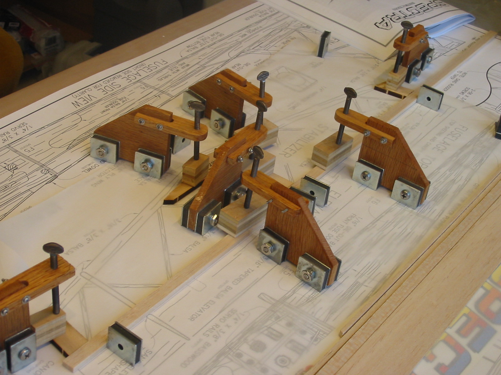

Old 01-25-2015 | 04:43 PM
Joined: Oct 2007
Posts: 324
From: raleigh, NC

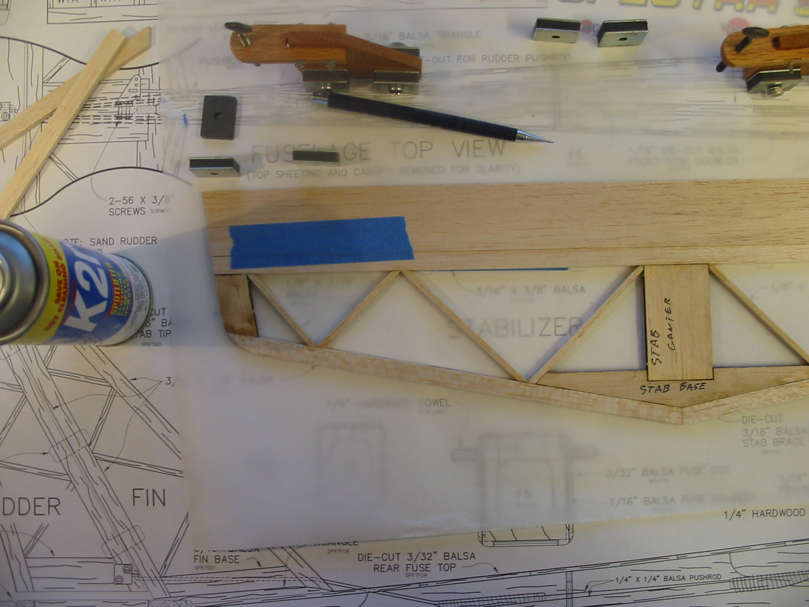

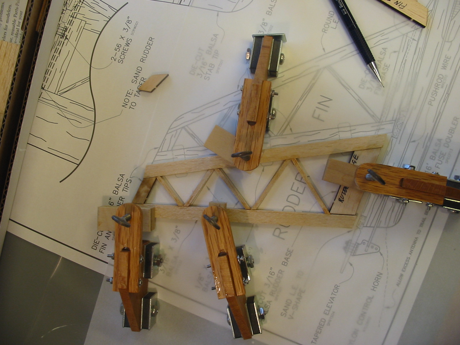

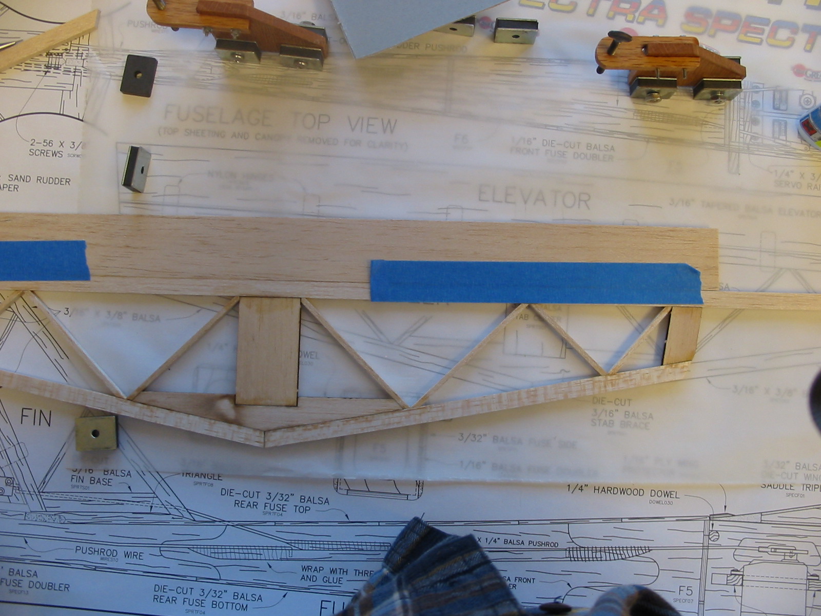

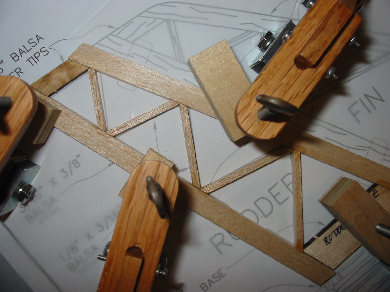

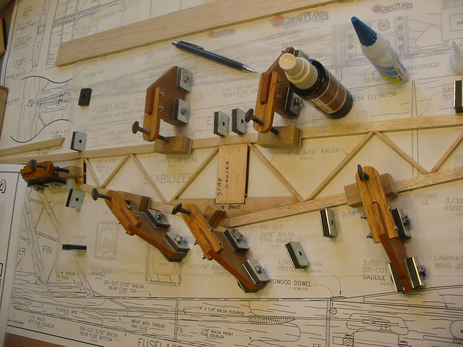

The horizontal stabilizer was assembled with magnets and then CAed together.
These magnetic presses are homemade. The screw is not vertical with the cross arm of the press. The guide hole was drilled with a drill press and most likely is not the cause of the miss alignment. It most likely is out of alignment due to cutting the threads. any ideas how to get these right.
Stabilizer taped to the elevator and ready to sand.

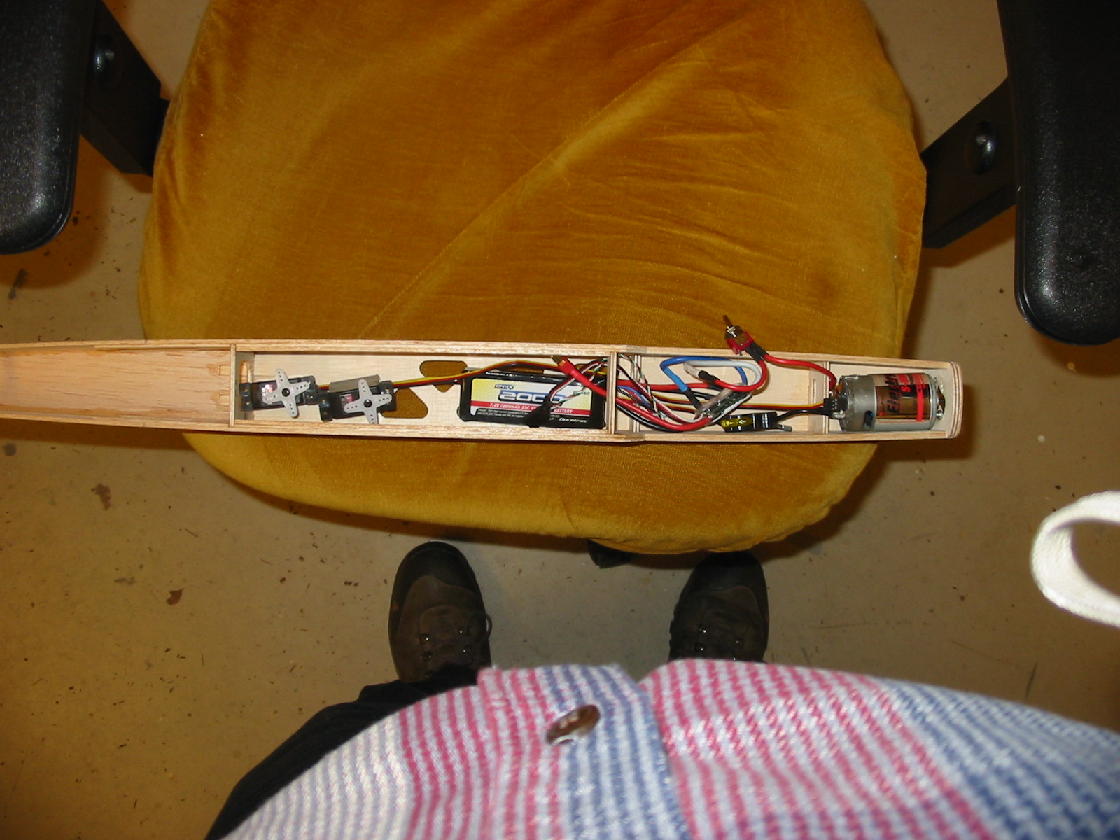

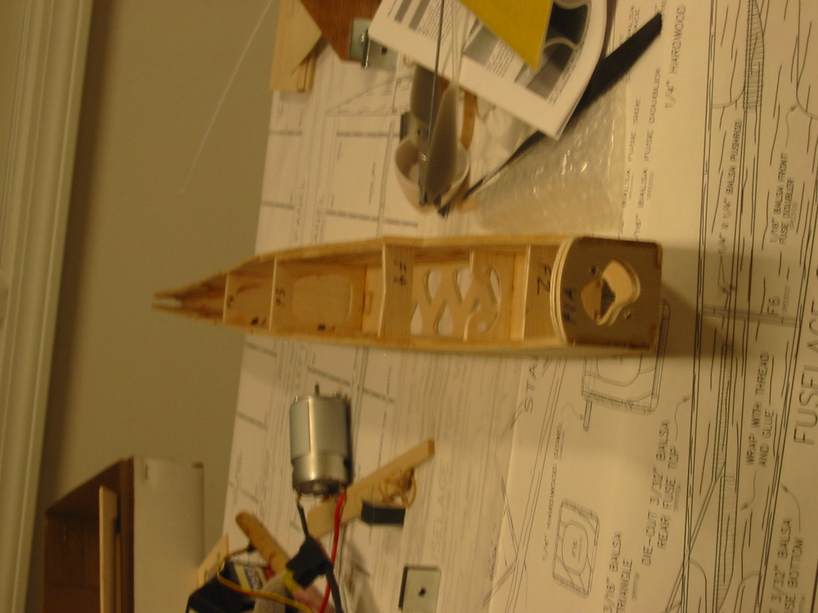

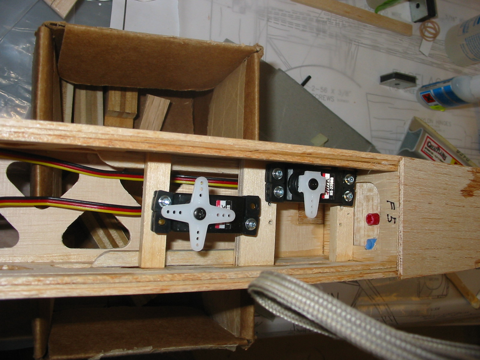

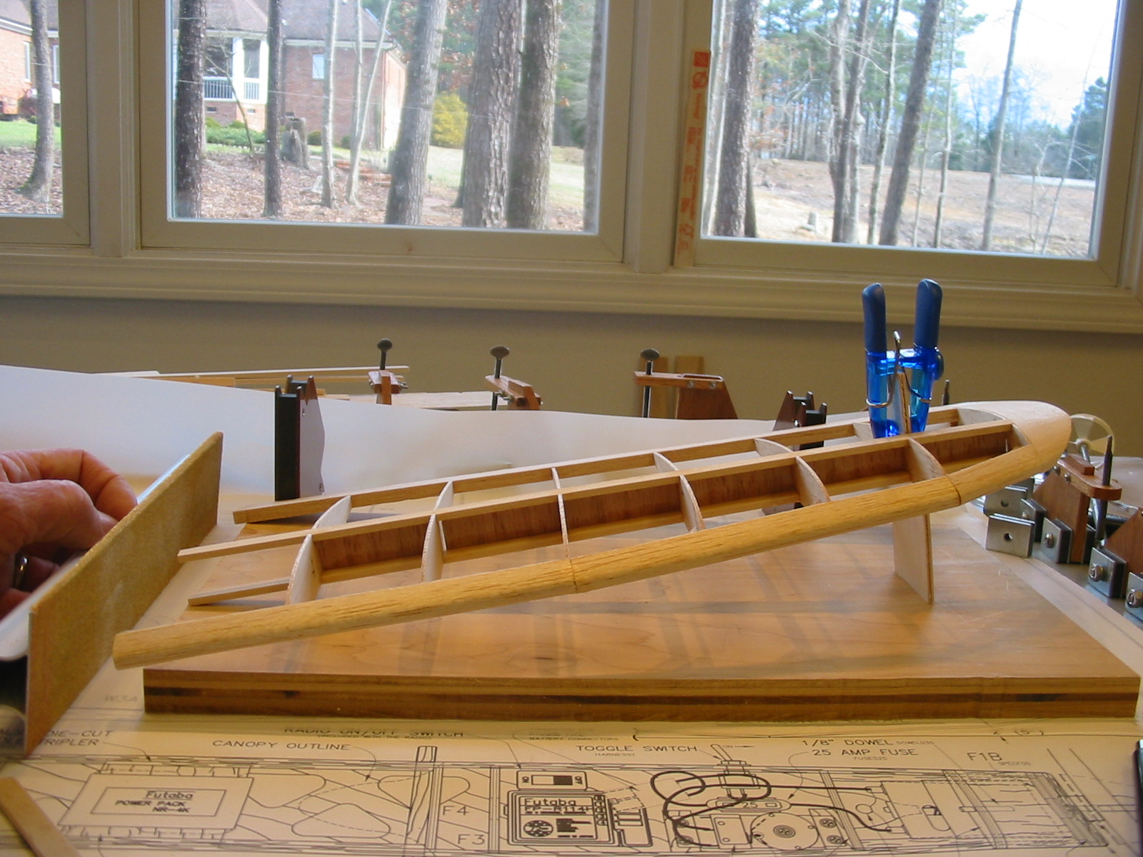

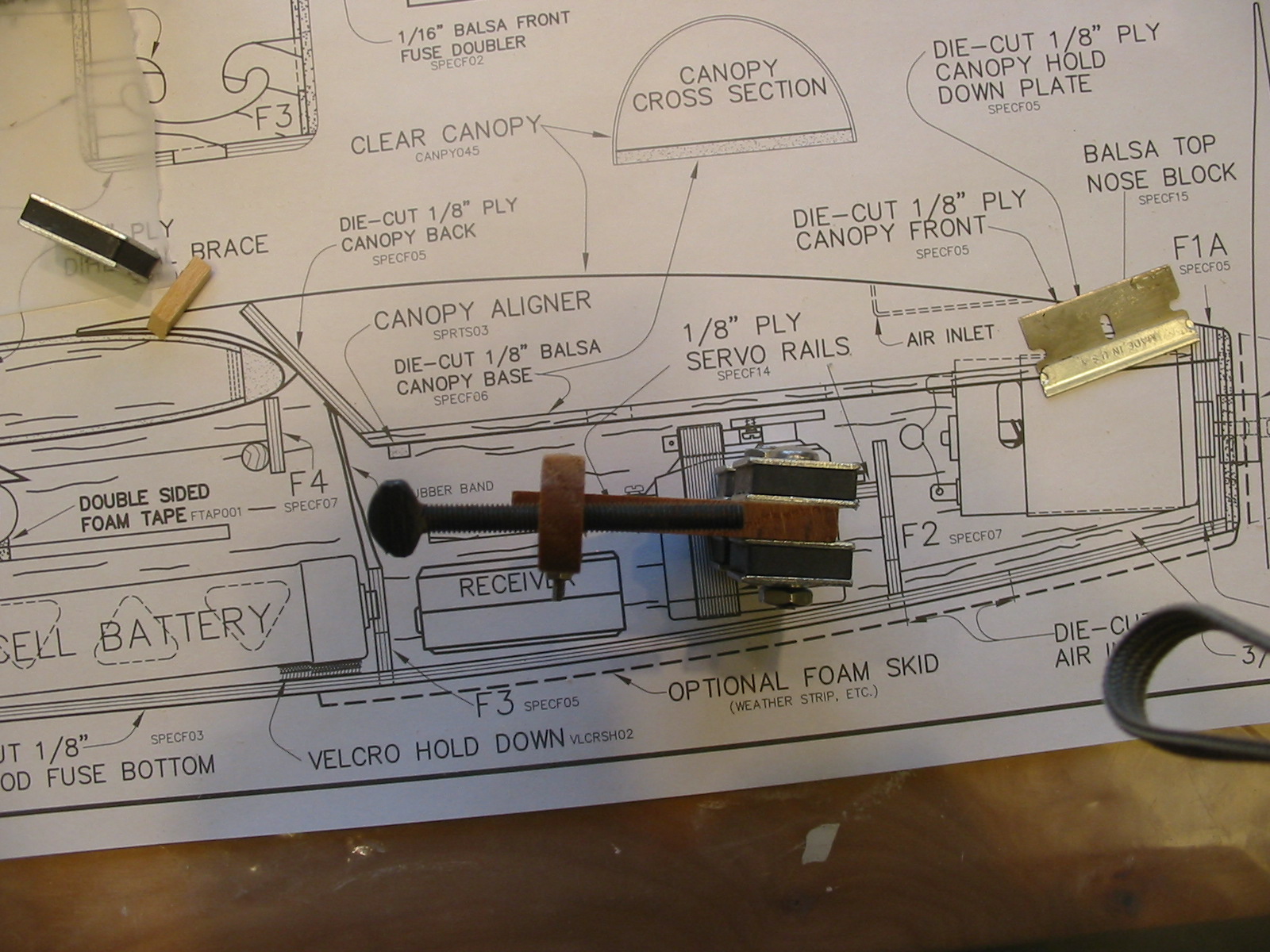

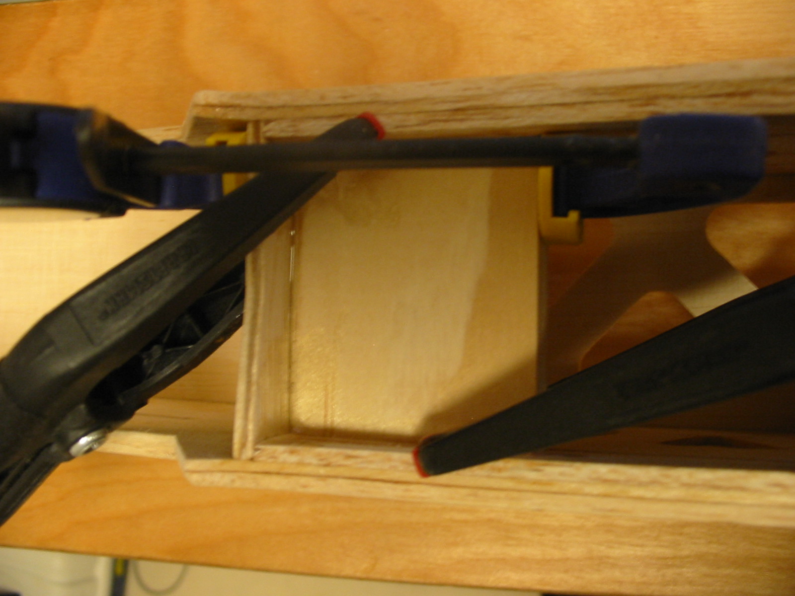

The fuselage up to this point was a one day build. Placing the servos one behind the other instead of side by side may work out better since that will keep the pushrods off of the bulkhead. The wires look a bit long and the ones that came with the engine are very stiff. The ones that came with the ESC are much easer to work with. Would it be worth while to replace the stiffer wiring?

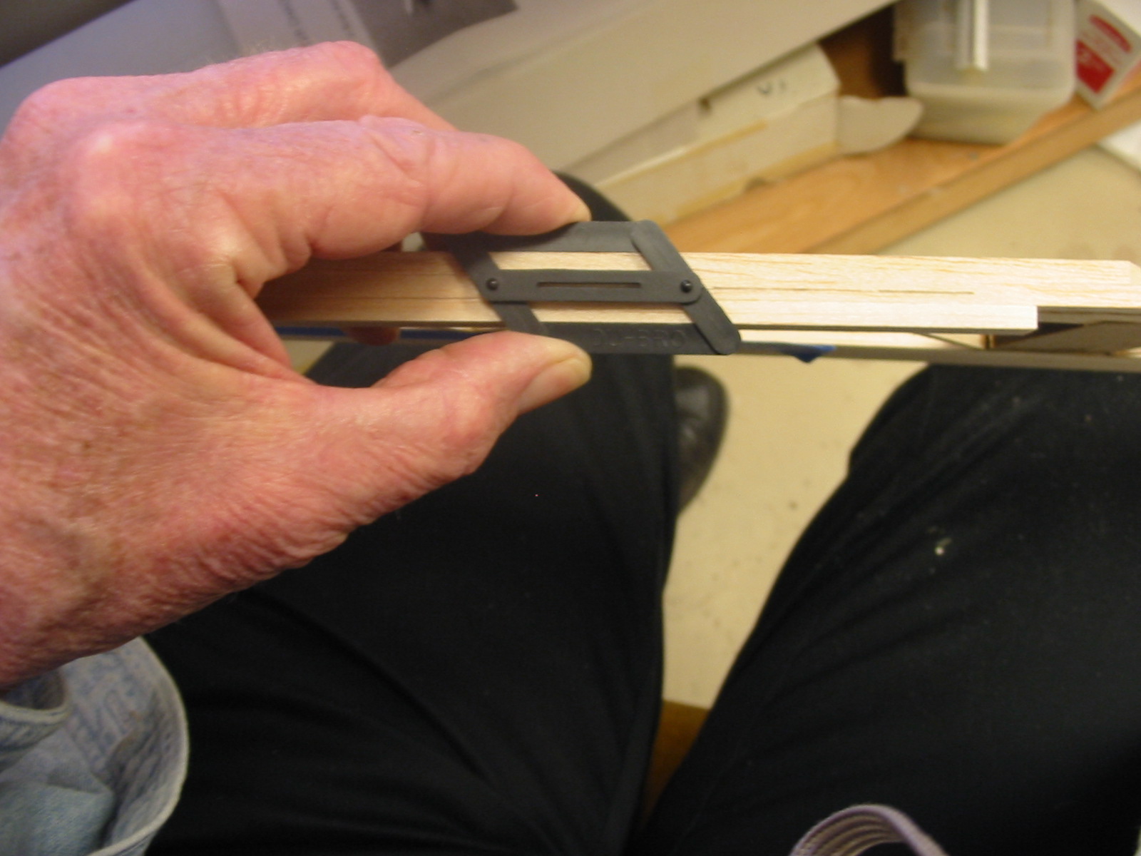

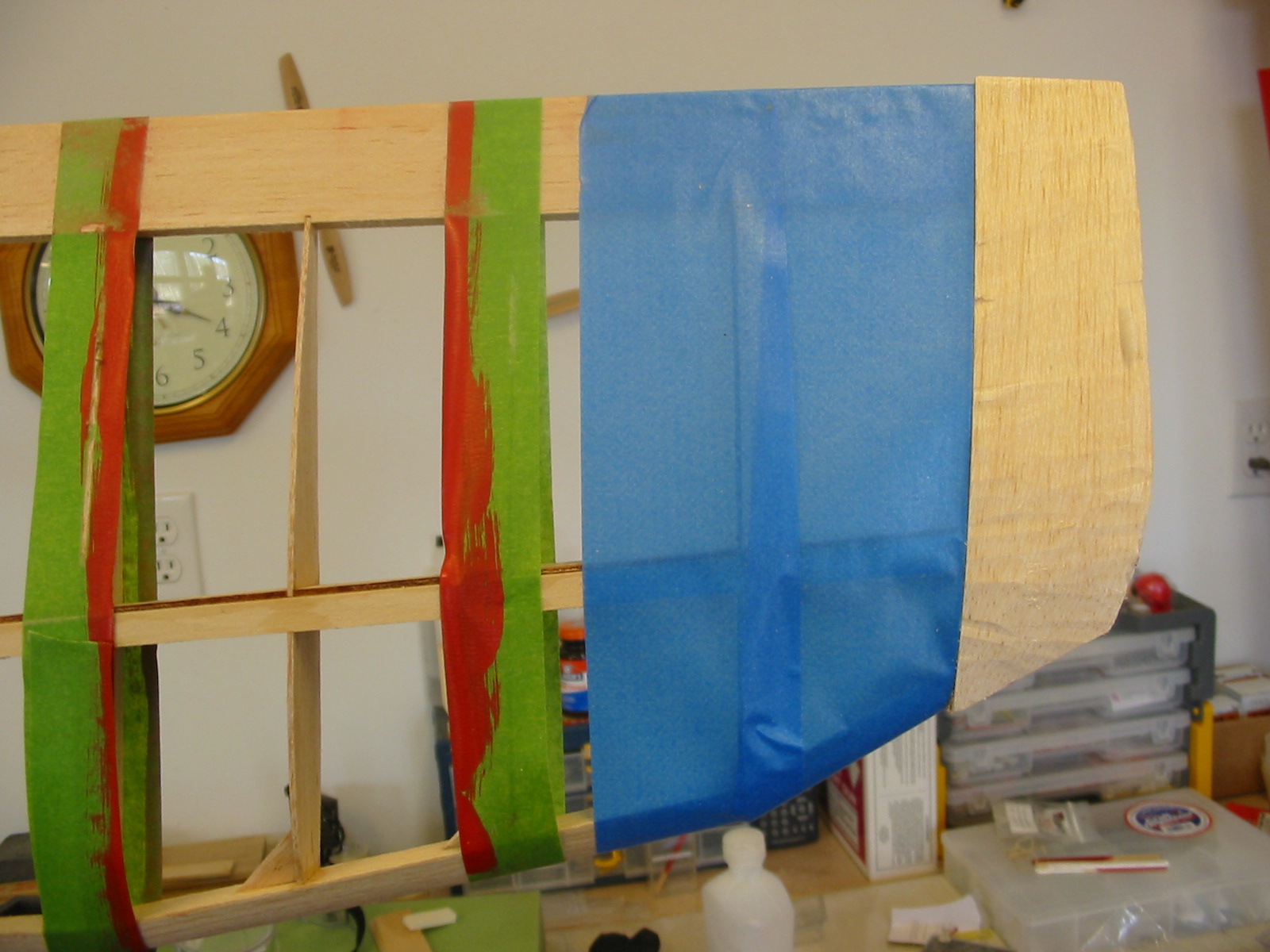

This gadget helps find the center of an aileron

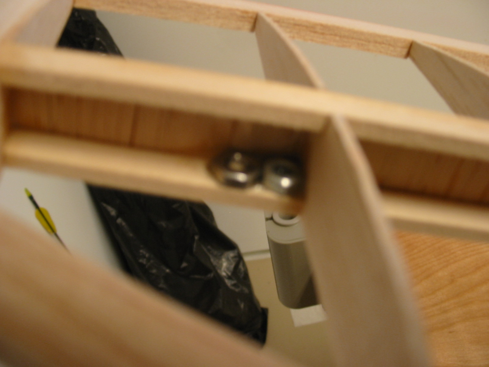

Servo layout. These 255 servos are smaller than the ones it plane was designed for. Instead of using the balsa sticks supplied dubro simi flex rods have been installed.

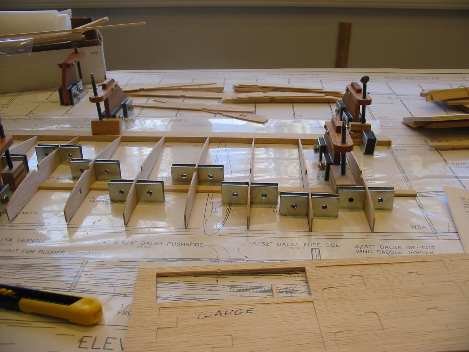

A few images of the wing being built on the mag top bench. I never liked sticking pins in the balsa.
Wing tip ready for sanding. Would you believe that after finishing both wing tips I compared them and discovered that one had been shaped properly for a sailplane and the other shaped as though it were a tarus wing. Fortunately the scrap box has a piece of balsa large enough to make another.
This is how the outer wing panel was sanded to mate with the inner panel.
A small weight was needed to balance the wing.

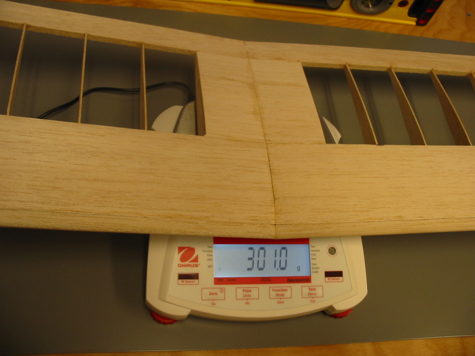

The bare wing weighs 301 grams

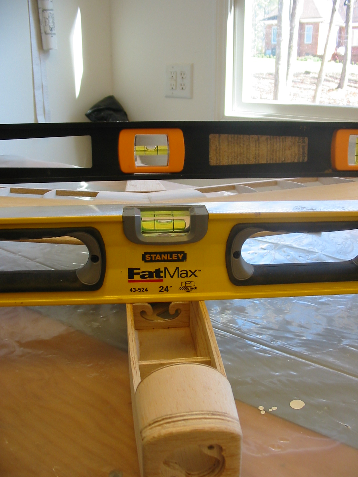

Two levels were used to align the wing to the fuselage.
This wood plate was added in hopes that nylon screws will work for the wing hold downs.
Under no circumstances should you change the wire sizes. They are there for a reason. The motor can pull over 25 amps.
A couple of suggestions.
First, throw away the micro-switch and fuse. Replace them with a 35 Amp brush type ESC.
Then, ditch the NiCd brick and use a 2000 to 3000 mAh 2s LiPo. You can power the receiver and servos of the ESC. It will act as a voltage regulator for the receiver.
All told it will reduce the weight and increase the motor operation time.
If you want to get extravagant, you can use small brushless motor and a brushless ESC. But that would create some motor installation issues. Very hard to re-engineer the fuselage.

Thanks for the comment. No plan to change the wire size. The wires that came with the motor are very stiff. The wires that came with the brushless ESC are softer and easer to bend. The same wire gauge but with more strands. Why isn't the fuse needed with a brushless ESC?
The motor in your kit is a brushed motor, a brushless ESC won't work. It has an extra motor wire. You must use an ESC designed for brushed motors. I recommend the 35 amp size.
The fuse is just extra weight and will blow at inconvenient moments. The ESC will shut off before a fuse can blow if there is an overload.

The ESC is the brushed model recommended by Great Planes. Does the brushed ESC have overload protection? From your post it sounds like it does. The wire to the motor and the fuse holder is very stiff. Where can a high strand count wire of about 16 gauge be purchased?
Deans Silicone Wire. High Current very flexible.
http://www3.towerhobbies.com/cgi-bin/wti0001p?&I=LXKX17
