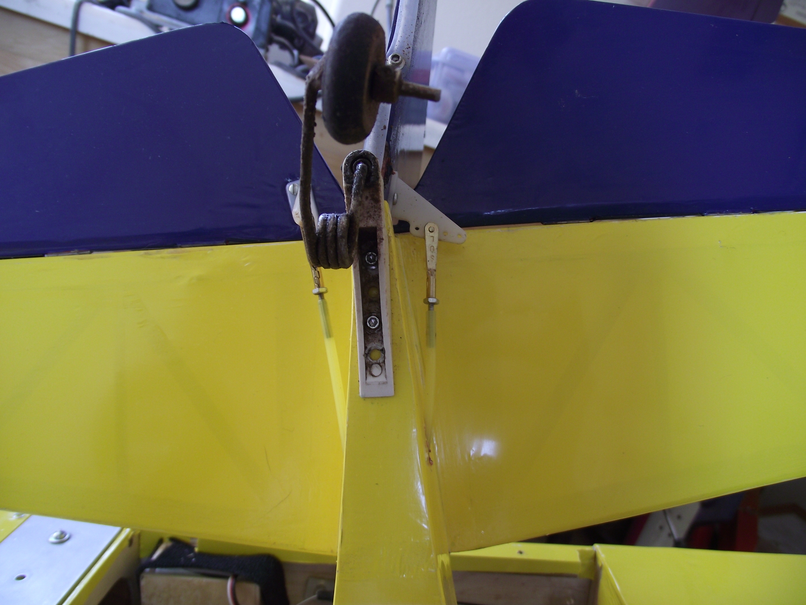

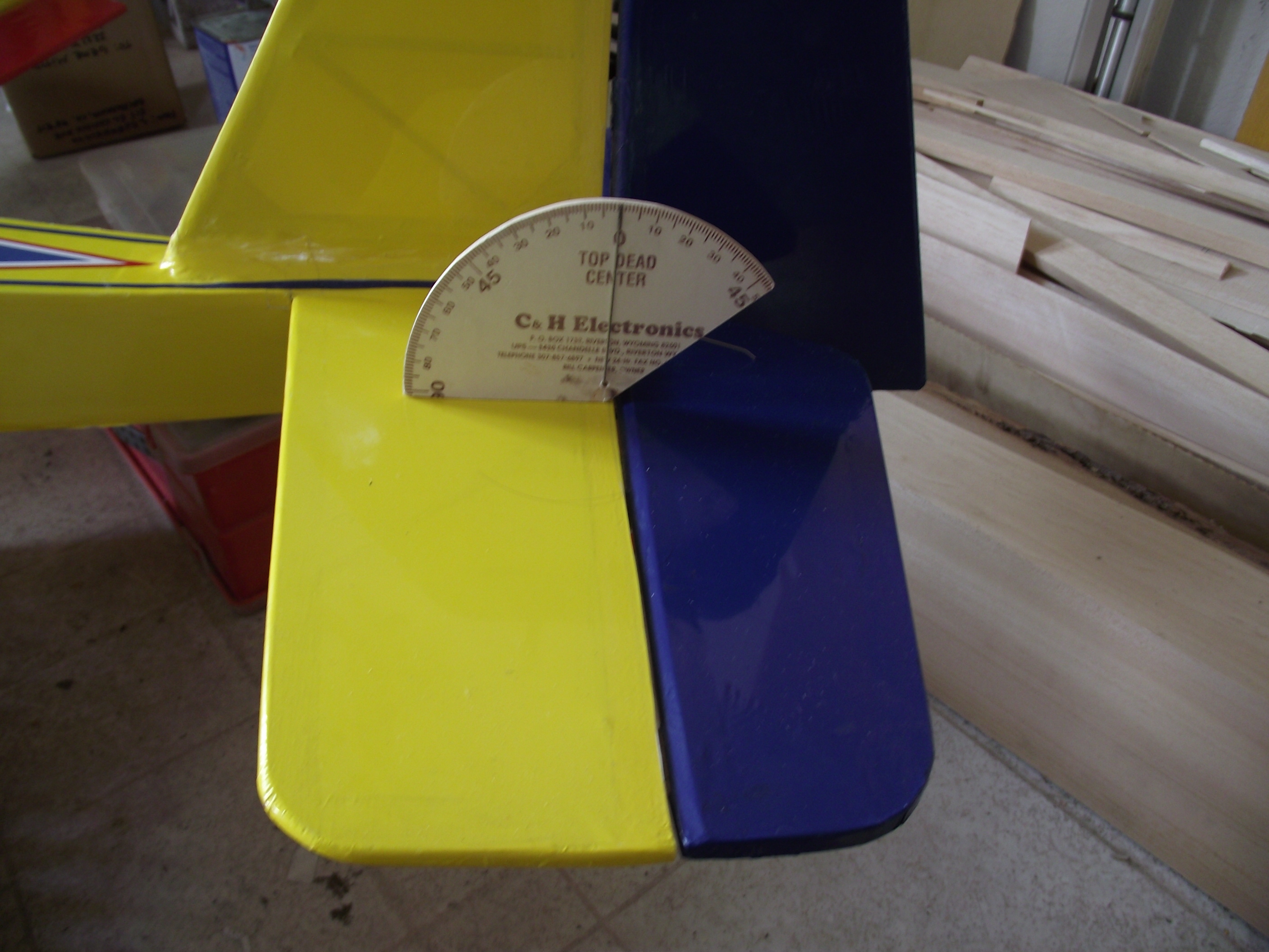

The plane is an Up-Roar, the controls are nyrod with an 18 inch run. I haven't had it out of the shop in a week, before that it was in my van for two weeks. It's my plane I keep in the van in case I want to pull over someplace and fly.

Are the pictures showing me that the rudder has deflected because of the expanding of the nyrods?

I'm heading out to fly in about an hour so just for grins I turned on the plane and radio, the trims are still set at zero, the shop is at 95 degrees and it's humid. I took a shot of an ARF I assembled to sell that I installed the elevator and rudder aft to get the correct CG and used a 4-40 rod for the elevator and made up a pull/pull for the rudder. It never changes trim either.
I pulled out a piece of the red outer tube and slid in some 4-40 rod, a lot of room left inside the tube but it will work. Also going to change the CG with the added weight. Then I pulled out a piece of the Nyrod and slid a piece of 2-56 rod in it. Perfect fit and slides well.
When I was in Calif. and flying a plane with the nyrod the trim would maybe go out a click/beep or two but nothing worth changing out the controls for.
If it's more then a little trim change you have some other type of problem. Something is shifting?? A little is normal. What are you calling a lot??

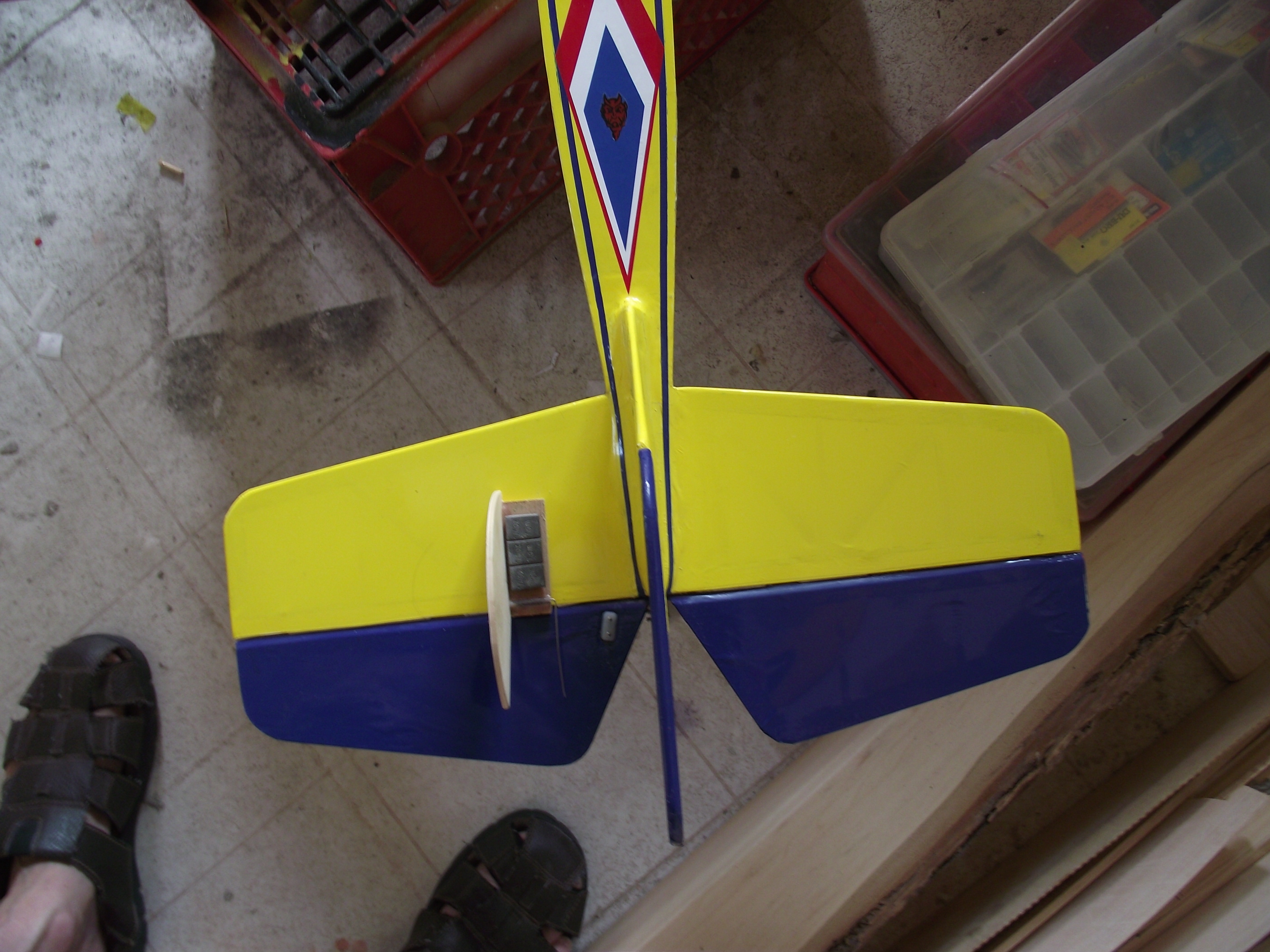

Sorry about two photos but my program only shows little thumbnails and I can't see them. The photo shows you the 4 anchor points on the guide tubes.
That really is way too much change and if you opened up the top or bottom of the fuse I would bet something else is wrong.
Removing the plastic rod is really easy and it would only take a few minutes to install a metal push rod to see if that will fix your problem.
It really is a fast thing to do.
Another thing I used to do a lot was make push rods from carbon fiber arrow shafts. You can eliminate all the braces and guides. A lot of the old kits gave you a dowel to make the control rods from.
You do have a problem but it's an easy fix!!
