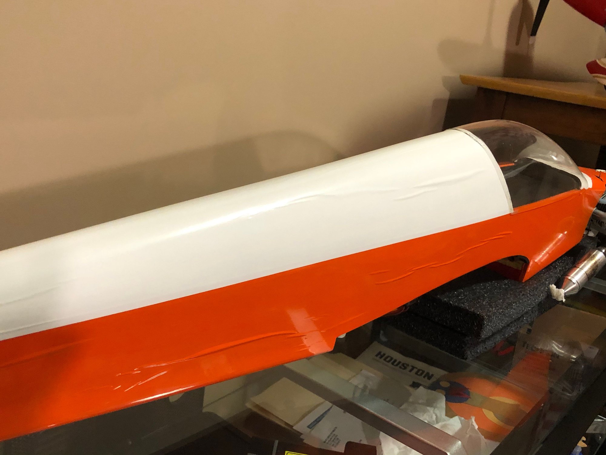

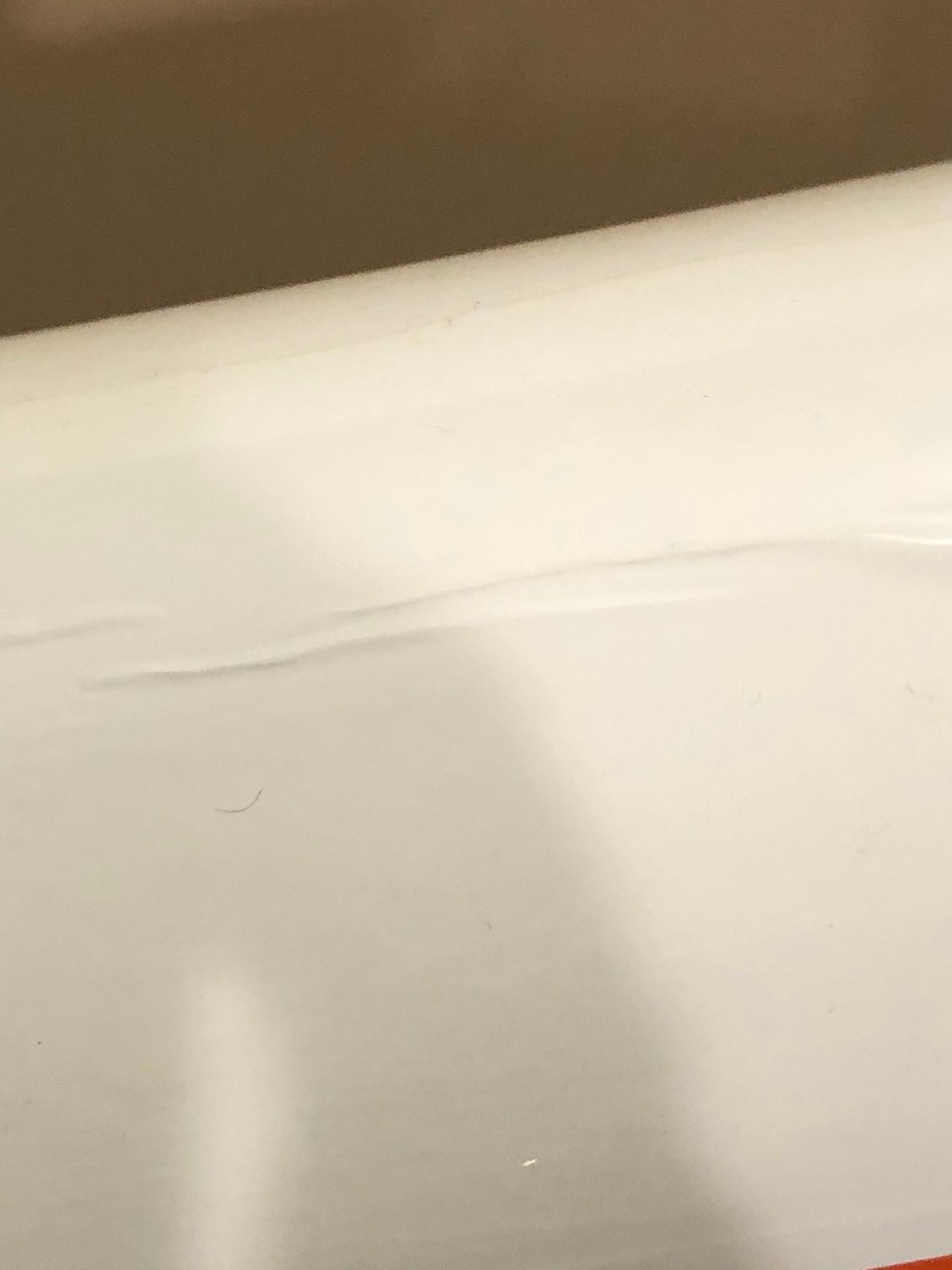

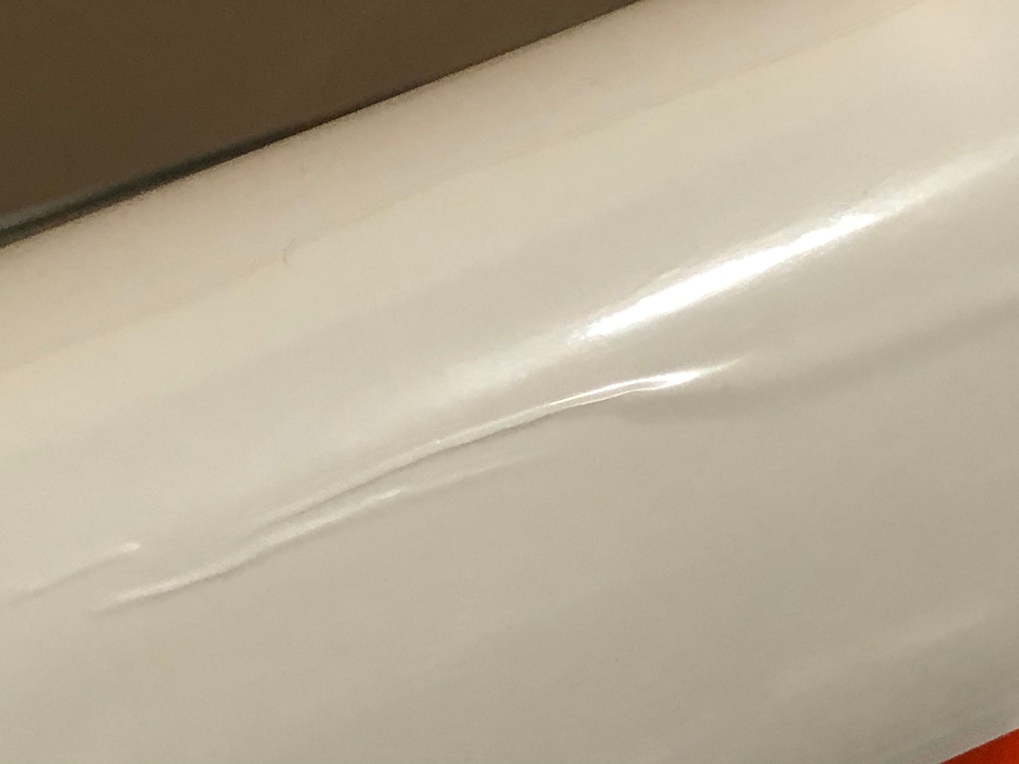

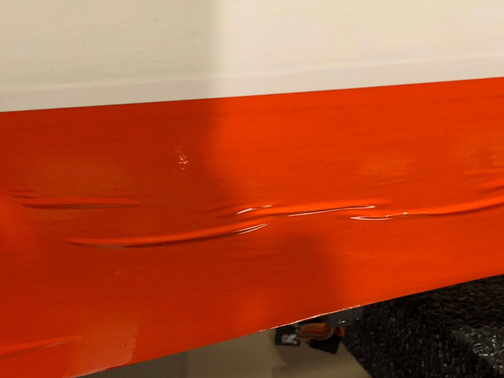

All - several years ago I purchased a kit built Ultra Sport 40 that had been covered in (I think) Ultracote. Never had any issues with the covering, but over the winter, there have been wrinkles that have developed. I attempted to re-shrink with a covering iron and sock. This made the issue worse, and in some cases seem to harden the 'ridge' of the wrinkle, and even created MORE wrinkles! I then purchased a heat gun, and attempted to gently heat up the covering in hopes that would re-shrink it, but instead, the covering just lifted away from the fuse!
I'm at wit's end here, and in need of help form the folks on here who know covering, and how to fix this problem, as this is by far my favorite plane.
Can anyone provide some assistance? I'm not familiar with Ultracote, and trying to figure what temp I need on the iron, and what technique to use to get these wrinkles and make the covering 100% smooth as it used to be.
Pictures of the issue below.

I'm wondering if you're getting enough heat on it. If you have a sock on an iron, I've found sometimes the heat coming from that combination isn't as intense or direct, as much as it seems without the sock on the iron. If you want to take little chance, try the iron turned up a bit more, without the sock in a very inconspicuous area, just to see if it might help.
Whatever you do, stay away from the areas where colors meet. The colors/film will just shrink away from eachother, and possibly open up a seam... or skew any straight line(s).

If your plane is an ARF, it may be covered in brand X covering and it will not shrink. Ultra Coat should just shrink with a little bit of heat from a heat gun. If it is Monokote, it shrinks as it cools and is famous for wrinkles due to weather changes. Just be careful with the heat as the seams will pull apart. Good Luck, Dave

Typically this issue regardless of covering brand is balsa dust being left on the surface when the airplane is covered. The only real fix is to recover with proper surface prep.

After a while most kit built and all arfs even when new need some covering care. Just look up Ultracote instructions or Monokote instructions and they will give you a heat range.
I would use a heat gun and keep the heat away from the seams personally.
If you use a iron be careful there is a chance you could lay a wrinkle over and that will never come out.

The wrinkles went away when a heat gun was used - the sealing iron wouldn't do it.
Not sure what kind of covering you are working with, but I would try a heat gun.
You must work slowly and be sure not to burn the covering.
My particular situation was Ultracote - not sure what you're using, but some coverings may react differently.
Let us know how things work out for you and best of luck.
