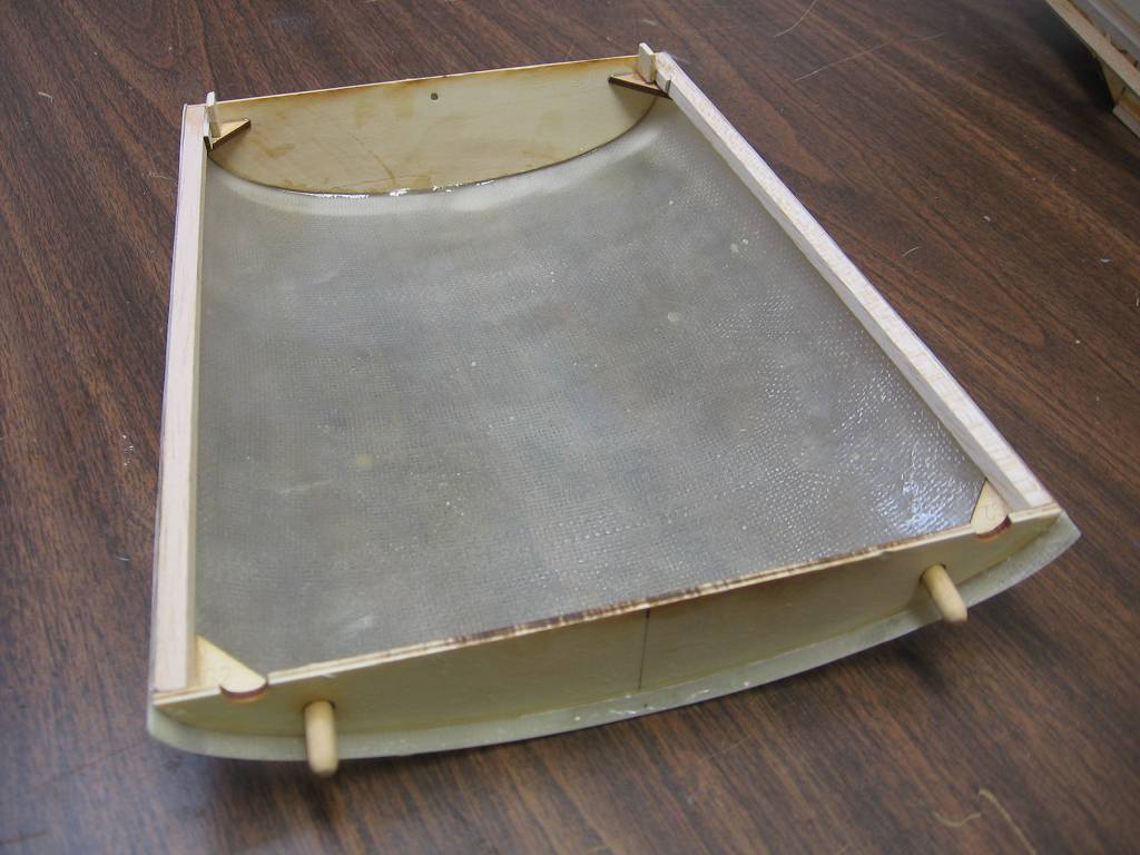

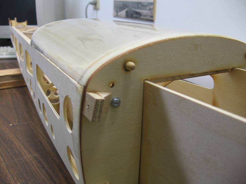

I'm back. Been picking away at the hatch. There is a fair amount of work to get the hatch to fit just right. I found after trimming the sides to the trim lines that the front of the hatch was way too high. So with the FG hatch being somewhat see thru I could hold in down in place and mark where it needed to be trimmed to.
I have decided to use the supplied ABS turtle deck. I have read that it is heavier but I think this plane will come out nose heavy any way so I don’t want to go through the trouble of constructing some lightweight deck just to end up adding lead to the tail to get it to balance.

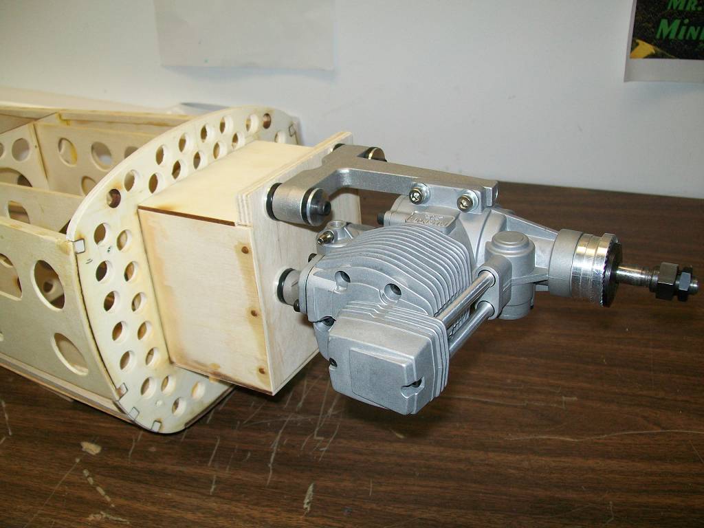

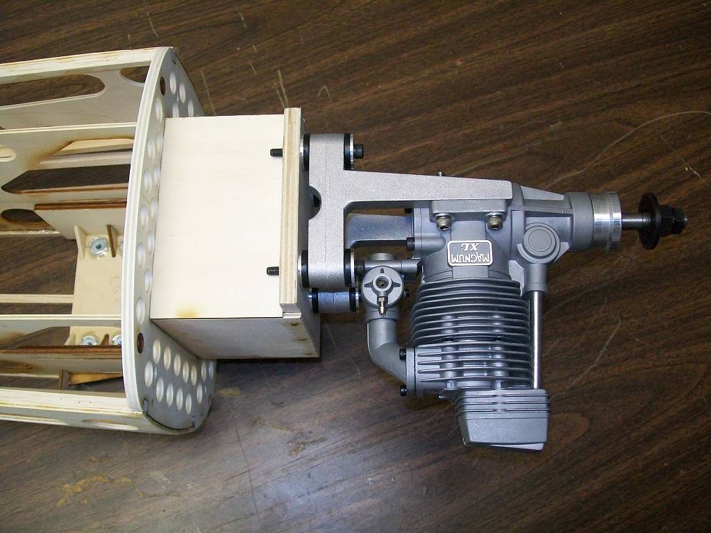

Old 05-25-2010 | 06:55 PM
  #309
Nauset's Avatar
Joined: Jul 2003
Posts: 105
From: Patriot Nation
Default RE: Lanier Extra 300s 1/4 scale kit
I finally got the engine mounted. I used Dubro anti vibration mounts. They seem to be good quality and not too pricy.

Old 05-26-2010 | 11:47 AM
  #310
prgonzalez's Avatar
Joined: Jun 2004
Posts: 868
From: KATY, TX
Have you told us what size engine you have there? Is it 1.80?
Old 05-26-2010 | 11:50 AM
  #311
Nauset's Avatar
Joined: Jul 2003
Posts: 105
Yes, Magnum XL 1.80RFS

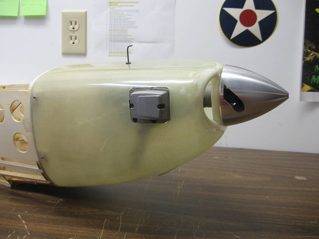

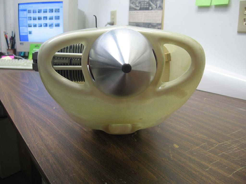

Old 07-06-2010 | 08:45 PM
  #314
Nauset's Avatar
Joined: Jul 2003
Posts: 105
I got the engine cutouts made in the FG cowl. Not to much cutting. I was pleasantly surprised when I discovered that the whole exhaust pipe and muffler fits completely in the cowl. I just need to add a Dubro exhaust deflector to have it come out the opening I made in the bottom for air flow.
