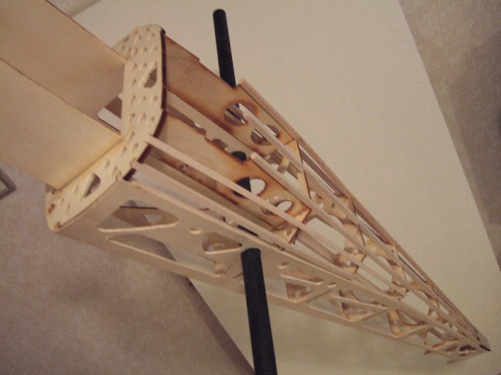

Stringers are in place and soon this fuz itself will be ready.

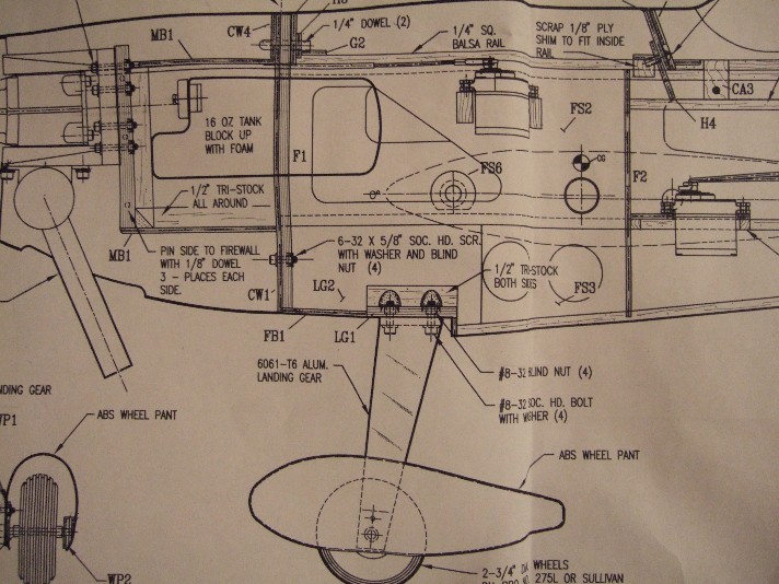

I am thinking about put a lightening hole in the middle of the landing gear plate. This is 1/4" thick ply and is in turn supported by the sides of the engine box What do you think, how big hole in the centre of this plate in order not to risk its structural integrity? Considered the loads is straight up, through this plate and not bending....

Well I went ahead and did it anyway... [>:] Purhaps I was a bit careful on this one as it is a part that probably are going to take some beating...
Saved a wimpy 10% on the gear rail doubler with that hole
. Landing gear plate approx 0,07 oz.

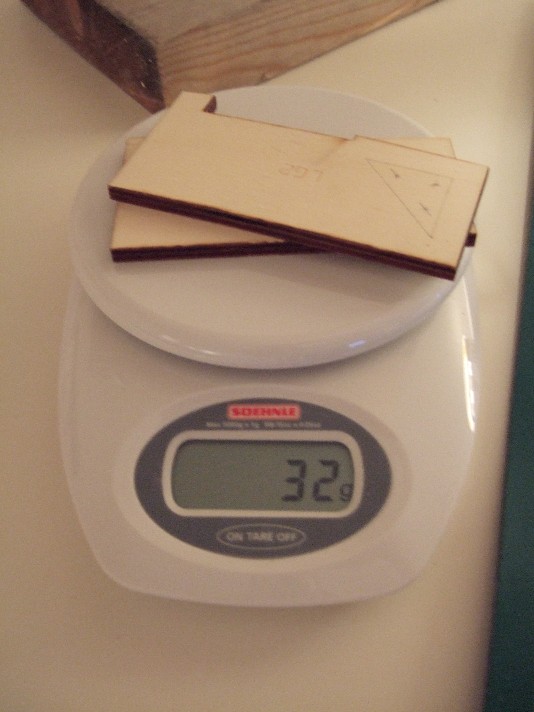

Well if I have calculated this correctly (converting sq cm to sq ft and grams to oz) I have the numbers for 1/64" ply and the kit stock 1/16" balsa sheet weight.
The 1/64" ply has a weight of 4,3 oz/sq.ft.
While 1/16" balsa sheet (stock from this kit) 1,5 oz/sq.ft.
Conclusion: Balsa sheeting has a third of the weight of 1/64" ply. Approx 1 sq ft is needed to sheet the turtle deck and if using balsa there is 2 oz of weight saving compered to useing thin ply. I am going to use 1/16" balsa sheet for this job (as well as trying to get my little hands on some more contest grade for even more weight savings).
