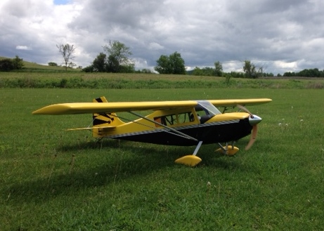

Maiden flight was this past weekend and all I can saw is WOW, this is a keeper! Saturday was not the best day for a maiden with 10-15mph winds but it was coming straight down the runway so I gave it a go. The SD tracked perfectly down the runway and made a beautiful scale takeoff. A couple clicks of right aileron and down elevator had her flying hands-off. The landing looked even better, I just lined her up on the center line, chopped the power and she practically landed herself. The guys in the club were impressed! Sunday was practically windless and it was even more impressive. Loops, rolls, hammerheads and a little inverted all performed like I really knew what I was doing. I'm still feeling her out and I think a little rudder mix and maybe some differential would smooth things out but I think this is going to be a fun airplane.
I built the kit mostly by the book except that I added the door with the intent of scaling out the cockpit but as everyone warned, she came out tail heavy and I was forced to move the batteries all the way forward and the tank back over the CG. not the worst place for the tank but it messed up my cockpit plans. Power is a G-38 with an EI conversion and it fits the plane perfectly, both in size and power. Even with the Zenoah and batteries in the nose I ended up adding 10oz of lead to get her to balance on the recommended cg. Total weight is 18.2 lbs.

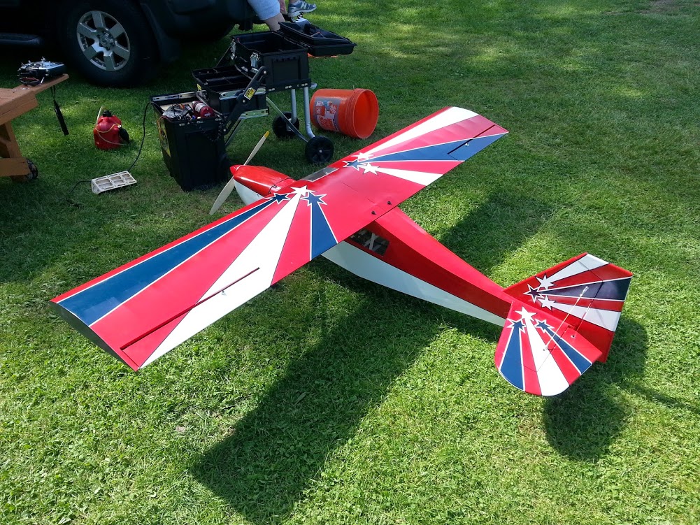

Anyway, here's my dynaflight...
os gt33, weighs just under 12lbs RTF
we maidened last Sunday, was a blast. Its going to be a great plane for a long time to come ( "fingers crossed" )

a couple thoughts that aren't necessarily in the build thread.
the os gt 33 vs G38 + 10 ounces of weight is a difference of over 2lbs right there.. so if you were able to find a way to balance yours with a GT33 + no lead, you'd be under 16lbs already...that part though was a pretty big challenge, as the tail on this plane isn't exactly small...
I balanced the plane prior to covering, installing servos, battery etc so that I wouldn't have to add weight later. This put the servos up where a pilot would normally be, and the batteries where the gas tank would be.....because of this I also have no cockpit detailing which is a bit of a bummer... but I'll live with it.
the build thread wasn't very popular, I had a couple followers, so for the rest of the people that want to know how I got down to 12lbs..., I redesigned the tail section and cut out all of the 1/4" x 1" spars that were used aft of the CG and replaced with either 1/4" x 1/2" or 1/4" square. The reasoning here was my Dad's Ace Extra 230 ( 30% ) used 1/4" square stringers for the tail.... if that is good enough for an unlimited aerobatic aircraft... its probably more than adequate for an aerobatic trainer like the decathlon...my other thought was while I've built many planes that have had wing failures.. I've yet to snap a body in half... so I should be able to build it lighter....I made the flying wires functional as well which allowed for lighter/thinner wood.... it mainly made the tail light enough so that again, no extra weight was needed to balance...
the rest of it was just wood selection. I have a box of wood from the kit that I could almost build another decathlon out of that I chose not to use for the main reason it was just very dense and heavy, I ended up going to my local hobby shop and swapping out pieces and trying to really keep the body as light as I could.
I'm by no means an expert here, this whole build was a first for me and entirely a learning experience... just had fun with the whole build and decided to try something new

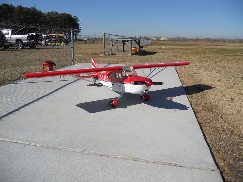

Mattnew.....You can find the exact center of the tube and (lightly tap) the center with either a screw driver or chisel. The indent will cause the tube to take on a degree of dihedrel when the wings come together. You will have to adjust the wing strutts as the wings with the new dihedrel will pull away slightly from the fuse. I did this to my plane and the strutts just needed a slight amount of adjustment. It looks much better(IMHO)! The full scale does have some dihedrel while it may be also possible some full scale planes (by adjustment) may have none.[ATTACH]2001826[/IMG]

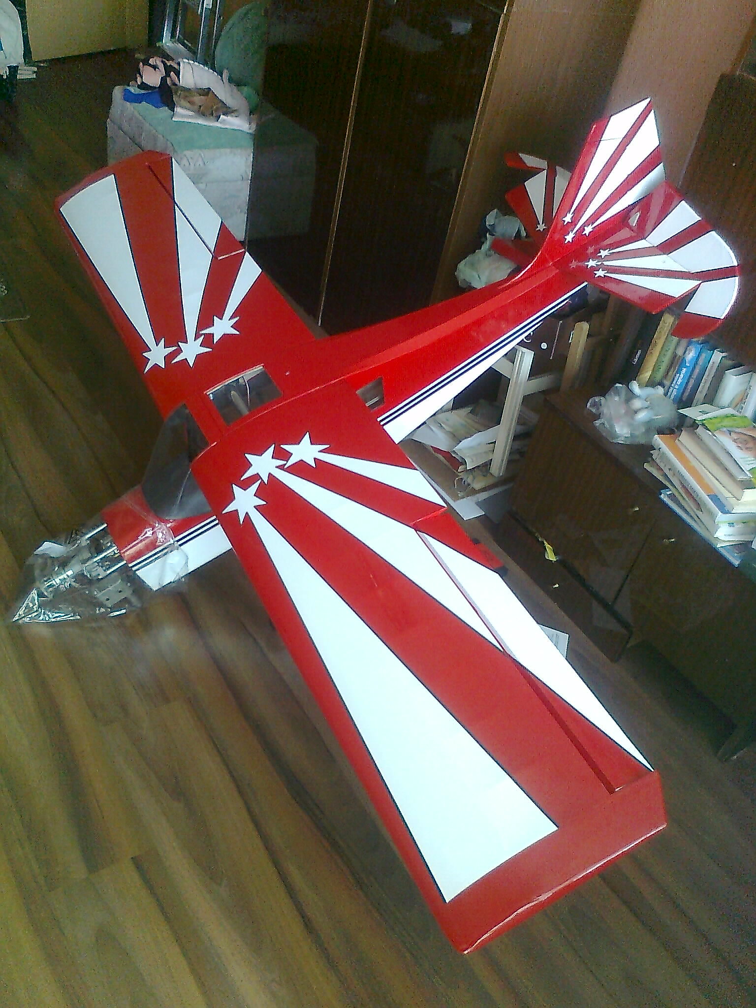

Here is mine(-: Unexpected huge! On the way to first takeoff....Now just putting the setup stuff and still hope do not exceed 6.5kg weight limit... (-:
Making the tail lighter like mattnew is the good smart idea! For mine SD do that it is too late, as taking dihedral degree for the wings. But if I decide next SD project, I'll do that!:-)
Thanks ScaleRCpilot for the experience advice! Hope your new SD will bring too much joy!
