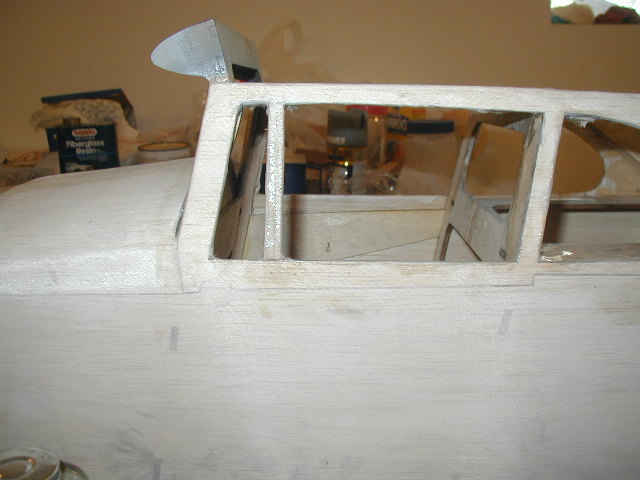

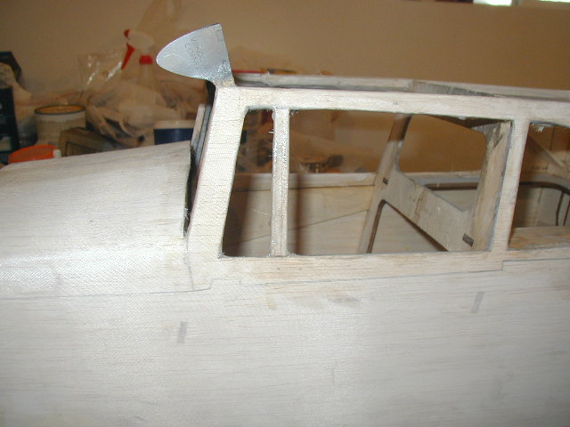

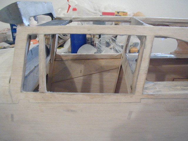

Last night I added what will perhaps be the only scale detail on the plane. In the real plane the windows were non-opening fixed units except for a small wing window on the pilot's side. I used some scrap 1/8 th to install the piller for that wing window. The piller is not as wide as the windshield piller so I cut it by eye for a scale look. With the covering in place over the window opening it is easy to insert the new piece in the opening, attach the cover, and place a drop of CA at the yop and bottom of the new piller. Cut out the windo openings and finish the edges. My window won't open so all that is needed is to attach the window sheet per normal. I think it adds a lot to the overall scale look.
Three shots of the new window, different settings for contrast.

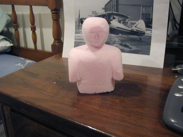

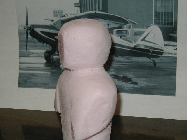

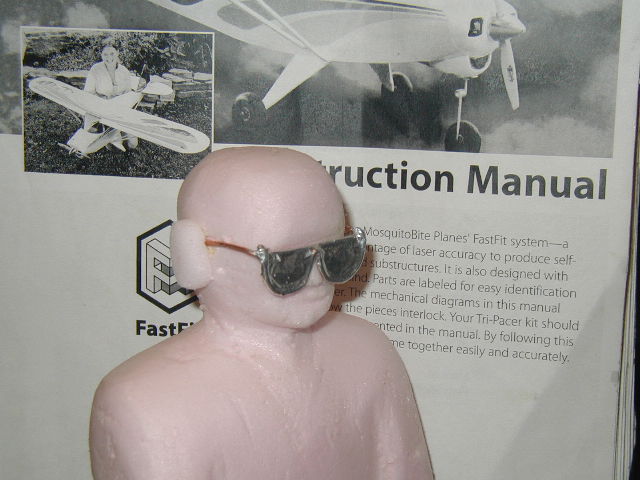

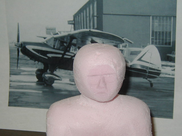

Ok, Now for something completly different! I have been looking for a 1/5 scale pilot without much luck. So I decided to clone myself for the piloting duties in the Tripe.
Presenting TRIPACER MAN!! I had my wife measure me at all the important points, Using a calculator I scaled the numbers to 1/5 th, and thru the marvels of modern hobbycraft subtracted 20 years from the critical dimensions. Below we have the preliminary stages of that cloning process. I did not have a lot of DNA laying around so I made myself from pink foam. So far I have used a keyhole saw, a surform file, a razor saw, a steak knife and some 100 grit paper. I know, he has no facial features yet but they will come tomorrow. When the process of physical construction is complete a coat of poly or two, some paint, a set of David Clark ear phones and a set of aviator shades will finish him off. My wife has volenteered to make him a little flying jacket of his own, just like mine. As you can tell I am not in the habit of making people so he may only be a prototype. Heck I have a whole sheet Dow foam (2 ft X 8 ft) so I could clone a whole company of TRIPACER men.

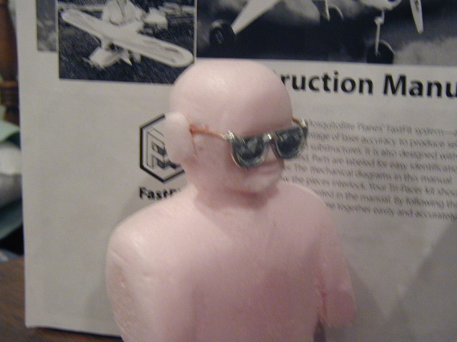

TRIPACER MAN is comming along. A face is starting to appear and with his shades and D/C headphones hie is begining to look like a pilot. A badeball cap and leather jaket will deck him out quite nicely. He may get arms as he really needs them finish the look. What do you think so far? Still awaiting paint for the plane and the pilot.
More later.
More later.

Nice looking pilot. I noticed your photo in the back of the original pilot introduction. That is the scheme that I found to be very popular, is it the scheme you plan on using. I have chosen insignia blue lower fuse and a cream wing and cream upper fuse. I am having a problem locating my motor. Trying to match a Pitts I already own to a motor I don't own. I bought that GMS 76 pitts and now I am trying to locate a motor. If you see any, let me know.

Mr. Hill, Thanks for the comments on the pilot. He will be pretty close to being finished in another day or so. If I were any good at sculpting I would consider making pilots for a living. The money they get for them would sure feel good in my wallet. But I'm not so I won't. Oh yes ,I want to use the Piper swooch on mine too. I had planned on cream and red, but decided to go with white when I bought the paint. I have no idea how I will get that scheme on the plane. I had thought of cutting it out of vinyl as a mask but I can't get what I need around here. The local body shop may me able to help me with some wide masking tape, and who knows, they may have a way to cut stencils. I will enquire. the other way is to just mask it off and hope both sides match. I have a while before that stage so I will coninue to think about it.
