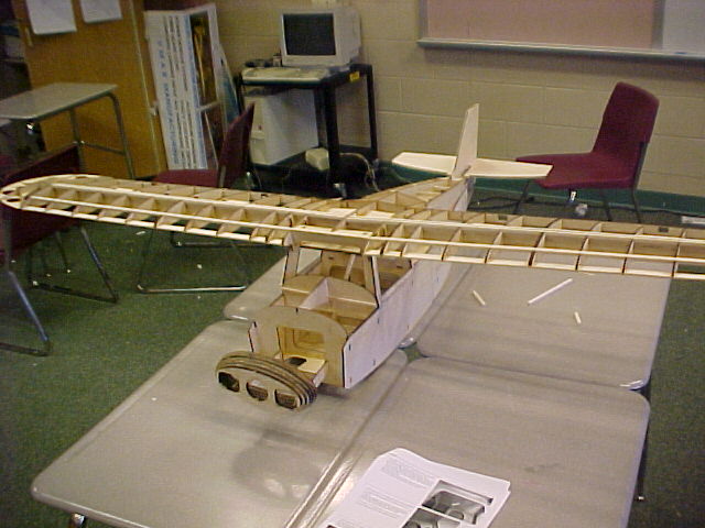

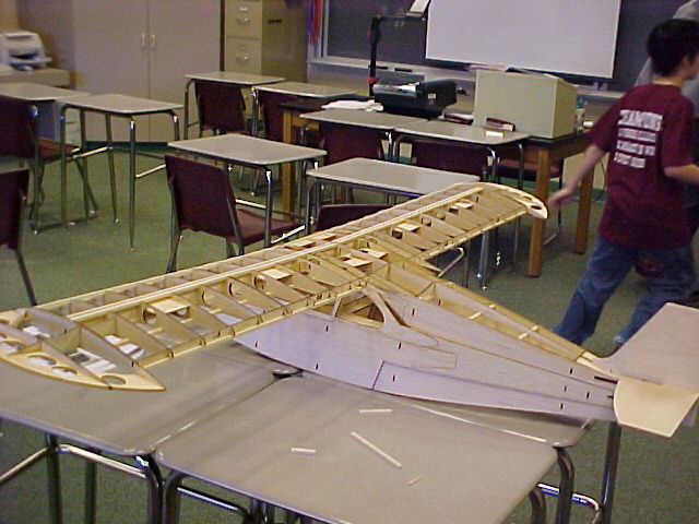

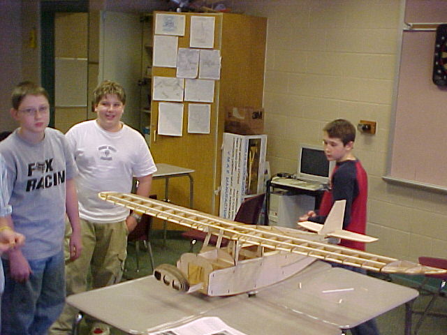

Today we were able to piece together our plane and take a look at it. I am staying after school to work on making the tail fit. Can't wait to fly this one.

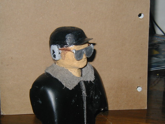

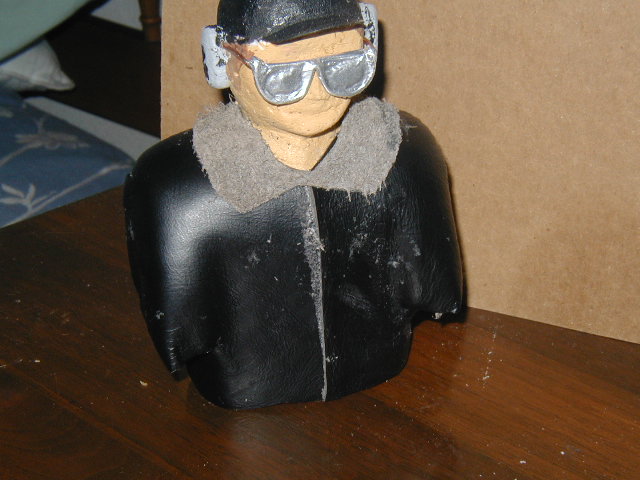

Afternoon Boys. Well the TriPacer pilot is as finished as he is going to get. See him below. I too have set this hobby aside a time or two. But I alwasy come back. I love to build them but I am such a klutz on the sticks that I give up and lay off for a while. I know the secret to flying better is practiceb but by the time I get my planes rebuilt I have a hard time reentering the game. This time I won't quit. I have a little Foam ARF that I am going to fly untill the tape on it weighs more than the original airplane.

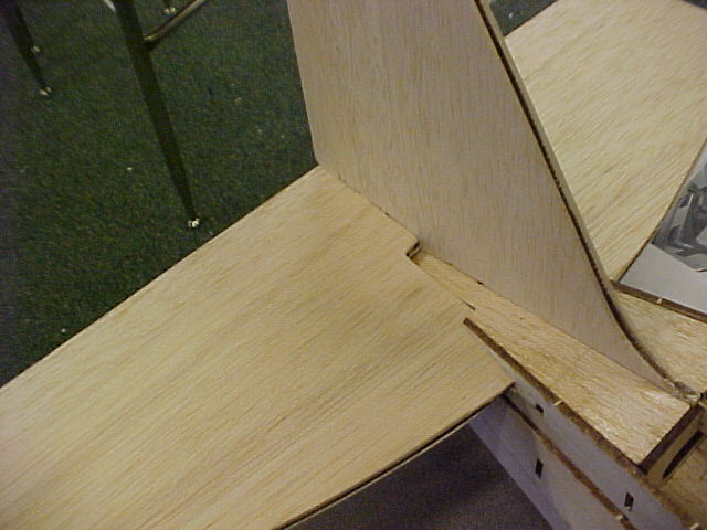

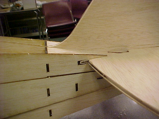

hILLEVILLE, The horizontal stab fix is a piece of cake. The slots it fits into in the fuse sides must be carried back through the top plate. Following the instructions it takes only a few minutes make right. Mine fit very tight in the vertical stab slot so a delicate hand is required to put them together. What I am saying is don't force it. A little sanding of the vertical stab slot may be needed. I glued my tail feathers with Gorilla glue. I think it's lighter than epoxy and may be stronger when used on balsa.

And yes, that is a fur trimmed leater jacket he is sporting. Ask me how I did it.

Brian--I flew for years by myself for fear of embarrassing myself by joining the club. A few guys from the club visited my school parking lot and crashed two planes and I figured I could fly with the best of them. I took second in my first fun-fly with the club. I really enjoy my club and the guys in the club. But I still spend a lot of time on my own. Would like to see pics of your LT when she is ready to go.
Roger and Ken--First off. What a scale pilot!!! The bar is pretty high. Tell me you took one of your jackets and put it in the dryer over and over until you got it to fit the pilot. I worked after school to get the tail together. Look at my pics. There are gaps underneath between the elevator and the upper fuse. I did not get my elevator to slide all the way in. Can I cover the fuse first and then install my tail set. There is space in the top. How do I finish this. More later. I like the way it all locks together. I'll tell you one thing, this is dead on straight and true.

hILLVILLE. No, the leather is glued over the pilot with 3 M type 77 spray glue on both surfaces and then stretched to shape. Easy as pie!

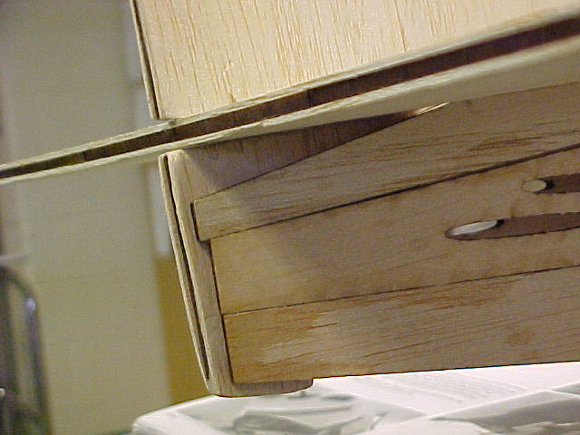

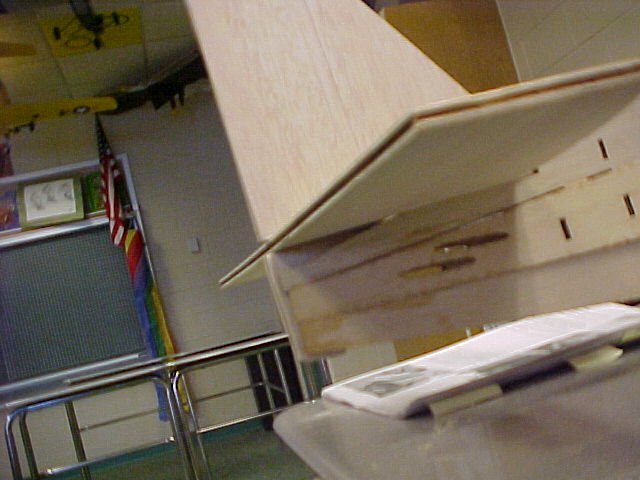

I found that I needed a piece of 1/8 scrap glued to the back side of the last buldhead for the horz stab to butt aginst. If the horz and vert stabs are completley locked, that is, if there is no gap in the interlocking slots then you are as far forward as you can go. When mine locked in, the tabs in the horz stab were still short of the rear bulkhead. Hence the scrap shim. You can ask Ken about it but I think the horz stab should have a glue joint at the forward end against the former/bulkhead.
From your pictures it looks like you still have to shape the leading edges. If that is so I would do that prior to installing them. It is much less difficult with them out of the plane and you lessen the risk of cuttung up the surrounding surfaces as you sand the edges.
Yours looks just like mine did at the same piont. All the gaps go away when you cover the tail unit. I have to do mine over so I will shoot some photos of how I do it.
More later.

Thanks. I started thinking about what you said. My guess is that those two tail pieces are not fully locked. That would explain a few things. They are pretty tight and I need to remove them and sand them so they can slide more freely. Apprecaiate the advice. I took that Balsa USA Laker out on the lake today. It's 41 degrees and the sun is shining. It slid a few feet and lifted right up. It kept lunging for some reason, I don't know if it was the servo, the radio or the wing was slightly loose. Long story short, the thing would hardly come down by cutting the throttle and then the engine died and it just hung in the breeze, and then the nose began to drop like a rock. Water absorbs crashes, ice really doesn't. Still in one piece but the wing broke at the bolts and the nose needed rebuilt. Looking forward to all pics.

Just be sure to leave that space behind the horizontal stab. The trailing edge of the horizontal stab should be forward of the vertical stab trailing edge to allow the elevator "U" shaped wire to pass through without restriction.

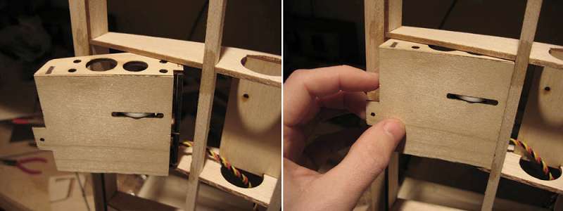

Hey Ken, while you are here I have a question for you. I am setting up my wing servos and came across a slight interference between the aileron and flap pushrods at the center section where they cross. Did you do anything different on your plane than is shown in the manual? I think I will shim the flap sevo up off the servo plate so the rods don't touch. Two layers of ply glued to the underside of the plate will be enoughto lift the servo arm and eliminate the interference. What do you think?

That's a very good idea. The kit changed twice since your version (thanks to many people like yourself). What I could suggest in addition would be to pull some of the nylon sleeve over the area of one servo, to give one of the rods a slight kink. ...However, if you look at the photos in the manual, you will see that the clevis setup is arranged to avoid interference. (see attached photo). In a later version, we put holes in the first few ribs to allow the flaps servo arm to sit opposite that of the aileron servo arm (pointing at the tail). This made the setup a bit easier. Later again, we developed the servo boxes that can still be retrofitted into all versions of the Tri-Pacer.

Ken, When I said they interfered I ment that the rods rubbed as they went back and forth. With both arms in the same plane there is a lot of stufff in close proximity. The flap rods actually rode on top of the aileron servo arm just along side the aileron clevises. I shotened the flap servo arm and moved it closer to the servo tray. Hopefully this will clear up any fricton or binding. If I were doing this again I would move the flap bellcrank plates about 1 inch toward the trailing edge so the rods would fit away from the aileron rods IE. on the back side of the servo rather than on the forward side as it is now. I am sure it will work out the way I have it now. Let me pass on a hint for working with the clevises once the wing is covered. I use a bent screwdriver blade (offset type) to open the clevises . A sideways twist will pop them open so the can be removed from the servo arm if the need fine adjustment.

Ken, do you have a pic of this that I could get before the end of the weekend. I assigned a kid to the bellcranks for Monday. He couldn't find the nuts in the hardware and his job was put on hold. I decided not to put those servos in the wing.

Ken, I think hILLVILLE needs to see the new ail & flap servo installation. That's the impression I got from his last post. Something about the servos. He originally thought about mounting the ail servos outboard but I talked him into the stock location, I think he wants to see the new setup with the boxes you talked about..

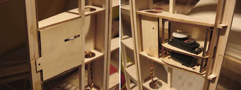

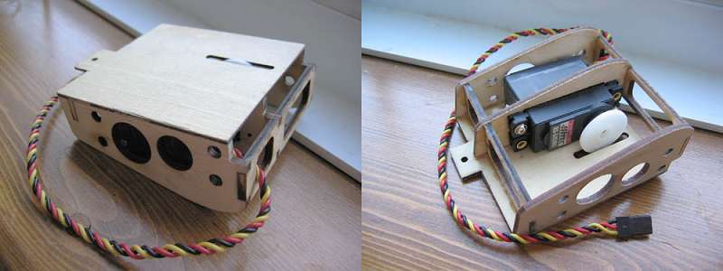

Ok, here are some images of the servo box. It hooks onto the lower rear spar and pivots up into place. Then servo are drops down to connect to the control surface. There is a spot to use a metal screw for securing the box. For safe operation, this was designed so that if the screw came lose, the box would not fall out - thanks to the control rod that would prevent the end of the box from falling out. The 1/16 ply panel will sit at the same level as the wing sheeting. Once covered, it will be flush and clean.
The holes on each side of the box are for alignment of your typical skinny screwdriver/hex wrench that would be used to install the servo. The mounting screws for the servo are easily installed with the aid of small pre-tapping holes. This design will allow a servo to be changed at the field in just a few minutes.
It's very light, and very strong. I suggest using light servos to those who want to use this. There is some talk about putting this up as a kit for use in any plane. It's been patented so this can take place.

With this setup, will the trailing edge be closed in? I love those servo boxes. They look great. ANd if something terrible happens to a single servo in flight, all may not be lost.

Ken, are you still using just two servis to operate the flaps and ailerons, or does the new setup use one servo per control surface. Are the surfaces directly driven or do you still use the bellcranks. I see the bellcrank mounting plate in the photos but do you still need them?
