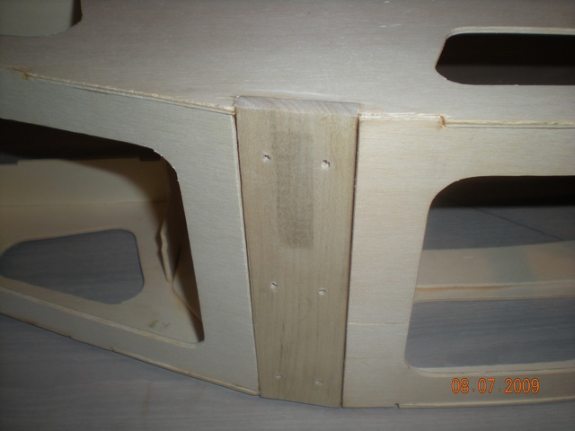

Looking good Big Al! That will be one sweet airplane.
I like the blind nuts for the gear. That's your design, right? That's a nice piece of hardwood you've chosen for the bottom of the fuse, I wouldn't think nice hardwood like that would come with a kit.
Which leads down another road; landing gear bolts, nylon or steel. Of those expressing an opinion, both on the internet and at flying fields, the choice is nylon. In my experience nylon hasn't improved the amount of overall damage from a crash. One lone nylon bolt may stay in during a crash and the now free swinging gear and wheels in the micro seconds of a crash causes other damage. My thinking now after experience with carbon fiber is to mount carbon fiber gear as rigidly to the airframe as possible. Regular steel bolts or screws into the fuse and let the carbon fiber take the brunt.
Sorry Al for going off track! Thank you for posting the pictures. You've made good progress and I'm excited there will soon be another Goldberg Extra in the fleet.

I'll use steel bolts. I have the same type of setup on my midstar LG. Last week I set it down in the soy bean field, bent the aluminum gear very badly, but the mounting plate held firm. Zero damage to it. My thought is tight is right.

Ilikebibes, the extra work you're doing with templates will benefit you. I'm not say a monetary benefit. Documenting the design is a good thing.
Therefore, it will take you longer to build yours. I hope you enjoy your build without the stress of the templates.
