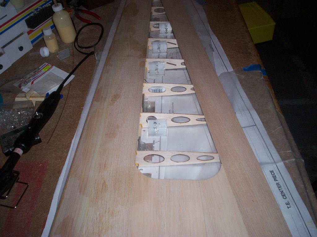

No one is in any hurry, it's fun watching your build. Did you get the sheeting figured out?? I would have told you how I do it but I don't use the wood glue for sheeting, I use CA and when I come into the house even my wife knows what part of the build I have been doing. I too started using more and more wood glue these days.

I did get the sheeting figured out. I'm pretty happy with the results too!
Just like with any new technique, it will take a few tries to master it everytime, but I think it works really well. It really looks like I caked the glue on the bottom of the skin. I didn't.
For anyone interrested in how I sheeted the wing using only Titebond 2, without the headache of pins and weights, here is the link where people helped me learn how to do it.
[link]http://www.rcuniverse.com/forum/m_9010746/tm.htm[/link]
There is more than one way to use wood glue. Some people like using both CA and wood glue. There are good instructions for that as well. I was even honored that Bax jumped in to help. Anybody could find at least one technique they would like in this thread. It's still growing too. Good info.

Yes. When you are ready to apply the heat (everything is lined up to end where it needs to end), start at the high poing of the wing (the spar) and work your way forward to the LE and aft to the TE of the wing.
This is where I blew it today. I found that trying to start at the LE to keep the seam tight and work my way aft to the TE actually pulled the sheeting away from the LE about 1/16th inch. I don't think I let the glue set up long enough. Mine is still salvagable. I still think I have enough glue surface to be safe. Chalk this up to the learning curve I guess.
My preferance when sheeting is definately in line with Sig's Hog Bipe. Their method is seamless. It may take a bit more effort, but it would be stronger, light, and possible straighter then the current method is- IMO.
Brian
p.s. I also think that the glue needs the 30 minutes to set up on both the bones and the sheeting. It sticks better- just like contact cement.
I have also found that after the glue has completely set up, you can still hit it with the iron and tack it down if you find an area you didn't get right.
Also, it helps to have the sheeting edge-glued and prepped before you install, rather than glue it on the wing one piece at a time.
I may document how I do that. There is no secret, but it is just magical how well alaphatic resins (wood glues) work for this!

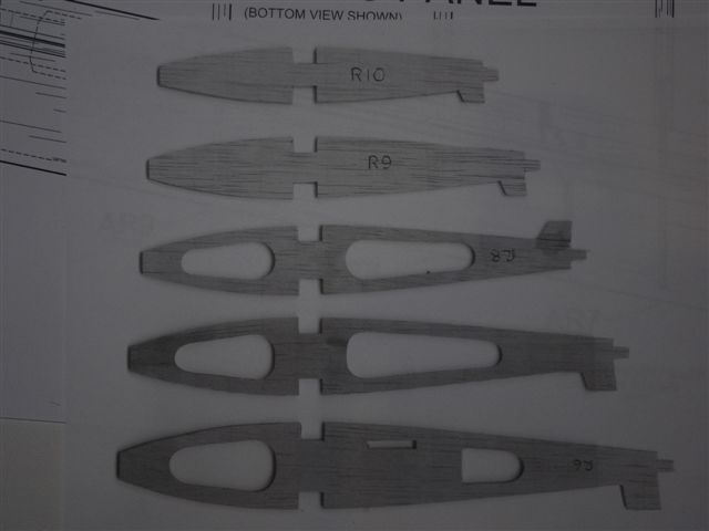

How about this for templates? I placed the cut out ribs onto a photocopier (lucky to have an office at home) . End up with a 1:1 print, I could even scan at 1:1 and email.
OK these are the GP ribs not the Goldberg but easier to make than card templates. paste onto balsa sheet and sand down to the edge.
Doesn't get any better then that!! I once did that for a fellow here on RCU for the Midwest Hots fuse formers. I didn't want to remove them from the sheet so I used a pen to highlight the outside of the die cutting. Worked out very well.
I always thought the copier put the copies out just a bit smaller than the originals. How well do the parts line up?

It is difficult to compare exactly now as all the ribs are glued into the wing, but a couple of key measurements indicate that the copy is ever so slightly larger (chord length of 225mm vs. 224mm measured on the wing). And that could be paper stretch or tired eyes after a hard day[&o]
I will check again when I do the formers for the Fuz.

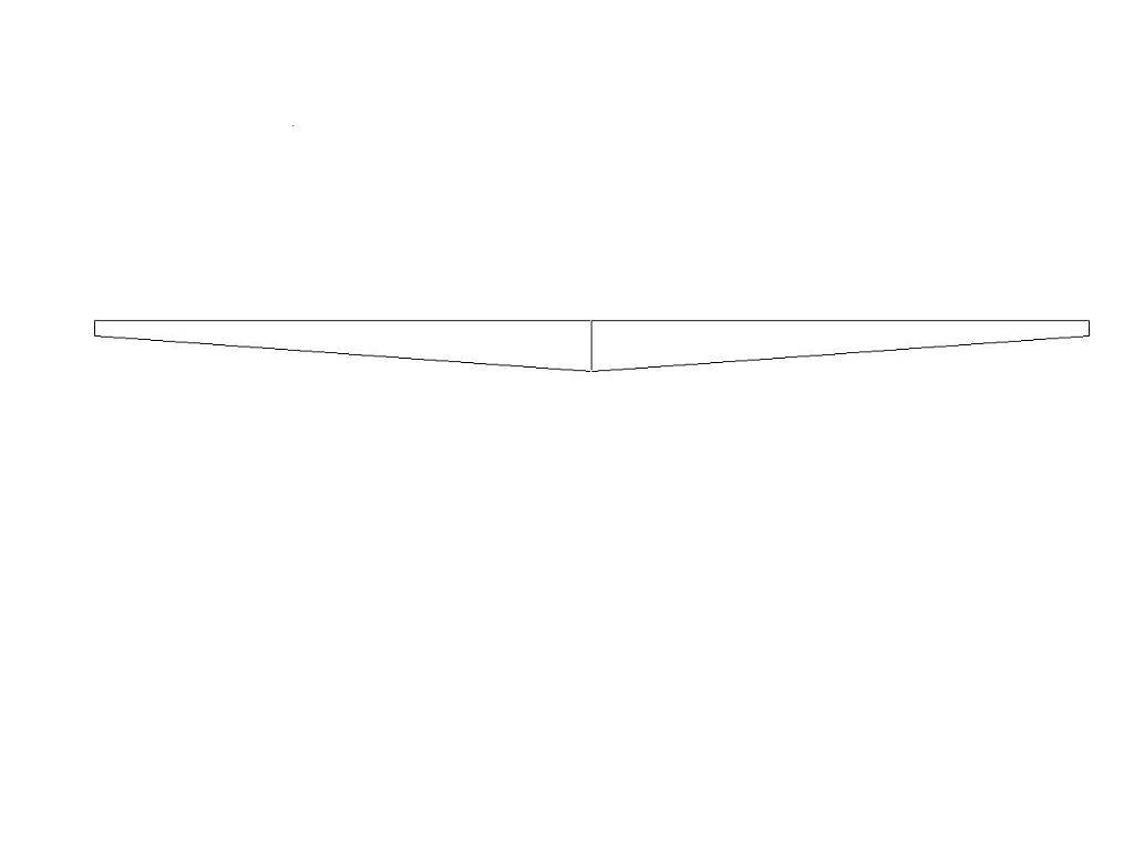

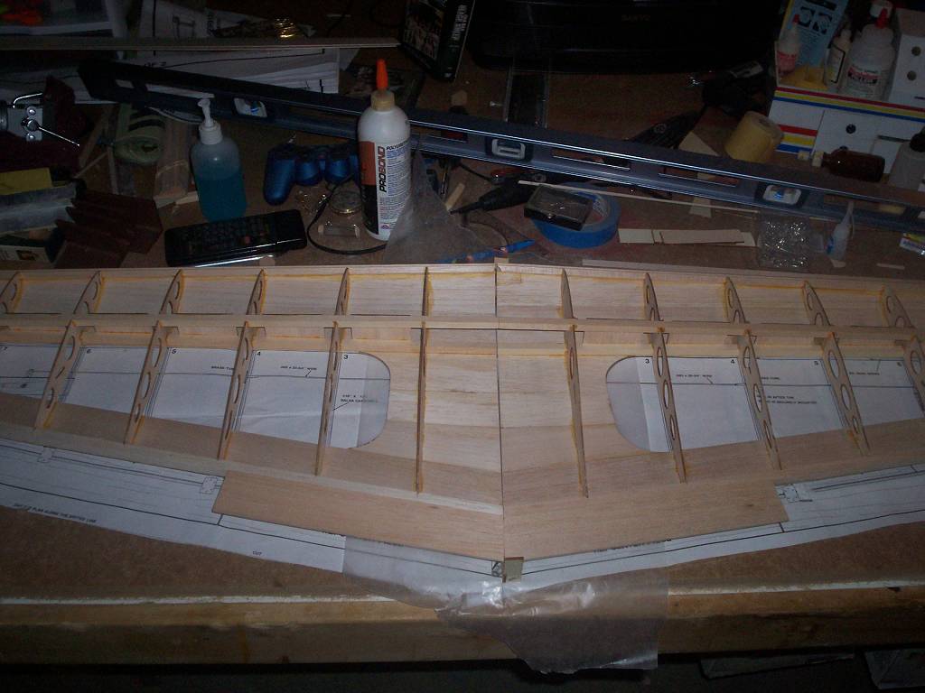

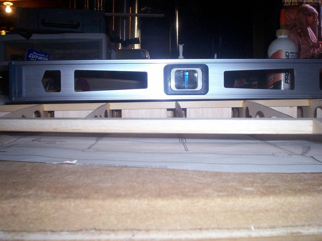

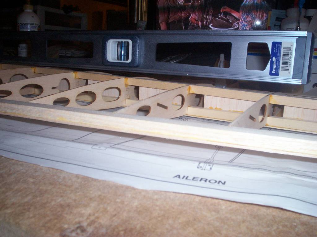

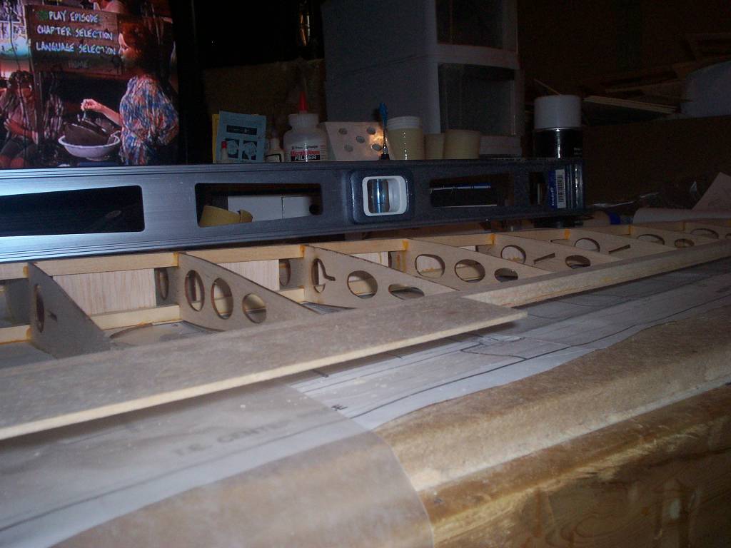

Pictures with questions!
Is the top of the wing supoosed to stay flat, or does it taper down like the bottom tapers up? It would be like having dihedral and anhedral.
Before I glue the two panels together, I thought I'd make sure.
Brian

You're fine.
From root ribs out to wing tips it's basically flat, but a level placed flat on one side of the wing (I assume it's flat on yours but not showing in your pictures) does result in exactly what your pictures show.

Is the 1st pic or the 2nd correct?

#2 is correct.

Default RE: Goldberg Extra 300
WHEW!!!!!
I was starting to think I might have messed up.
Brian
