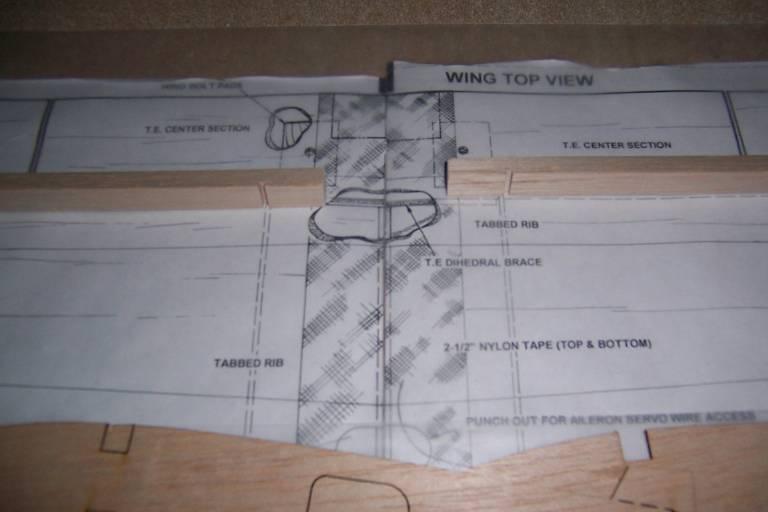

I am building a CG Tiger 60 and have run into a problem with the wing. The kit is supplied with factory made notched trailing edges. The problem is they are too short. Both the Leading and Trailing edge need to be 33 1/4 inches long (each wing). The supplied trailing edge is only 32 1/4 inches long. The supplied Leading edges are 37 inches long which requires trimming which is understandable.
Has anyone else built one of these kits before and if so did they have this problem? I plan on contacting CG tomorrow to see if I can get the correct pieces as they would be difficult to hand make.

It sounds like they cut the TE too short. I did not have this problem with any of the 60's that I built.
Before you trim the LE, double check the rib slot alignment, as it does make a difference.

If the rib notches will line up correctly, you might be able to just add some wood to OUTBOARD tips and shape it. Do NOT do this on the inboard section.

I was going to ask about adding stock to the inboard side, but you beat me to my question. The slots line up from the tips to the inner part of the wing. There will be lite ply sandwiched around these parts, that is why I was going to ask if I could butt joint some stock. I have added a picture to show where I would add the stock.

This may be a stupid question, but are they sitting the right way? That is, maybe those are the outboard ends?
I only ask because I have seen people make this mistake.

Yes they are lined up correctly. If I had taken the picture standing back a little farther you would be able to see that the notches are lined up correctly and that they can only be installed one way. CG acknowledged the problem and it appears at least one other person experienced the same problem. Even if I was to turn it around, it is still too short.

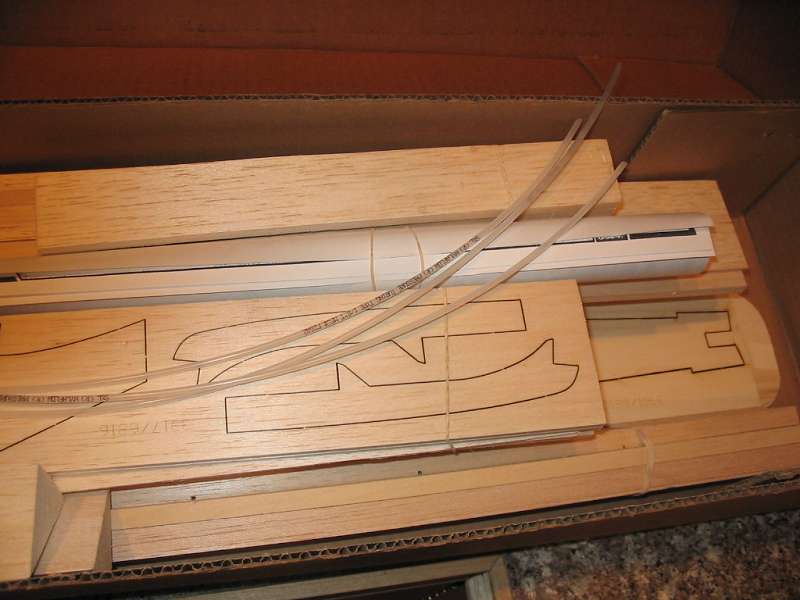

My tiger kit was perfect. The majority of the parts are laser cut. In the picture you can see the fuselage top former.
