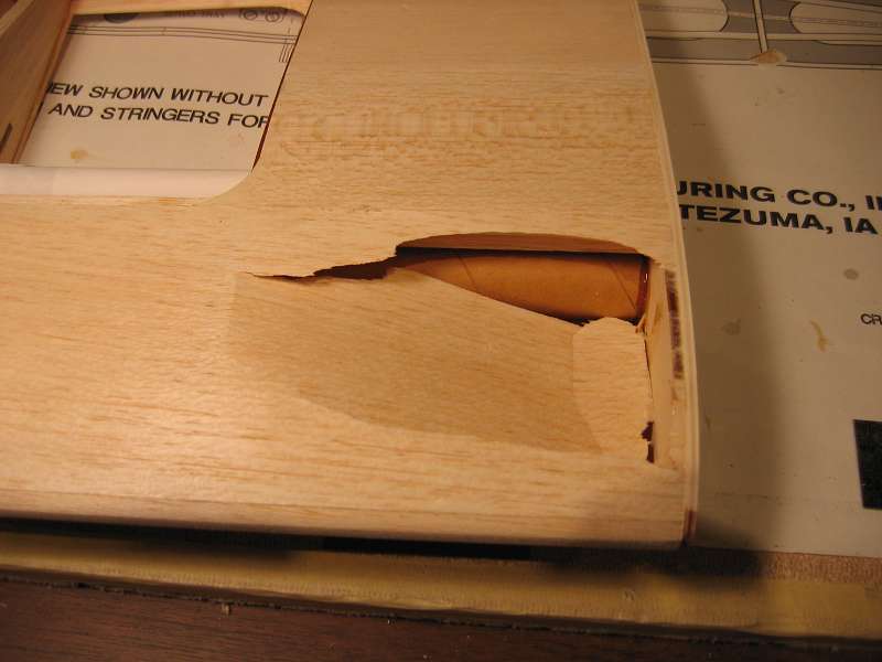

I started working a little on the SE again. Here's my "progress" so far.
As you can see from the first picture, when I started sanding one wing half, I broke the sheeting[]. The balsa for this wing was so thin, I almost applied no pressure and it broke. In fact, as I was repairing the damage, another section broke[>:]
I replaced it with a little denser sheeting, and it should be ok now. I'm pretty much done with the sanding. I still have left some rough spots. I started sanding with 150 grit, then progressed to 330 and finally 600. I have now learned that with 150 grit sandpaper, I can quickly sand down too much....Will keep this in mind for my next build.
Last night I cut all the hinge slots and replaced the landing gear with a taller dubro one. Tonight I will reinforce the control horn areas with the supplied tape, do some more sanding and I should be ready to cover the SE next week.

It's looking great and you have made good progress. I know what you mean about the sheeting though. I had to repair mine in a couple of places as well. Watch yourself when you cover so that you don't put a thumb or finger through the balsa. It is real easy to forget and put too much pressure in the wrong place.

Next one I build I might glass the inner sections of the wings where they are sheeted. I have found that when I pick the plane up off the starting bench at the field the surface is just too spongy for my liking.

I agree, it's very spongy!! But if you glass the center section, can you still cover it with film?

You bet!! Don't you remember when you built your trainer (unless you did an ARF) and after you put the two wing halfs together you put the strip of fiberglass at the joint? The covering went over it just fine. I'll be glassing the entire airframe of the P-47 I am building but then I'm going to paint it, but I thought about covering it with ultracoat as well.

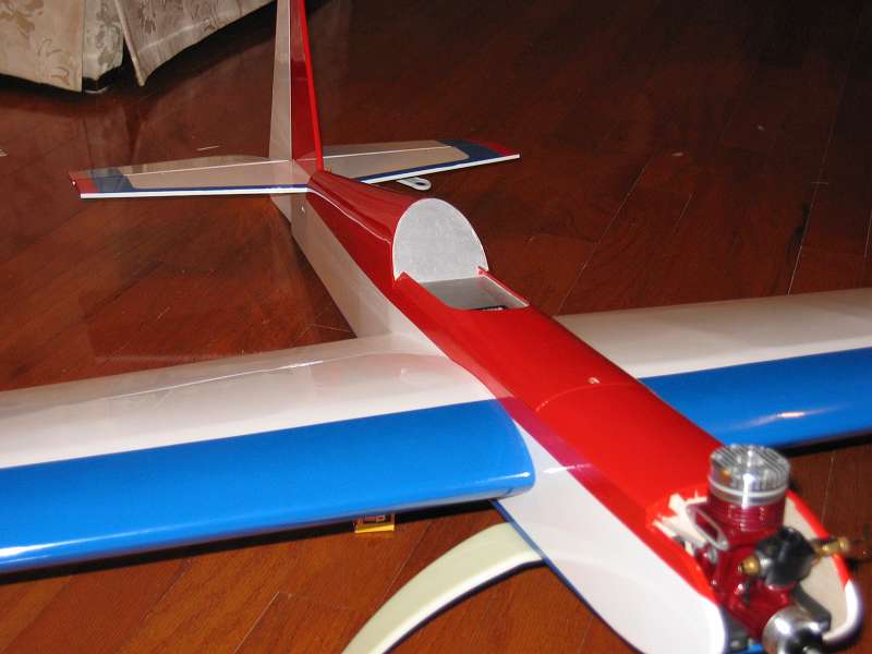

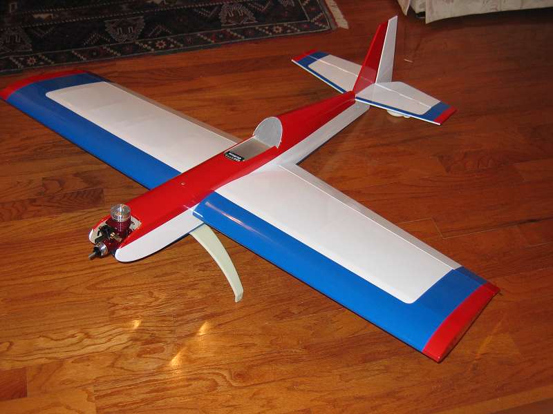

I've gotten started on the covering job, but I must say it's taking time since all I have time for right now is spending about 1 1/2 hours four nights per week. Anyway, here's the results so far. I'm hoping to finish off the fuse and the remainder of the trim this week as well as CA all the hinges and glue/sand the wheel pants.
So far, covering with Ultracote has prooven to work pretty well as long as I take my time and don't rush it. The only problem I had was when doing the blue cover on top of the white on the wing-tips. Ultracote on ultracote doesn't work well at all[]
Now I know...

Looks great but Ultrakote on Ultrakote works the best compared to Monokote on Monokote. Monokote's glue property's result in the release of gases that create many air bubbles in the covering. Ultrakote goes on very well
I ran out of Ultra when covering mine. I have one wing panel covered in Mono now. The Mono panel warps and wrinkles in the back of the warm truck Grrrr but it sure is a lot shinier

Hughes500E: This is just the problem I get with Ultracote on Ultracote, i.e., lots of air bubbles. It sort of works over a solid surface, but over an open area such as the wing between spars, I get a lot of bubbles. What is the trick to do this properly?
Alos, I've finished covering the fuse and I have a question: What's the best way of opening up the hole for the wing joiner tube? For smaller holes I just the solder iron trick, but is this the best way for such a big hole?

I used the same method for the large holes as the small ones. Just use the soldering iron and go slowly and it should melt it just like you want. I keep a spare (read old) gun in my shop just for this purpose. It is great for melting the covering and opening the holes, but does not heat up enough for soldering anymore.

I had great success with Ultracote over Ultracote by using windex and a squeegee to get it in place. Then let it dry for a couple of hours and follow it up with an iron on low heat. All of the orange on the T2 in my gallery was done that way and there isn't a bubble to be found anywhere.

krossk: In another thred, the advice was that the windex/squeege method doesn't work with Ultracote. Only with Monokote on Monokote or Monokote on Ultrakote. That's why I didn't try this method.
I will try the windex method on the remaining trim too see how it works for me. Thanks for the info.

You are correct in that the windex will not activate the adhesive, but it will allow you to position the trim piece and eliminate the air bubbles. This gets the piece in place securely enough to seal it with the iron. As long as you keep the heat just high enough to adhere the trim, but no higher than absolutely necessary, I found the results quite satisfying. The guys in my club could not believe that was my first covering job!
Good luck with yours - I'm likeing the trim pattern you've got going. I may borrow some of the lines when I get to mine

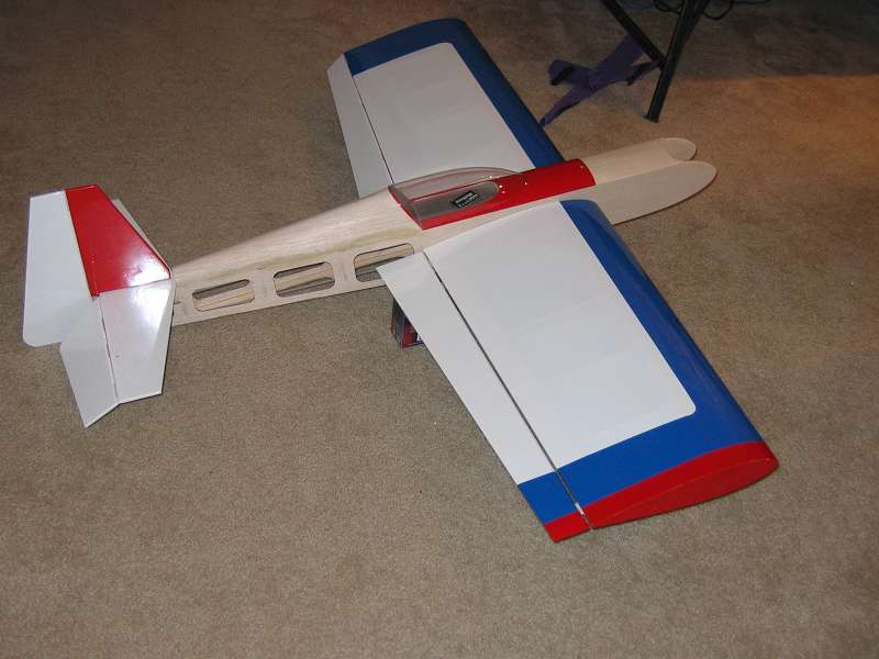

I made som more progress the last week, but as krossk said, the kids take time and doesn't leave much for building models at the end of the day. Here's my slow but steady progress:
I dyed the canopy dark and glued it on.
CA all hinges. Had to redo one aileron that was binding due to a off center hinge.
Epoxied the tailfeathers.
Built, sanded and spraypainted the wheel pants.
Here're a couple of pics including the bottom:
