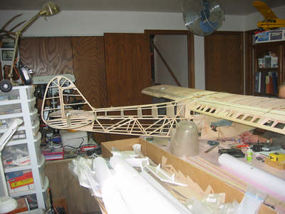

I'm covering with White Solartex with dark blue sunburst. The pop machine is 5' from my work table, somtimes making it hard to work late at night. I didn't receive my kit till the beginning of Nov. & only work on it on nights & weekends. I guess I really don't have a life outside of this silly hobby. Bob

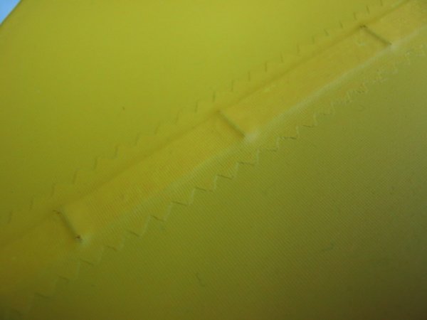

Hi Tony - having read through your fun & games with brushmarks I thought I'd try something a little different as an experiment on the J3.
It too, is being covered with Stits Lite, which I did fasten with PolyTak, but then I thought I might go back in time somewhat, and try a more traditional approach from there on, to see how it would behave.
Now, I know that the following is NOT recommended by PolyFibre but hey, it seems to work really well.....
One coat of Nitrate dope overall.
My 'rib stitch' strips were then lightly held in position with a stripe of more nitrate dope. Not a lot, you just don't want them to move about.
Pinked tapes then over them, brushed into position with a good coating of more dope, making sure that all the points are down. Finger rubbing is ok, but not really needed.
Allow to dry. Check the points, and lightly dope down any that are not fastened.
One further good overall coat of dope.
Allow to dry.
Very lightly sand with 4-600 dry to get rid of any nubs etc. Nothing more.
I'm then painting using latex (http://www.houstonhobbies.com/tips/p...ying-latex.pdf) which works like a dream. Limitless colors, the price is very right, and it really sticks like the proverbial you know what...
I've attached a pic of the rudder that's only had one very light coat of latex so far, so you can get an idea what it looks like - not a brushmark in sight - and no heavy sanding either.
It's a little transparent right now, but a few more light coats will solve that.
Food for thought?
Mike

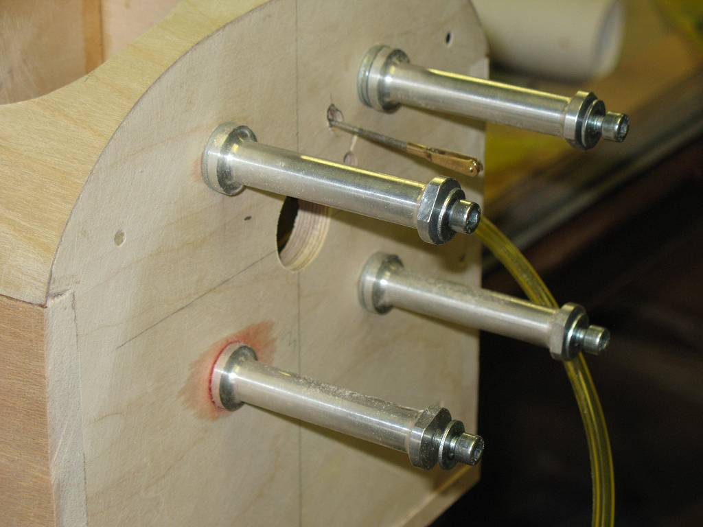

It looks like the plans call for the firewall to be 90 degrees to the thrust line and the engine shimmed to give 2 degrees of down thrust. I was thinking of building the 2 degrees in and avoiding the shimming. Do you see any problem doing it this way?

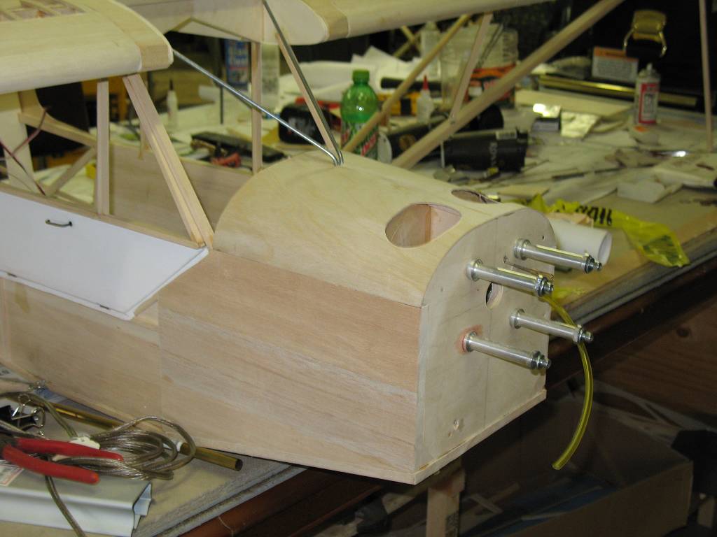

My memory is 2 degrees down thrust, zero right thrust. The first photo clearly shows the down thrust, the second photo shows right thrust, don't mind the dirty laundry, can't see any right thrust built in. Maybe some successful builders can weight in here, I'm still painting so I can't report if any right thrust is necessary or not. From my experience right thrust is only necessary on grossly overpowered airplanes, I don't expect my build to be overpowered. Posted some photos of the progress.

I called Dave from Balsa-USA about building in the correct amount of offset. He is against that, he said you don't need to do that. Dave had me, looking at the plane from the front, put 2 washers under the upper right side, 1 washer under the right bottom & 1 washer under the left top motor mounts. No washer under the bottom left. I am using a DLE-55 & put the motor mounts on with red loc-tite before I put on the sheeting. I'll make any adjustments from the outside if I need to later. I hope this helps. Bob Johnson
