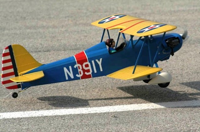

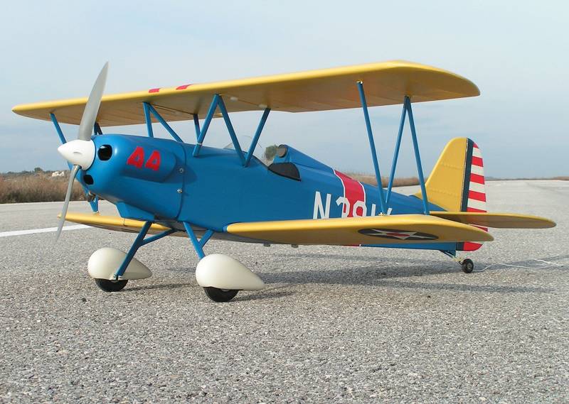

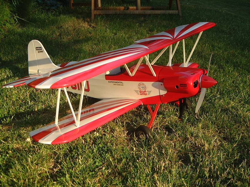

My gear fairings are from soft balsa and wrapped with tissue and dope before painting.
They're only attached to the wire, and not the fuselage bottom (only touch it, but not bonded to it).
Have flown it a lot, no problems at all.

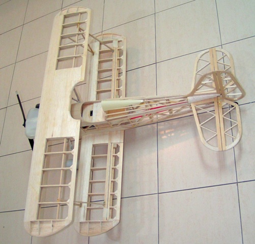

Hello,
hardnut - Thx for the pdf

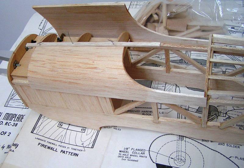

Here is photo of my Smih's mini. taken from today. And in how's it look its after 35 hours of work. Well first time I've decidet to count time (start to end of work each day and comment what was done) When I'll finish, i'll post a schedule
. I think building smiths is so much fun. It's my first kit, in past I've done only scratch building, but I was a child then. I've decidet that te powerplant for it will be an ASP 61 FS. hope not to strong, and covering with Coverall, with box scheme painting
. Just cant wait for finish

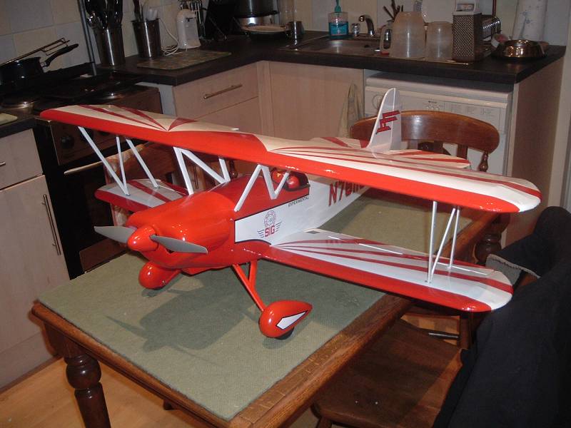

I have a Miniplane and became frustrated with the trim on the U/C coming off. I have since used plastic page binders on mine and have also added them to the N struts. Fuelproof, the correct airofoil shape and smart looking to boot. I'll get a pic and mail it here.
Is anyone having issues with 2strokes overheating inside the cowl? Mine flies fine without a cowl but as soon as I mount the cowl the engine gradually tightens and is clearly getting too hot.
I'm using a Webra speed 40 with a bisson pitts muffler and it has enough power to hover my mini.

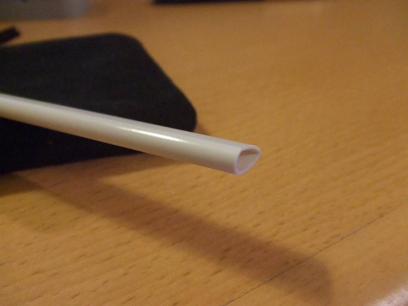

Chrispeace
Thanks for the idea about the plastic book binders ,as i have said before i have covered them with solarfilm but have only flown it twice since then (great british weather and work[&o]) so will try that if mine still doesnt work.
im afraid i can't comment on the problem you are having with your engine as i have used electric in mine ,only thing i can say is if you can hover then you must have loads of power i would try a smaller prop ! (less power/less heat) as this is not a 3d model 30+year old design
rob
rob

Crispeace,
Nice looking plane! An idea on cooling with the cowl on. Looks like your exit air area on the bottom of the cowl is very small. I would suggest increasing that in size to at least twice the inlet air area. Also the inlet air coming in the cowl blisters on the side could just be exiting out the back side of the blister if that is open. You might try to redirect this inlet air down with a couple of diflectors so that the motor is in the cool air blast. Not trying to tell you what to do, just some thoughts. Again, very nice plane.
JEB
JEB

More Pics. Have blanked off one inlet to change the inlet vs outlet ratio. The outlet underneath is now a lot bigger with the pitts silencer on so that should help. I will see how that affects the cooling once the British weather turns nice again.
