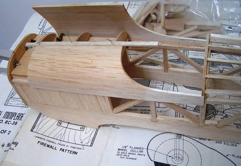

Thanks much for this thread. I just started my SMP a week ago, been sitting in it's box for over a year. A couple things I've learned, the hard way, that may help any one else building this kit.
Do not put the cockpit floor in before gluing up the 1/8" nose balsa. this is the only access to the formers from inside the fuse.
Do not glue in the 1/8" balsa nose bottom before fitting the cowl. Fortunately, I was planning to install a removeable hatch in this area, decided to glue up the cowl and test fit it first. The plans manual says " Careful shaping of the nose is necessary to achieve a good fit". What an understatement! Spent a couple hours carving and sanding the nose! Finally got a "good fit". The bottom would have had to come back out had I installed it first.
That's it for now. Just have to decide on a color scheme. Looks like I should have plenty of time to decide!

Here's a tip for when adding the top fuselage sheeting - prepare the cockpit cut-out in the sheeting before you glue it on - makes bending it into position much easier.

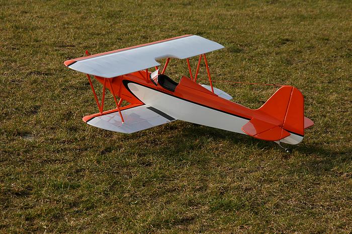

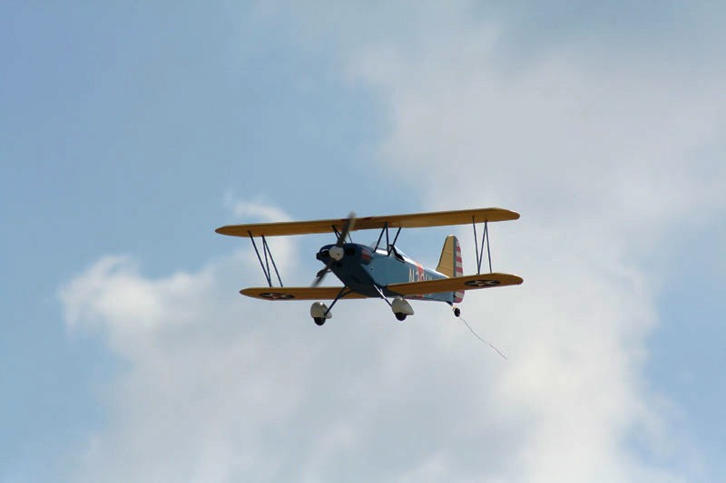

I read the whole story and just could not resist to show mine
It took me over 6 months to build but at last I finished my Miniplane the other week.
It is powered by a Saito 56 with a Perry Pump. Covering is done with Oracover and matching Oracover paint for the pastic parts and struts (this paint is really great stuff to work with!).

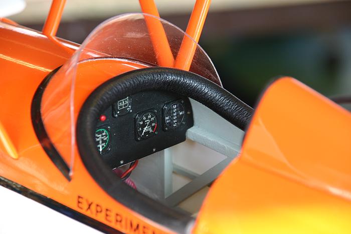

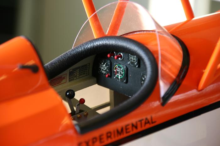

The instruments are 1/5 scale instruments which are supplied by several brands (same item, diffrent brands....) The ones I got came from R.E.M. but Robbe supplies the same (# 1-6156). The instrument on the right side is modified to a voltage gauge for the 2 receiver batteries.
The 2 red knobs on the left side are toggle switches which are cut to the right length for scale appearance. They operate the solid state receiver switches.
The throttle quadrant was scratch built after a part from the aircraft parts supplier Aircraft Spruce (http://www.aircraftspruce.com/catalo...hbthrquads.php). Once I have the time to hook up the cable to the throttle servo it will move too.
Most of the decals I used are scaled down previews from the internet site stated above and other inernet sites.

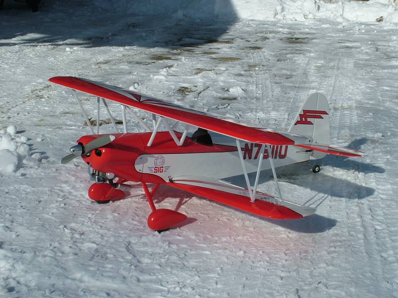

I expect the 50 four stroke will fly it in a very scale like manner. However, i doubt that you will have a lot of extra power for aerobatics, which this plane is very capable of.
Truely a sweet flying little bird. Here is a pic of my 23 year old Smith MiniPlane. Not quite as nice as those pictured in here.

Should I move the CG forward or even give the top wing a negative incident angle?
Is there anyone who made this kind of adjustments to this kit?
Last Saturday my Miniplane finally got its maiden flight. Allthough I didn't fly it myself the plane looked very nice in the air.
I allready read that this plane had a tendency to climb but the person who flew it was not happy at all. The elevator was trimmed down for approximately 1/4 " and the plane still climbed. During the flight the behaviour was checked with a few maneuvers to find out what might be the cause (CG or angles). Allthough the plane was landed with the fuel tank still quite full to keep the CG as much forward as possible it stalled close to the ground. The good news is that damage is very limited and can easily be repaired.
The bad news:
Today I did some measurements to check the incident angles of the wings and stab (again). Everything was within 0.5 degrees from neutral. I also checked the the CG again wich was in the place as indicated on the plan.

Mine climbs if the elevator is at nuetral and as you found needs about 4 to 5 deg down to hold level. Don't try to land this too slow as it (mine) is heavily built so is not a floater. Some have written here about shimming under the rear bolts on the upper wing but I have not tried this. Please don't crash that incredible example again. It deserves some serious air time as you have put so much effort into it.
