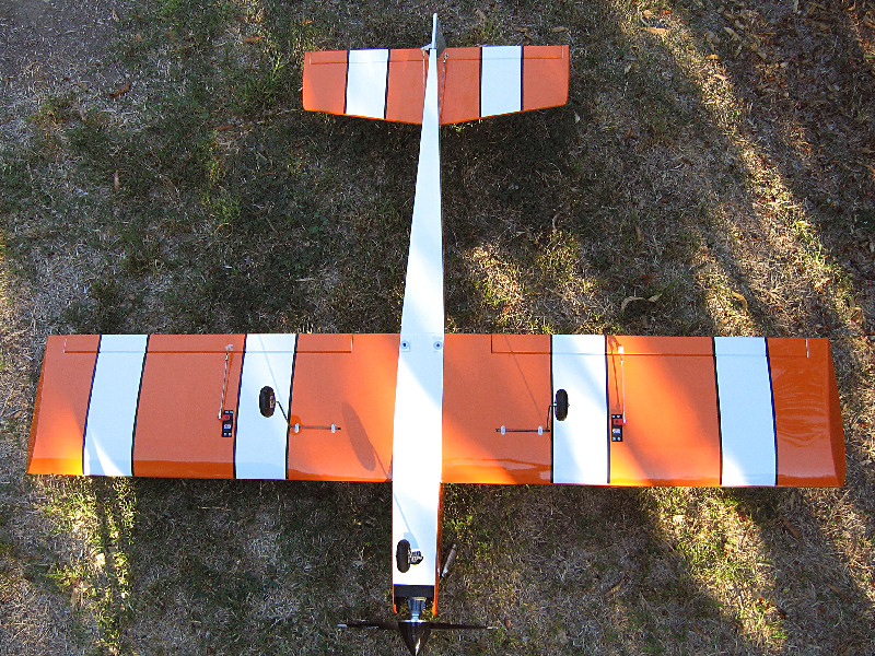

#164
My Tiger 60 is ready for maiden. I didn't document the build since I'm so slow - took me 5 months to finish the kit. Just thought I'd show off a few pics. Also thanks for the info in this thread which helped me out on my build.
#165

Thanks tessex, I really like your covering job as well. I was looking for a nice sedate Sunday flier for my 1st glow build, so I built the plane stock except I used 4-40 hardware for the push rods and bent the main landing gear back a bit so it won't fall back on its tail. Oh yeah, I also made the fuel tank tray removable so I could put the battery under it.
Oops, I forgot the particulars didn't I? It has a Magnum 91 four stroke with 13x8 prop running on Cool Power 15%, and Hitec HS-475 servos all around except for a standard servo on throttle. All-up weight looks to be around 8 lbs. (on the bathroom scale). I'll let you know how the maiden goes - hopefully will be tomorrow.

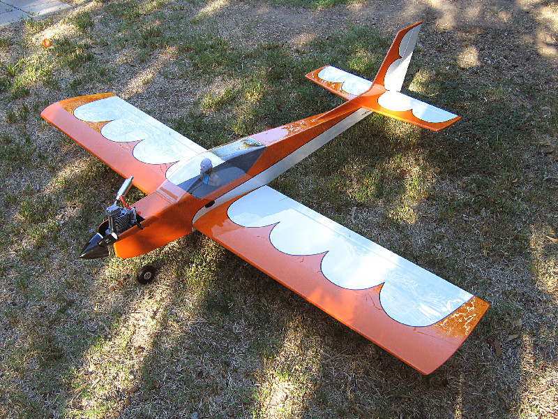

Ok Avnut, I gotta know,
1.how many hours did you spend covering?
2.Did you used pin striping or is it one of the markers you can use for the dark highlight between the orange and the white?
3.What was you inspiration for the scheme you used?
I think both planes in this thread that have been covered, I believe yours and Toms', look great and have given me some ideas for my
scheme. For me coming up with a pattern to used and color has been more of a challenge than building. So far I have decided to use
black and Cub yellow with the yellow being the dominant color.
I like your pilot too. My buddy has the same guy in his Hellcat!!

#173
Hey dlan,
1. I don't know exactly how many hours it took but it was a LOT! To get the scallops I first had to draw them out on poster board, and then cut them out and trace them onto the Monokote and then cut that out - very time consuming. I used the Windex method to put those on so had to wait overnight for it to dry before ironing it down.
2. Yes, I used the Great Planes pinstriping tape - very easy to apply and seems to be sticking well so far. The orange and white looked pretty plain, but the black really made it "pop."
3. I have that Monokote poster that shows some covering schemes and that gave me the idea for the top. I chose the bottom scheme to be simple but much different than the top so I know whether I'm inverted or upright. The poster is only $3 and shows a bunch of different schemes. Here's a link:
[link=http://www3.towerhobbies.com/cgi-bin/wti0001p?&I=LXJA14&P=7]Trim Scheme
Poster[/link]
I spent a while figuring out what scheme to go with also. Once I had an idea of what I wanted, I just started drawing out different schemes on paper with colored pencils until I was happy with one. Black and yellow is a good contrast, so should be easy to see. Oh yeah, I chose orange, white and black because the plane is a Tiger, so those reminded me of a tiger.

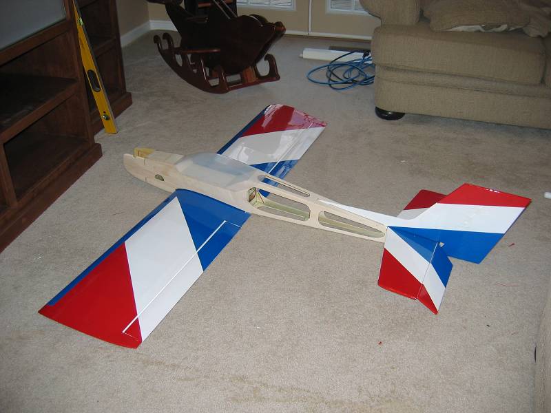

#174
dlan,
Before you get hard set on your colors, here's an article you should read: [link=http://www.ultimatecharger.com/color.html]Don't Color Me Gone[/link].
It points out a few things about how to design your color scheme to help you keep orientation on the plane, both up close (like while landing), and at a distance (where your color vision disappears and you only see gray shades). I tried to follow his ideas. My roundels were intended to give me dark circles in the white wing to easily identify the wing bottom. The angles of the colors on top are designed to point to the nose.
Oh, and thanks to you and all others for the compliments on my plane. Now if I could just find an Uncle Sam figure to be the pilot!
Tom

#175
AVNut,
Interesting! I sat down with MS Visio and drew a simple top and bottom view to play with the wing colors. I also used poster board for patterns. For my roundels, I cut out a circle the size I needed from poster board. Then I sprayed it with spray adhesive and stuck it to the plastic on the back of the monokote, cut it out, and then peeled the circle off of the poster board.
Tom
