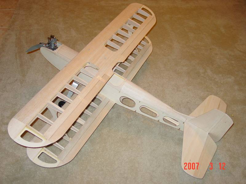

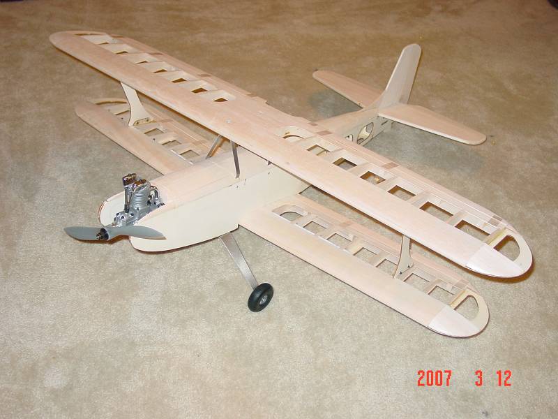

Some updated pictures of my Hog Bipe.
I need to hinge the control surfaces, then start filling and sanding smooth in prep for the Koverall.

Yours is looking good too, I have hit the wall, and have not made much progress on it recently. I am to the smoothing and sanding phase. It is not hard work, but I just don't like doing it. I have been finding all kinds of other honney-dos to keep me away from the plane.
One thing I did that is not shown in the plans was to add some balsa to "fair" in the cabines at the fuse. I did not like the huge holes that are there. I also plane to make it permanent so i can use it as a good carrying handle when it needs to be moved and that way I won't have the screw heads on the outside of the fuse.
One thing I wish I had done was drill hole in the formers for the antena to run in a pushrod tube. I had not thought of that, and now I would like to do it, but it will just have to be glued to the formers as best I can. I might try to get in there with a pin vice, but I doubt I will be able to.
I also put my last former in backwards, the plans are really confusing on this, but I don't think it will be a big issue, as the elevator can be controled from either side and I plan to run pul-pull cables for the rudder.

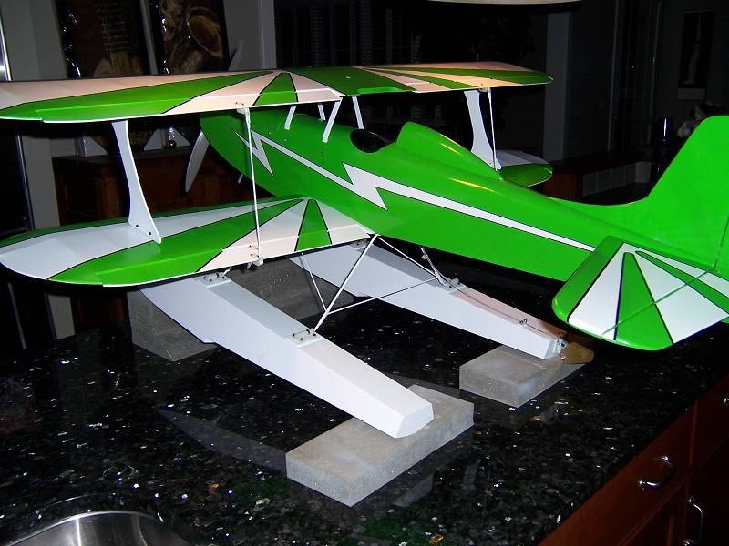

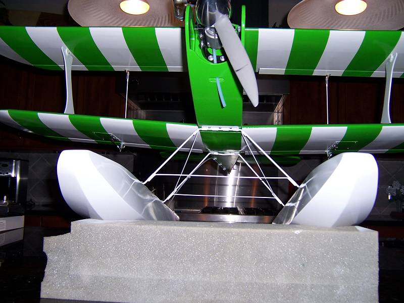

It's done!!
Yep, another lime green hog bipe..... This one on floats with a saito 100. HS-635's all around, dual aileron servos, Koverall, latex, automotive clear. moved gear mount forward in case it ever sees wheels, and beefed up the tailwheel area for a sullivan unit instead of the stock wire. Also added a hatch for the fuel tank. The throttle linkage is a new one for me, it uses an aileron connector attached to the threaded end of the solid-wire threaded pushrod, and a very short connecting link with a clevis on one end and a ball link connected to the throttle arm. no binding. Will maiden this week!

Alpinestar, Great looking bird! My bipe didn't live long enough to try it on floats. Where did you place the step, right on or in front of the cg? I plan to put float attach points on my second one and have them on my just completed astro hog. I like your attachment on the front of the float, how did you do that or can you do some closeups of it by chance. And what gauge wire did you use for the cross bracing on the float gear? Sorry for all the questions but your plane looks great and I live on a lake and want most planes water capable. I want to hear how well it does. Good luck on the maiden.

ORIGINAL: alpinestar
That is one of the most elegant solutions i've seen so far for a 4-stroke throttle! no binding either, i'll bet. another one to put into the brain bucket!
