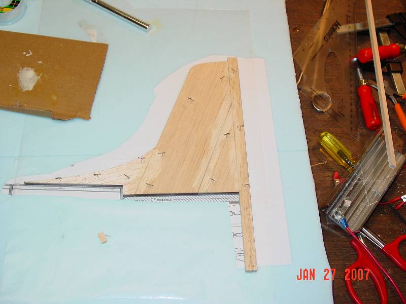

Well, I finally started on the bipe - I have to say, this being my first build may prove to be a little more challenging than I thought. Any way, I have taken a couple of pics, so feel free to voice your opinions, or share any building tips..............

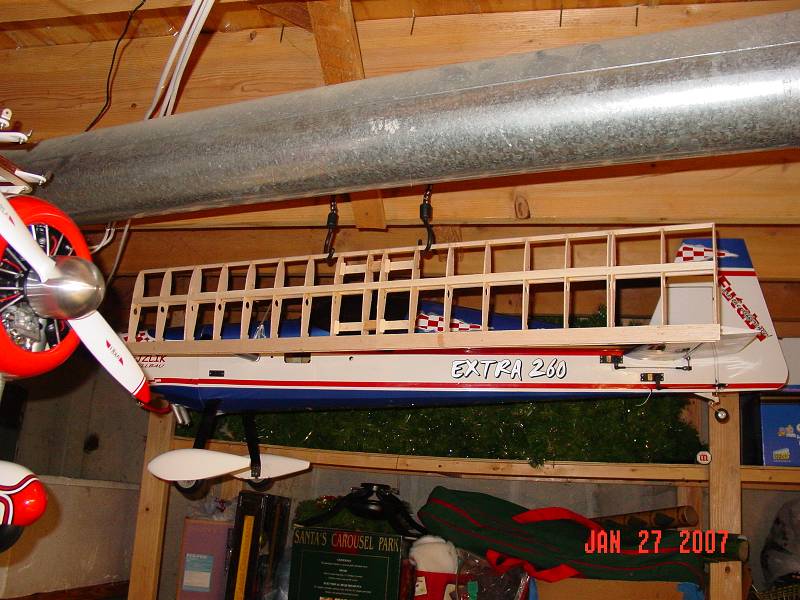

Old 01-27-2007 | 11:27 PM
xman2004's Avatar
My Feedback: (59)
Joined: Aug 2004
Posts: 88
From: Hanover Park, IL
Default RE: Sig Hog-Bipe kit.
Ok, here are some more pics - the top wing is coming along pretty good, still needs to be sheeted, the trailing edge needs to be glued in and the wing tips... - I got it temporarily off the building board so I could build the stab and the fin......

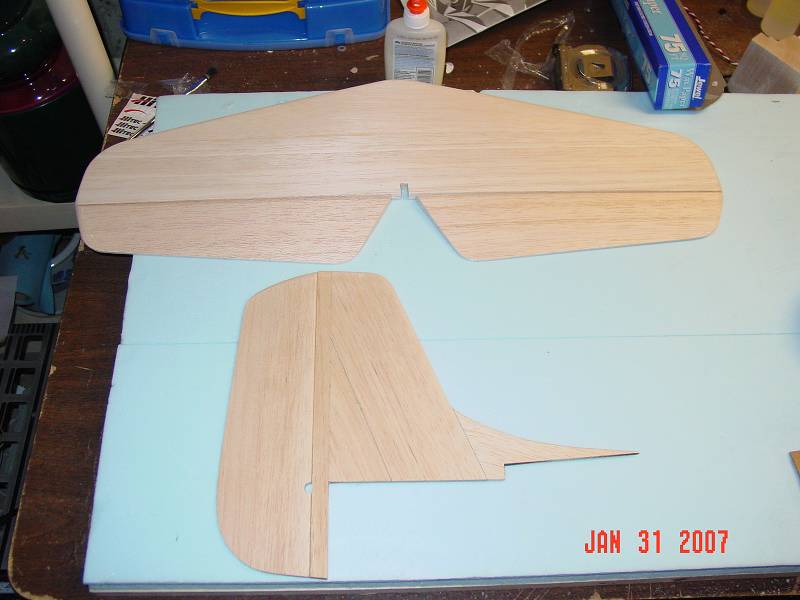

Old 02-01-2007 | 10:47 PM
xman2004's Avatar
My Feedback: (59)
Joined: Aug 2004
Posts: 88
Here are some more pics - the tail surfaces are done, just need to join the elevators, few more details left on the top wing....

Old 02-02-2007 | 07:58 AM
My Feedback: (14)
Joined: Jun 2002
Posts: 2
From: Pekin, IL
Watch when you set the dihedral on the lower wing very carefully. It will determine whether or not the interplane strut line up properly. Looks pretty good, very good in fact for a first build!
Old 02-02-2007 | 08:15 PM
xman2004's Avatar
My Feedback: (59)
Joined: Aug 2004
Posts: 88
ORIGINAL: mcmike
Thanks Mike.... should I than set the dihedral to specified 6 degrees?...
