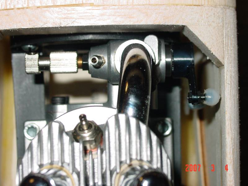

Here is my Hog Bipe that I am building. I still need to sand the tips of the wings to the proper shap, cut down the lower ailerons, shape the LE of the fixed portion of the rudder (is there a name for that?), mount the lower wing, install the radio gear, hinge the control surfaces, and install the tri-stock to blend the wing into the ailerons in a scale type manner.
Plenty of work still left to do.
I also plan to cover it with SIG Coverall, and this will be my first time using that product so it should be interesting.
I put the engine as far back as I could, I doubt I could have gone any further with it. The linkage for the throtle turned out better than I expected and it now will enter down low under the fuel tank floor. Now I need to figure out how I ill route the fuel lines through the firewall.

With the engine mounted this far back, is the throthle cam necessary, or can a straight push rod be used?

What I did was to not use a "cam" but with a music wire pushrod, go out past the throttle connection on the cab, and bend a "U" shap in the pushrod, with the pushrod connector coming back from the front of the engine to the throttle connection... I know, sounds weird, but it works.

I did the cam (bell crank) to lower the throttle cable under the fuel shelf. If I had not, the throttle would hit the fire wall if I wanted to get full throw. It also would be almost above the fuse if the throttle was aimed up, and it would hit the engine mount if it was aimed down. By addin the bell crank, I was able to have the throttle swing out in front clear of the engine mount and clear of the firewall. It also sloved my issue of having the throttle cable above the fuel shelf and bending down to where all the servos will be mounted. I don't like curved pushrod, and if it can be installed where they are as straight as possible there will be less friction and therefore need less power to move it, so the battery will be drained slower. Bell cranks do add a bit of slop to the controls, but I figured it would be acceptable in the throtle, but I would not do it on control surfaces.
The engine is way back there, but i would like it about 1/8" further back. I might even want it back a 1/4" further depending on how far the prop is out front when I add a spinner back plate. Right now if I mounted a prop directly it would clear the cheeks by 1/4".
I am hoping balancing this plane won't be a big issue. Right now it is really nose heavy, and I will have to mount the radio gear way back to counter balance that big engine. That is one of the reasons I am trying to get the engine as far back as possible.

http://manuals.hobbico.com/gpm/gpma1220-1221-manual.pdf Page 15 shows how to set up a 4-cycle throttle cable. I have been using this method for two years now on my Big Stik and I had to do the same on my Hog. Works great! I'll also try and get some pics of both set ups I have. I think the linkage set up is cool! But, I like to keep things "simple". The fewer failure points the better!
Old 03-08-2007 | 09:11 AM

Dubro makes what they call a '4-stroke throttle linkage' which sells for about $5. Essentially, it's a one-arm bellcrank that mounts on your engine mount just forward of the engine to which you mount your throttle cable. Then a rod runs directly back to the carb. No bends to flex and very smooth. Give one a try, you'll be pleased.

Sorry, no pics. But very simple to install. The bellcrank arm mounts to the engine mount with a screw that you tap in. The rod from your servo goes straight to that arm. Then, you run the second arm (which is supplied with the linkage) back to the throttle arm on the carb. Whole job takes less than 10 minutes, provides a smooth linkage and gives you a certain amount of flexibility to avoid obstrutions and you don't need to make crazy angles on your rods which might tend to bend. There is a small diagram in the package that makes this clear.
