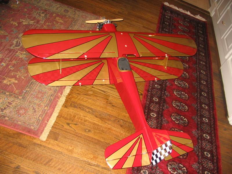

 Sig Hog-Bipe kit. >
Sig Hog-Bipe kit.
Sig Hog-Bipe kit.
