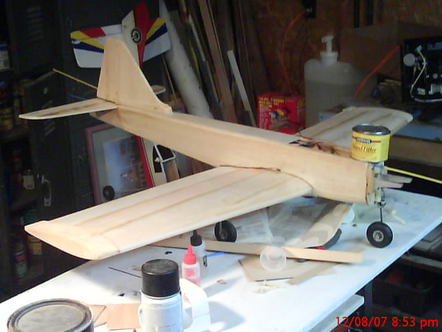

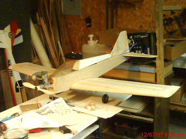

a few more pics tonight i used a little wood putty to shape the wings to make i nice fit between the wings and the front piece not all i need is a motor any ones that are cheaper and people like size and brand and i can already see were this would be going no electric!!!!!!!!! nitro only. i also got all my servos and stuff in the only think im having troubble with is the steerable gear but a little sanding and a pilot and a little momkote it will be air borne

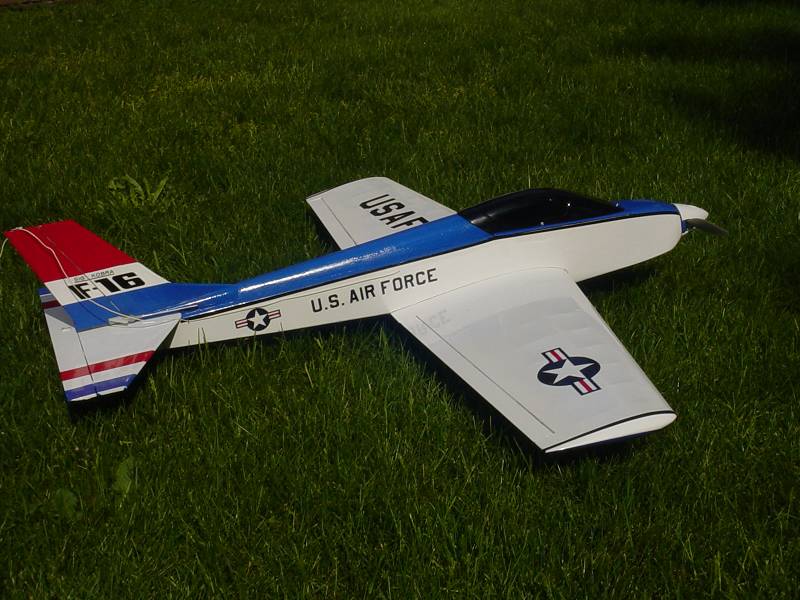

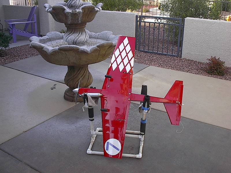

Gray Beard, what plane is that? The tail looks more like the Kavalier, except the Kavalier is a high wing, And the Kougar has a foam core wing instead of built up like that one.

Sorry, my fault, I have so many planes going on at one time I had A minor brain fart. That is the SIG .25 size Kobra I built for A friend for racing, not the Kougar. I finished it two weeks ago and it has been hanging up waiting to be shipped out to him after the Xmas rush. You can build this little plane with a number of changes to look different and he wanted this tail type.

So the Kobra still has a built up wing. The king Kobra used to, back in the early 90's, and as far as I know the Kougar has always had foam cores.
Nice job. The only problem I see is that the garden needs more clutter.
